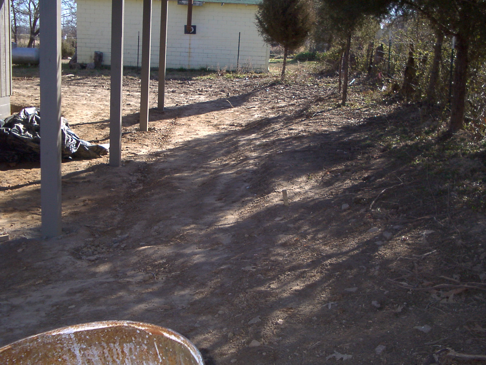

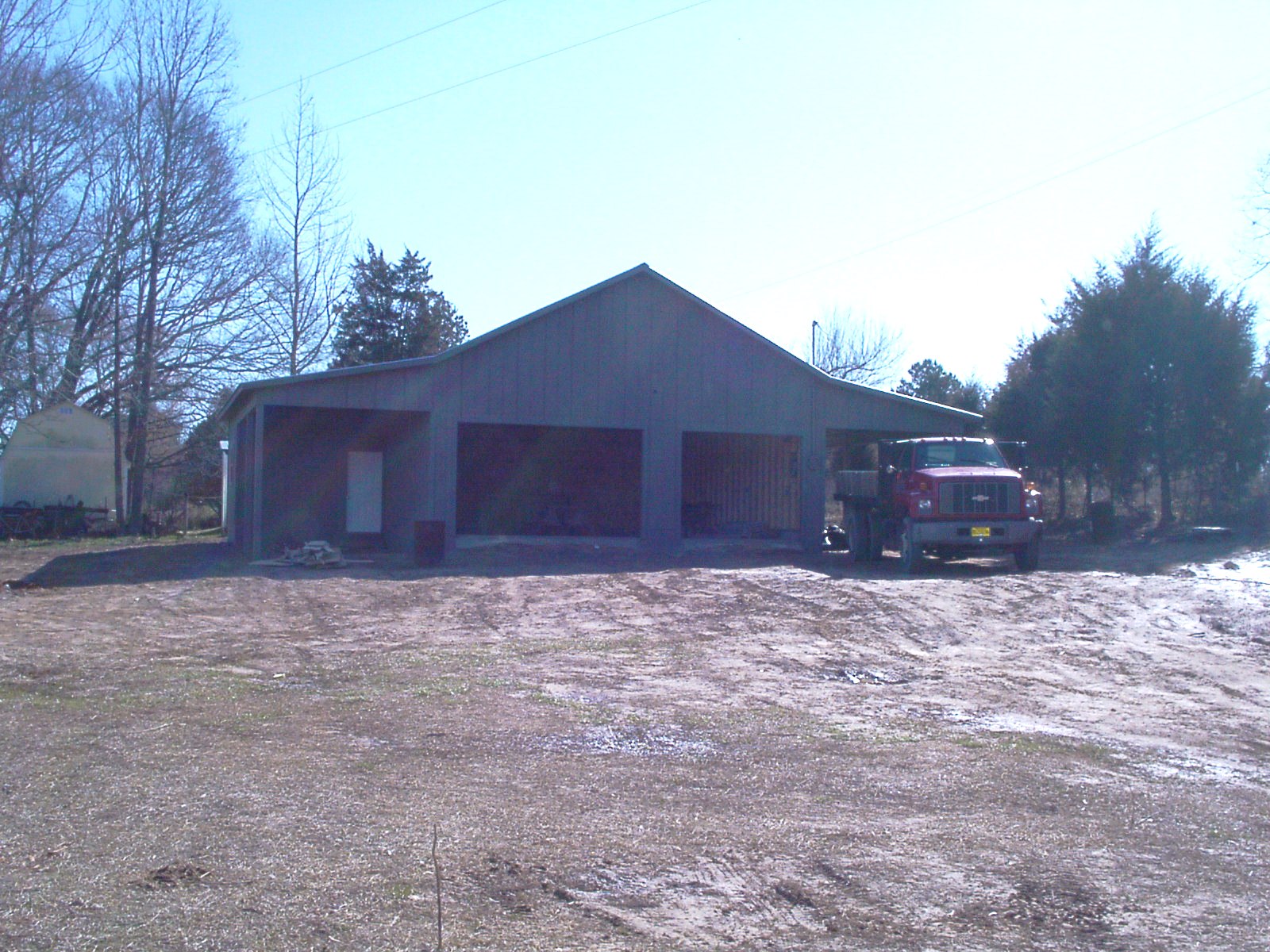

For efficient dirt movement and digging, I used my FEL to move the loose stuff after I used the scarifiers on the box blade to loosen it up. My soil has a lot of rocks and is hard clay so the FEL doesnt do well by itself. I levelled this hill in one day taking about 2 feet off the top and moving the dirt down the hill to flatten the area to build my shop. I would scarify / drag it with BB, carry it with the FEL and back drag to keep it level. Brother in law used his little JD 750 with a back blade to continuously circle and pack down the fresh dirt. The shop is 52 X 30 and I went about 70 feet to the front to control the slope
