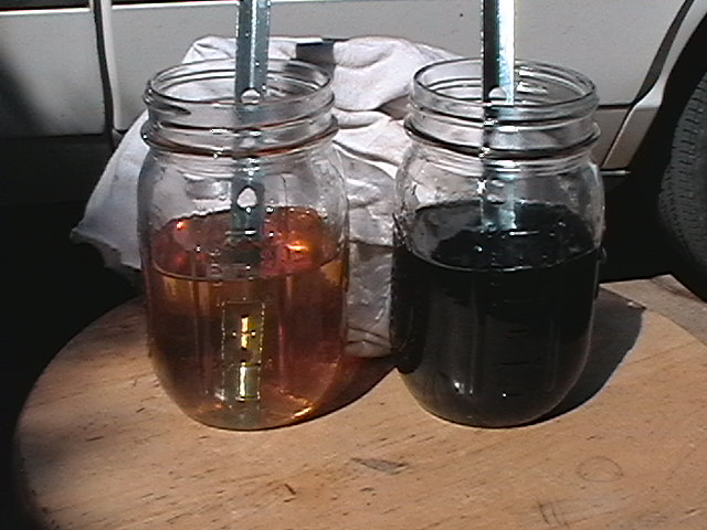

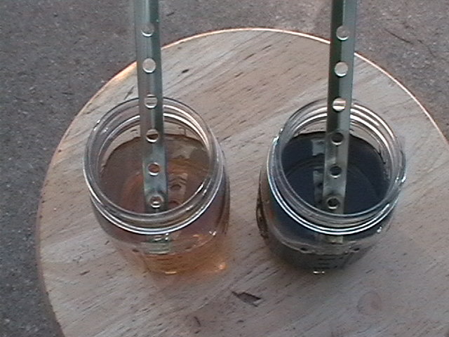

Just thought I'd share. After warming up the tractor and then changing the oil, I ran it for about 5 minutes and then came back in about 30 minutes to check the oil level. It was showing a tad high on the stick, maybe a 1/4 of an inch over the full hole. Not a lot. Of course being new oil it wasn't as easy to read so I thought I'd check again in the morning. After checking the next morning the level was showing the same. I could have left it be but I thought I'd just drain about a pint into a glass jar. That's the jar on the right!:(

Looks like it has solubilized the soot quite well.

That don't seem right,mine takes many hours to get that dark at dipstick,,[course you got yours from bottom],,what kinda oil,did you drain it real good,and change filter?

Its a deisel, some are dirtier than others but i would say that i would not worry, mine did not get that dirty even after 10 hours of near idle and light work at higher rpms but i may not have the hours you do etc? Deisel will get dirty fast
Motorcraft 15w40. Yes and yes.
That's what I was thinking. Man this oil cleans up my engine quick.;)

If it had been an older 2 stroke Detroit diesel, it would have been jet black in 2 minutes of running. The oil in the crank passageways, and in a few other small spots that do not drain out will easily discolor new oil.
That's why I posted the second pic. The oil on the dipstick does not look that dark. I know when I change the oil annually, that dipstick oil is black.
