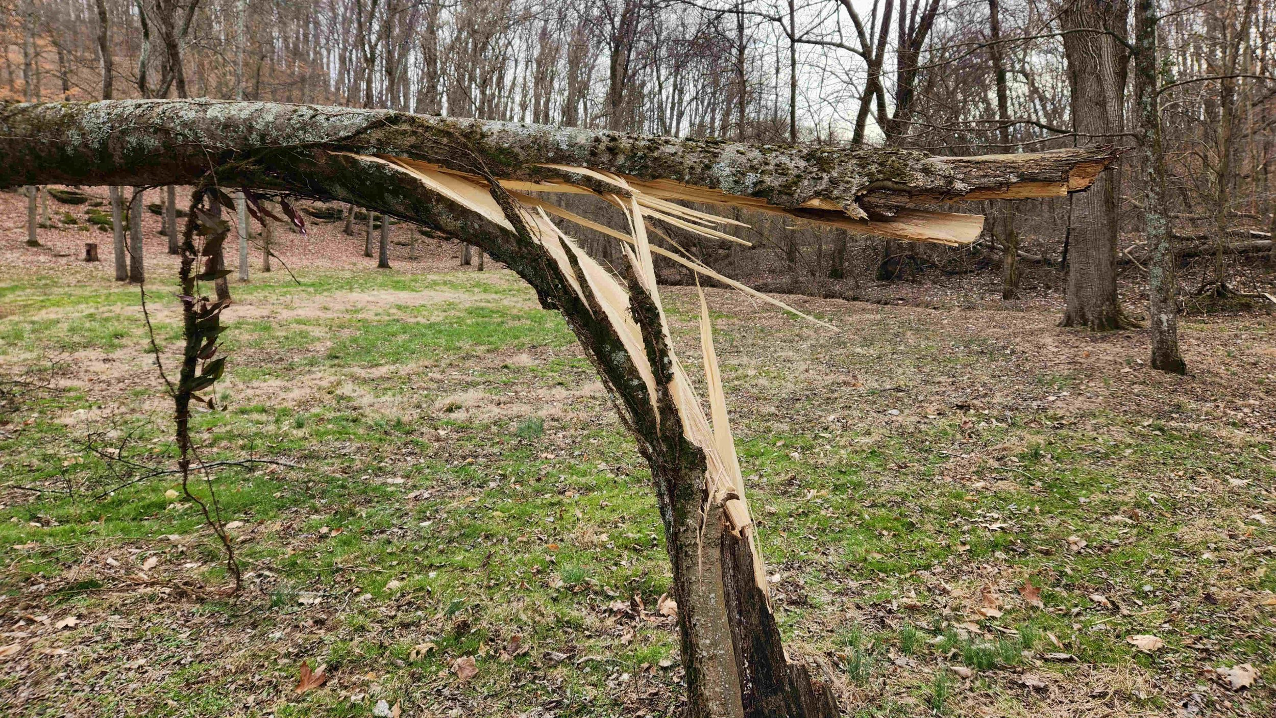

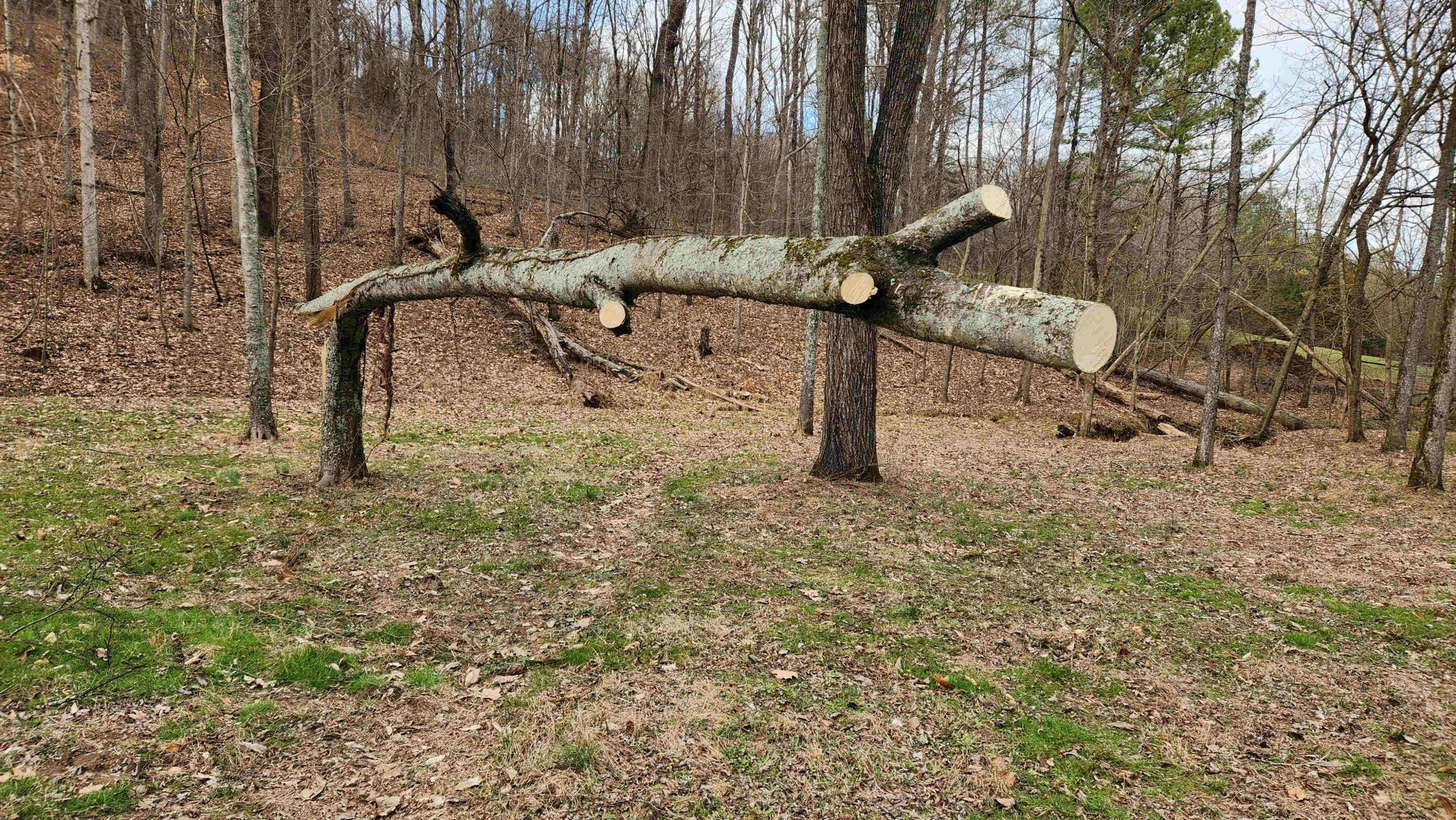

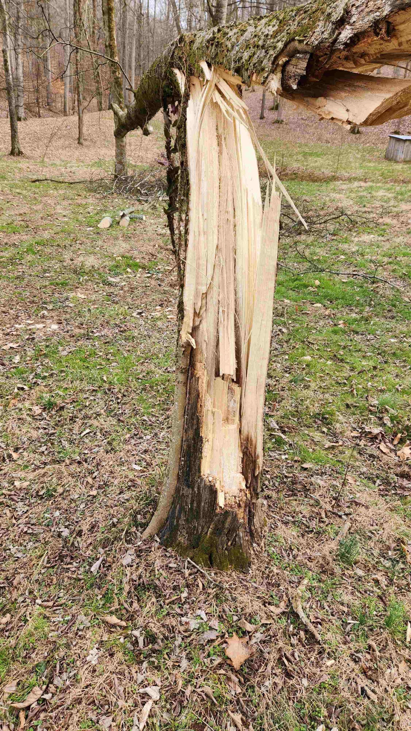

This living ash tree fell over and made a nice barber chair in the last storm.
The more that I cut on it now, the more it wants to "stand up" and is making me very nervous.
It may not look like it, but the horizontal part of the tree is about 8 foot off the ground. Any more cutting on it will require me to stand on something.
I'm not happy with any option I can think of.
Any ideas??

Do you have access to a loader or some type of lift that would support the weight while you cut the trunk to reduce additional barberchair effect from over hanging load.

I assume you mean to lift up on that split part? No, my Ventrac can only lift a couple of feet.
I suppose I could put a 2x4 under that "tongue" to keep it from raising more as I nibble off the trunk. Interesting thought.

Mountainbuck,
Cut as most people would by notching close to the ground, at point below the barber poling, at point ninety degrees from point tree is currently leaning. Back cut and tree will fall over on its side.

Like Fuddy said, a pole saw would allow you to be at a (relatively) safe distance. Careful!
   / How should I fell the remainder of this tree? #7
You probably have a pole saw. It's going to want to keep splintering but a pole saw standing off to the side start cutting at arrow. You'll be safe like that, and it won't take long.View attachment 783506
I would first cut the piece that the arrow is on, then cut where the arrow is pointing.
Yep. Easy cut. No question about which direction it will want to fall. Forget the break above. Just fall the tree.
