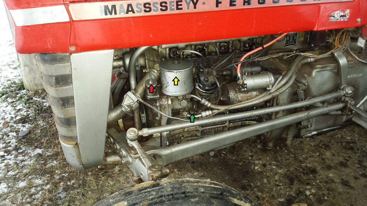

Here's the first pic, of the left side of the engine.
In this photo, the parts I was able to recognize from the manual are the red arrow (for filling the crankcase with oil) and the green arrow (the dipstick to check the oil level). However, the picture in the manual shows the oil filter off to the right of the dipstick, and as you can see there is nothing there. I thought that maybe the canister that the yellow arrow points to was the filter, but when I removed the bolt on the top the fluid was RED, and I couldn't get the top off, even though it looks like a lid and should be able to come off to me. Since it didn't look like oil, I stopped here and decided to take these pictures and ask people around here for some guidance.

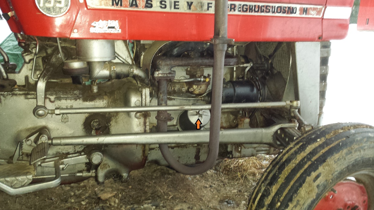

The next picture is of the right side of the engine.
Looking all over the engine the only thing I could see that might be the oil filter housing is in this picture, with the orange arrow. Am I correct in this assumption? If so, WHAT is that other housing on the other side of the engine with the red fluid in it when I removed that bolt from the top?

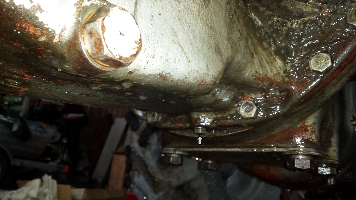

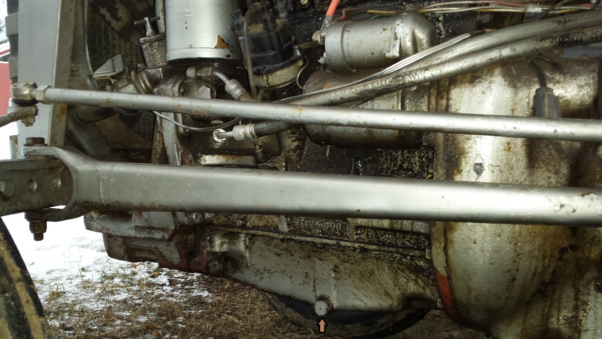

At this point I also realized that I wasn't exactly sure how to drain the crankcase. There are 2 possible candidates. One is a very large bolt on the left-bottom side of the crankcase, as seen in this picture:
The other candidate is in a more traditional location for a drain (i.e. right in the middle on the bottom) but it seems to me to be in a bit of a funny place, quite far back and VERY close to a major joint of the engine, as seen in this picture:
Any help on this stuff would be much appreciated!

Hey D. first of all there there two different gas engines used on the F. 135. You have the Continental Z145 engine (assuming you have a tach and hour meter guage...) Yes, the right side of the engine with the orange arrow in it is the oil filter. The oil drain is the pretty good sized bolt head on the left side of the engine at the bottom of the crankcase. You fill the crankcase from the left side at the front of the engine. the fill hole is the unit that has the "T" on top of it in front of the power steering resevoir (yeah, that's what that thing is that has the red fluid in it). Your dipstick is just below the power steering hose (hope you've been checking it regularly). Get the right op manual and a service manual and you'll be OK. The crankcase takes 5 quarts and yes, change the filter...you can get it at the local AGCO dealer. Do you know the year of your tractor...by looking at the air filter, I'd say its a pre-1967.. that year they changed the orientation of the air filter. get us the serial # of the tractor and we can help some more. Good luck BobG in VA

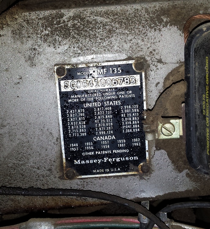

Here's a pic of the serial for my tractor:
Hopefully I can track down a service manual for my particular make/model, because I'd like to check and make sure ALL fluids and everything are good to go on the old girl.

Get the factory manuals (parts and service) from AGCO.
https://www.agcopubs.com/
My MF135 was a 1964 diesel deluxe model with multipower. Sold it late last year after 9 years of ownership.
