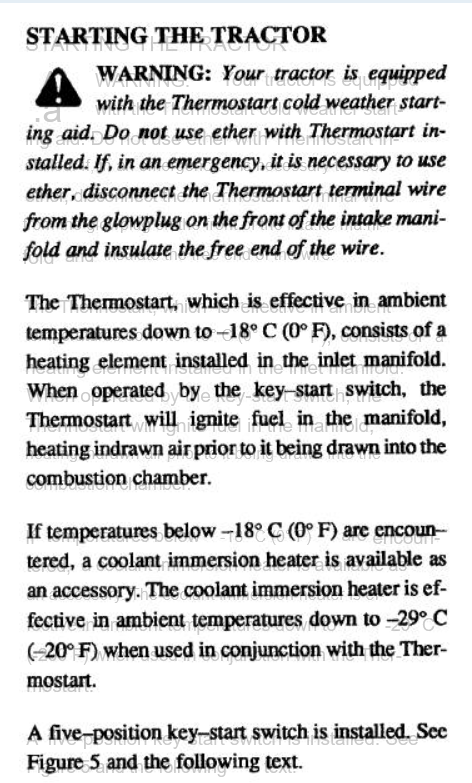

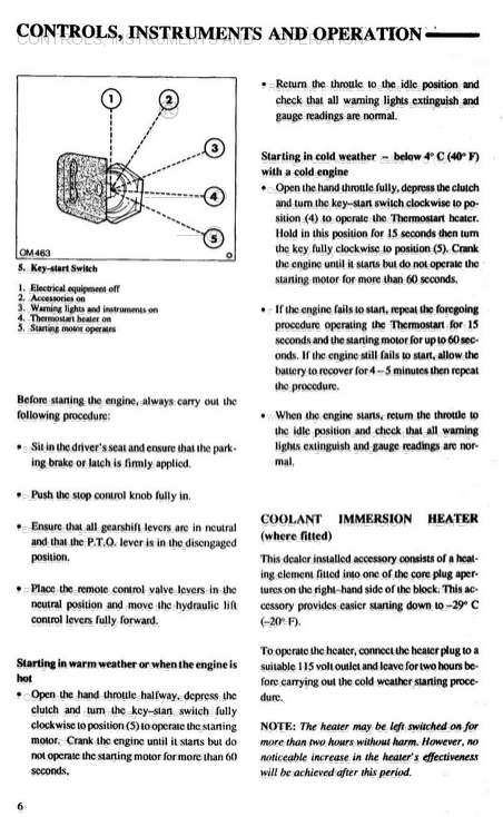

If this is what you have, it has no glow plugs or glow plug lights. Misinformation there. It MAY have a thermostart, as many Ford's were so equipped. If it has that feature, there will (or there was if someone installed an incorrect switch) be two positions on the key switch to the right of the "on" position. Both are spring loaded. first is heat, second is start. That's typical of most Ford tractors of that vintage. The engines usually start fine without the heater, but it does help in colder weather. If it has a thermostart it will be in the intake manifold near the air cleaner hose. Open the hood, swing out the battery and feel around on the manifold on the engine side and see what you find. It may have the heater or a plug threaded into the port.

Well, there you go. All the information on actuating the thermostart... but nothing about where it is or how it works.
Sometimes a thermostart will have it's own small tea-cup sized reservoir full of diesel fuel. That reservoir is filled either by a tap off the return line from injectors to fuel tank, or by manually filling it. In use, a few drops of diesel fuel is gravity fed from the reservoir down to the thermostart igniter.
