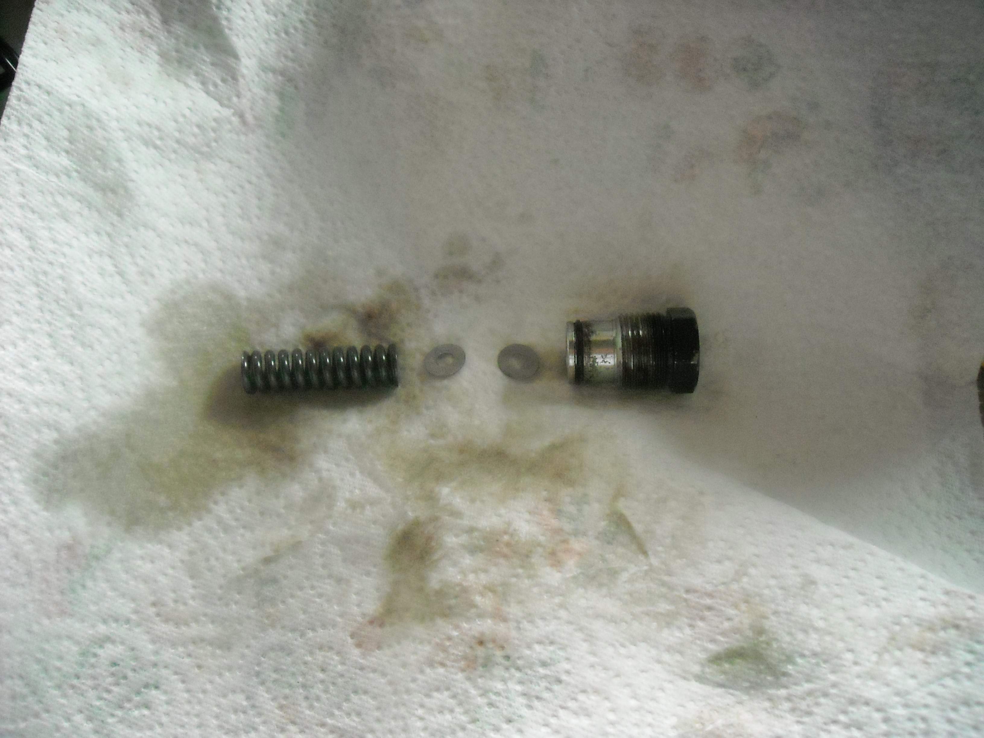

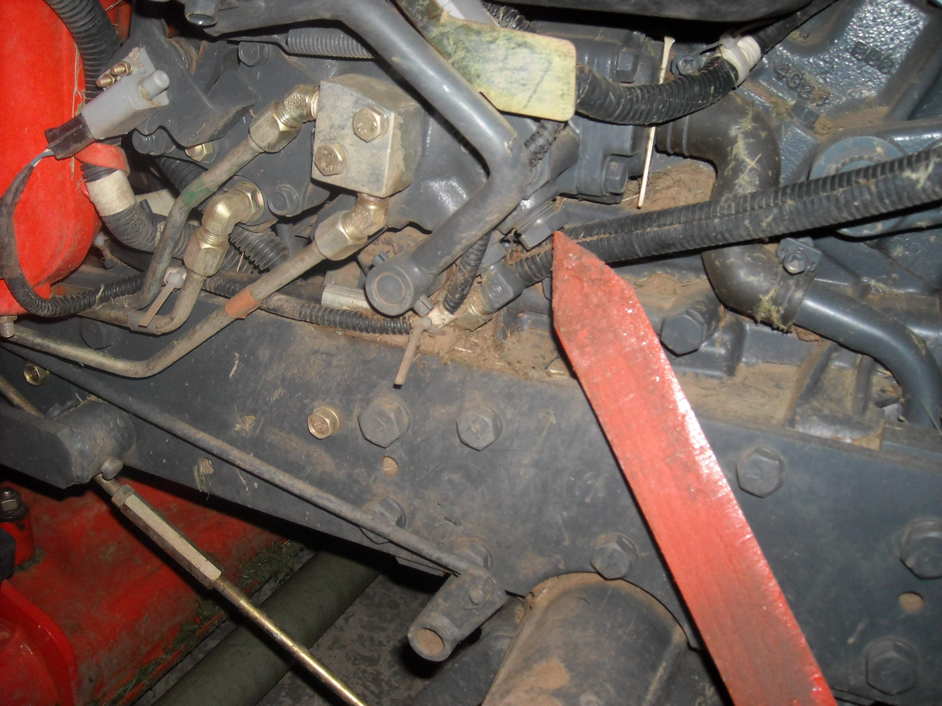

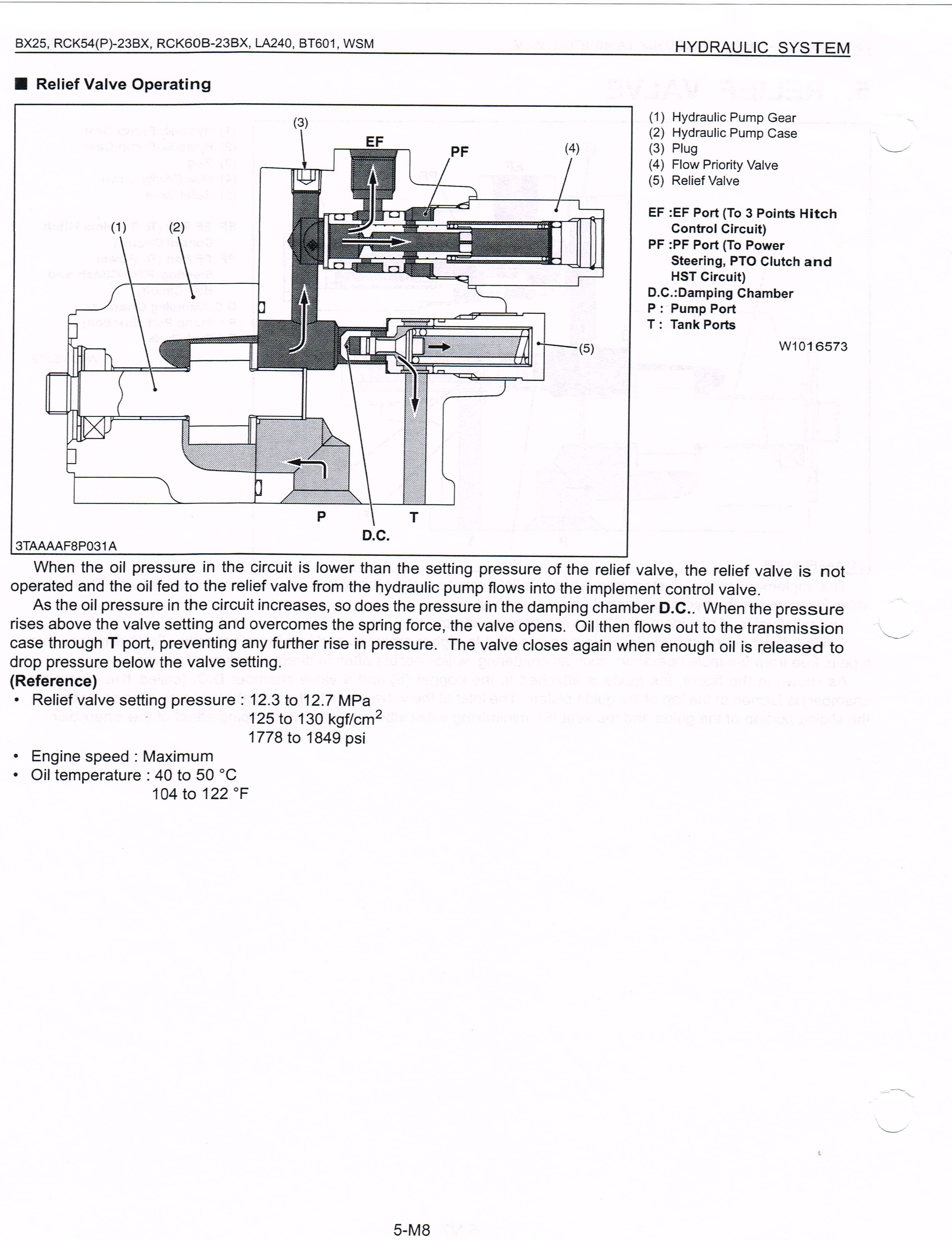

It seems there are some differences between models when increasing hydraulic relief valve pressure. Here is the information from the BX 1830 / BX 2230 Workshop manual for increasing hydraulic pressure. I used my pictures because the WSM pictures are not very clear.
Factory spec. for hydraulic relief valve activation is from 1778-1849 psi
Shims are available in three thicknesses: .1mm (.0039 inch)
.2mm (.0079 inch)
.4mm (.0157 inch)
pressure is increased approx. 39psi whenever the thickness of the adjusting shim is increased by .1mm.
I added two .2mm shims, and re-torqued the relief valve plug to the factory spec of 28-45ft-lbs.

Same specs in BX24 WSM...

Update on hydraulic pressure adjustment: I have used my Bx2230 for a while now since adding two .2 mm shims to the hydraulic relief valve. Loader does a better job lifting out of a pile of dirt. That was my only complaint with the factory setting- the loader was a little slow coming out of a material pile. Now the loader operates as it should. The loader will raise the front of the tractor easily. Before the adjustment, I had to drive the tractor forward while lowering the bucket in order to lift the tractors front wheels.
Mower, rear implements, and speed control pedal all work normally.
Best of luck!
