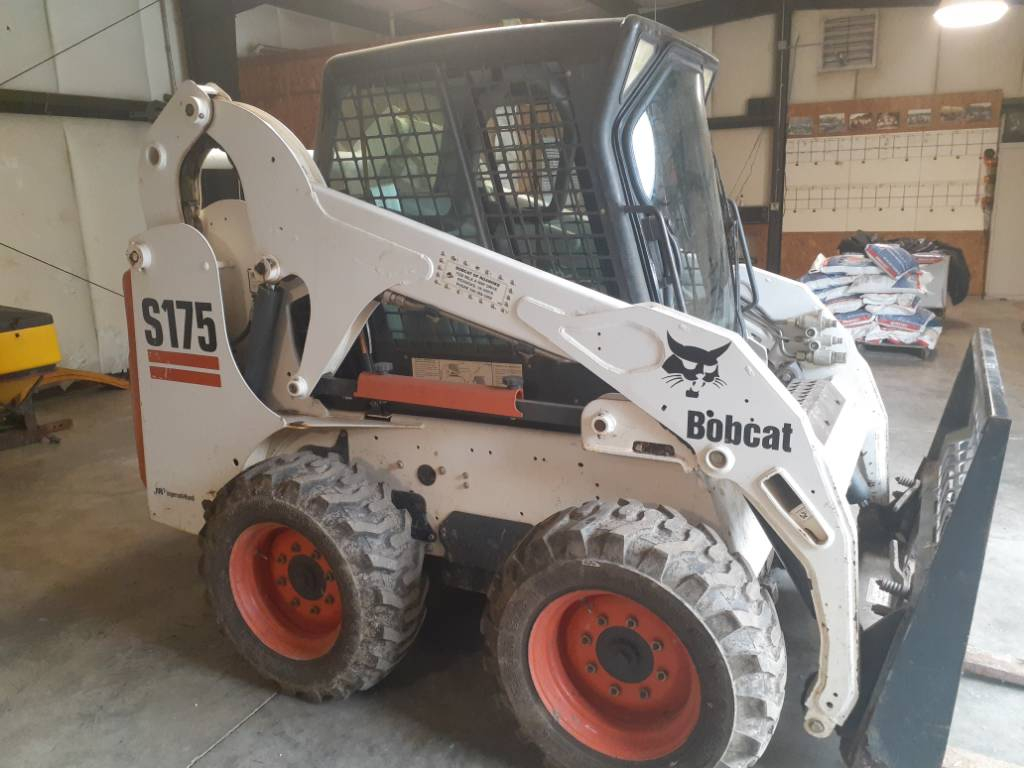

A skid steer does things either a tractor won't and/or it's more compact. I looked at this one for sale...what do you think?
The owner bought it new 2005, 756 hours on it. Front hydraulics. Everything works perfectly. He said they never washed it and I believe it. Garage kept. It was serviced at 500 hours but needs service again. The Kubota engine is dusty but no leaks anywhere of any fluids. Started great, no smoke. (46 hp) Pre-emissions. Hydraulic cylinders are clean, no pitting, leaks. It has a 6ft bucket. New (but dirty) tires. Nice cab/wiper/heat air
I don't have a trailer to tow it. I think I'd say if he would take it 3 miles to dealer for service (I'll pay for that), then 40 miles to me (owner lives not far past me) then I'd pay $25,000.
Does that sound fair & good price?
I just got 18T sand, horse paddock to maintain, 18T screened topsoil lawn & garden, areas to level. Friend/neighbor has one I can borrow attachments.
Thanks.

That is a nice looking machine. Low hours. One owner. All good points.
I have an older 773. Your model has improved visibility with lower lift arms but I would put a couple of backup cameras on it right away to make it livable.

We have one just like it. You can save money and do that service yourself. Be careful raising the back to get to radiator. Look at how the hydraulic cooler sets in there. Very good machine. You'll like it. Grease the tension pulley on the belt drive. Drive chains on each side run in oil.
