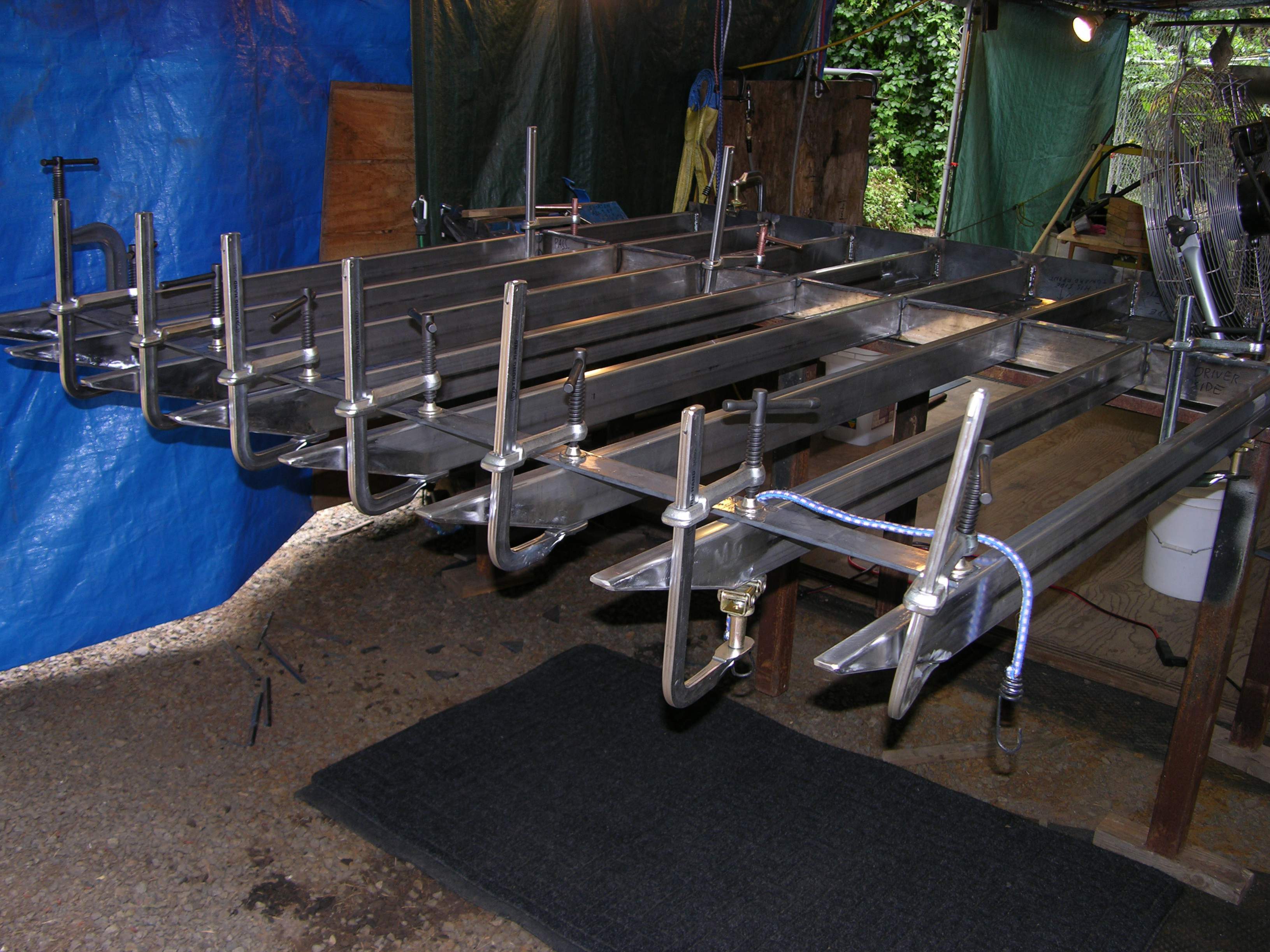

Anyway, I'm planning on a few different hookups for my Samurai, one would be two 10 foot long 2" square tube sections, each with its own cylinder that would give nearly 180 deg. swing - object being to be able to drive down ONE side of a hedge, first pass cuts near side, second pass cuts top, third pass cuts the FAR side (no room to drive back there)

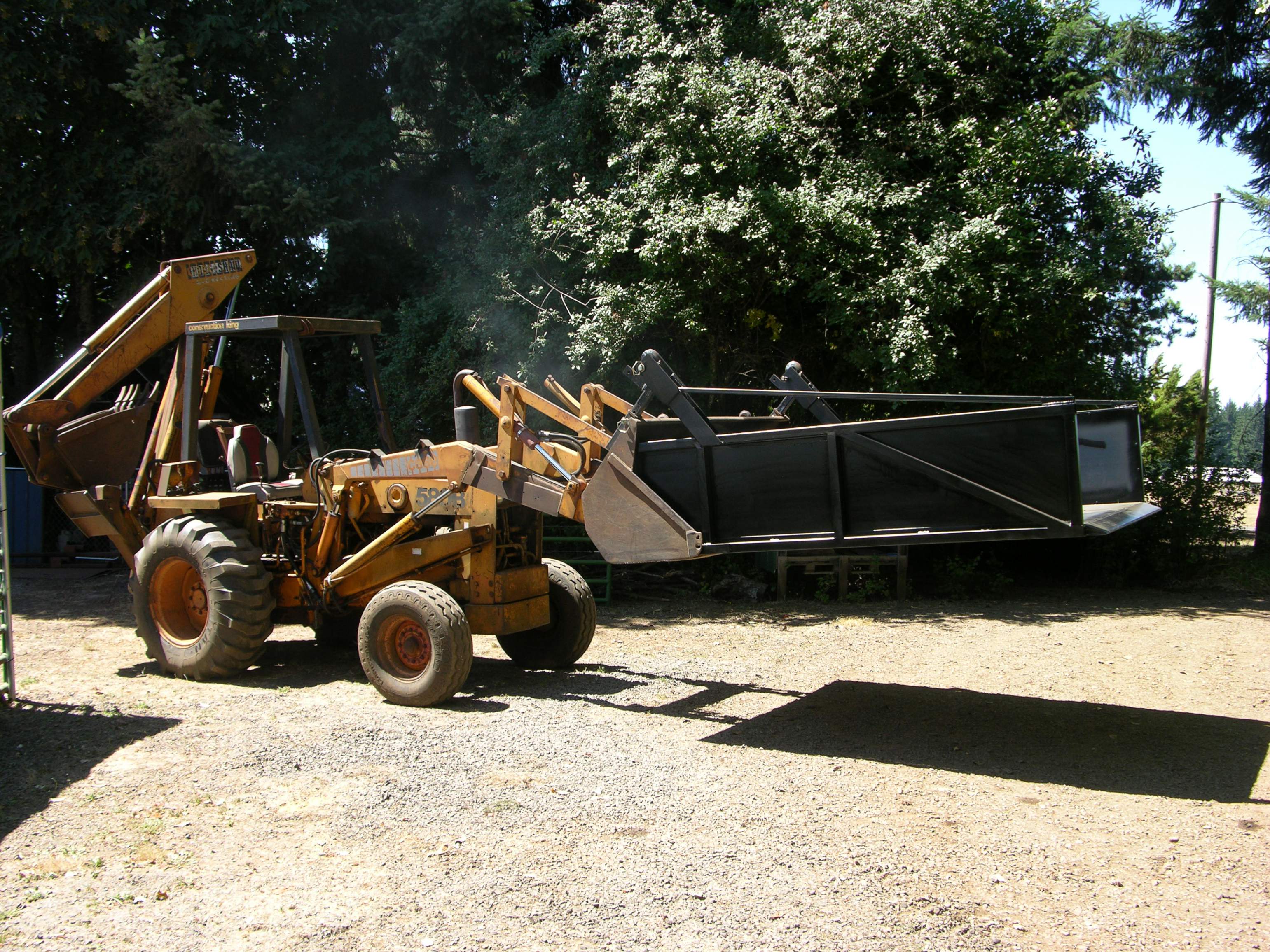

First pass would be cut and (hopefully) as it's cut, fall into the brush bucket I built for the BH

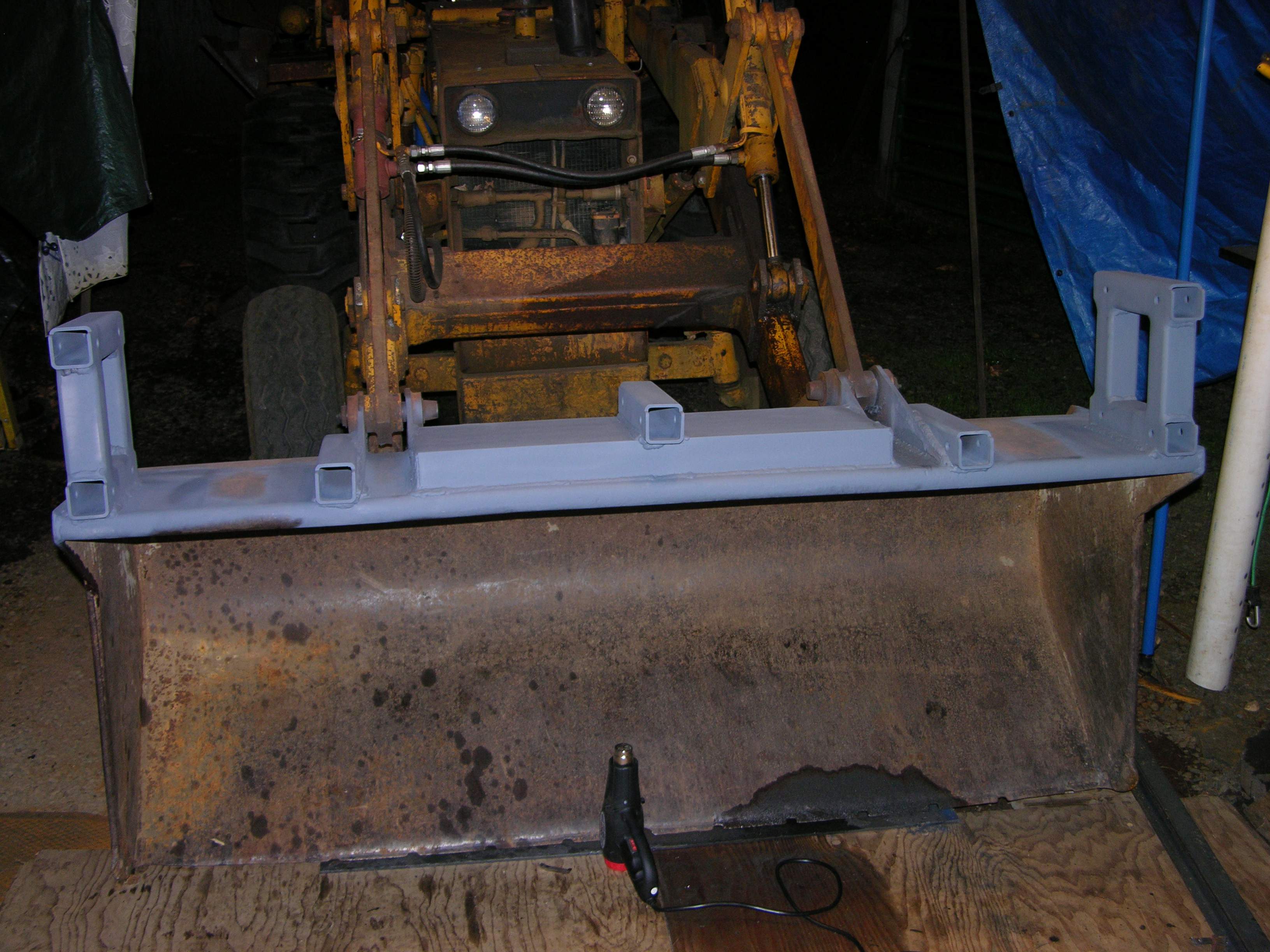

Since that pic was taken, I've "upgraded" the attachment points on the loader bucket
And finally realized that several of the attachments I either WILL or HAVE made suffer from my lack of "X-ray vision) - so I'm now working on a QA system for brush bucket, brush forks, grapple, hydraulic driven 6' flail, Samurai, pallet forks, hot tub (kidding about the hot tub :laughing: - So anyway, I'm in the middle of a herky version of this
http://www.tractorbynet.com/forums/...verboard-quick.html?highlight=QA+quick+attach
Back to the Samurai - one of its several positions will be at the leading edge of that brush bucket with the teeth pointed UP - come in low, raise the bucket and stuff falls in - bounce the bucket a few times to shift the pile away from the cutter, when that doesn't work anymore drive to the burn pile and dump - repeat as necessary. Top of hedge cuttings will get "combed" out with the forks - shown here in process, they're actually done
but I'll need to change the mounts once I get the loader converted to QA.

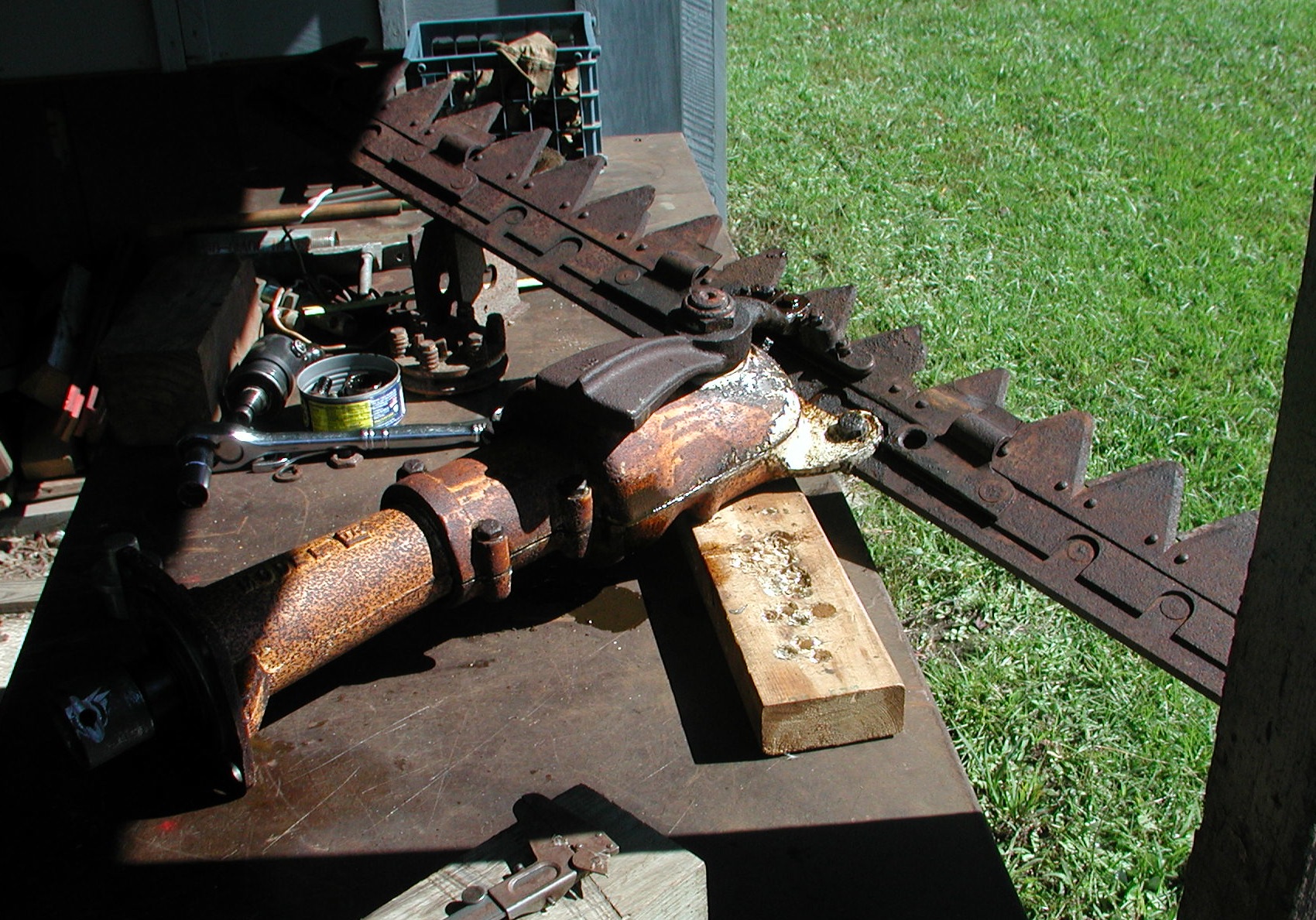

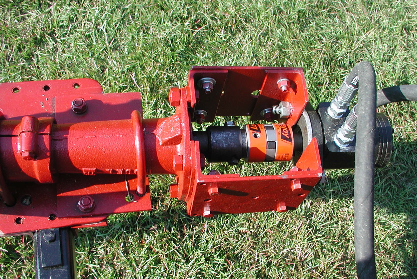

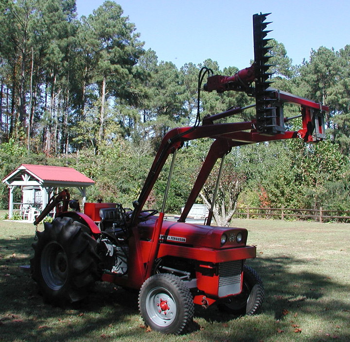

Here is my two cents. The Samurai is a good idea for 1/2 in. or smaller twigs, anything bigger would probably damage the knives. After looking at the Samurai, I built one by using a 4 ft Walk-behind Gravely sickle bar. It uses basically the same hydraulic HP. The Samurai is a nice little machine but little bit overpriced for my once or twice yearly use. Also, it will not cut stuff bigger than 1/2 in.
I am planning to make another attachment, with the same concept, using either a small lawnmower deck or a standard saw blade. I do know yet, I am still playing with the idea.
Here are pics of my attachment, the only difference is that now I install the bar to the bucket. It is a simpler move without dismounting the bucket.
That's inaccurate info on the Samurai. It cuts up to 1 1/2" NOT to 1/2". See the details on their website,Cutthat.com | Sabre Samurai
