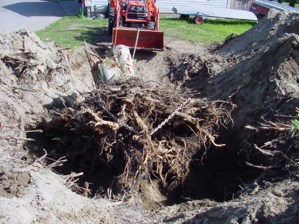

Just added a BH-90 Backhoe to the L3130 Kubota, and am ready to start attacking various rocks and stumps as I expand my yard into the neighboring woods in all directions.
I've been reading some horror stories here in the forums from those who have dared to remove stumps, especially maple stumps from their property..
My question.. Is there any advice on how to remove stumps. I've never done it with a backhoe so I'd love to hear any tips or techniques for making the job easier. I've been told to just dig all around the stump and there you go.. others say dig as far out as you can to clip the roots away from trunk as far as possible.
I would like to minimize time and effort, but maximize results.. I know that's not an easy formula for success.
Thanks for any help.

I would think that digging radially from the trunk out would be the way to do it. That's the way you'd do it if you were digging by hand. You might have to cut the roots manually regardless of the method of digging.

Well you more or less answered your own question. However my way to get stumps out is to first remove dirt down to roots about 3' away from stump. Then start breaking through roots working around stump. I then dig down a bit at the edge of the roots nearest me. I then dig down around the rest of the stump, pulling the stump to me a bit at a time. As you pull to you, you'll be able to get under the stump more. With some additional root breaking and pulling, the stump comes out. Of course there are always unknown variables to deal with that will make your job more difficult, like a giant tap root or a large rock or gravel. Hope this helps

I have had a lot of stumps removed and the operator always looked for the side of the stump that had the least amount of roots and dug down at that side first and cleared a hole. Then he worked both sides and dug them out. Lastly, he went to the back side and broke the roots from there. Then he would pull the stump into the hole in front. It seemed very easy for him, but then he was using a large excavator and it took about 10 - 15 per stump..... these were all 50 - 75 year old hemlock and pine trees. The biggest problem with stumps is disposing of them after you get them out...

I have pulled some pretty large stumps with my little B7500.... (motivated by the "You spent $xx,xxx dollars on that tractor and now you have to hire a bulldozer) ....Very similar to your situation. My technique involves digging all the way around the stump and breaking all the surface roots, usually down about 3-4 ft. Then I dig a ramp down one side and get under it with the loader to remove as much dirt as possible. Then I could pull it over with a chain and drag it up the ramp. It will probably be a lot easier for you with your machine. I had bigger stumps but easier working soil. I'll attach a couple of photos. The photo attached to this shows a stump that being drug up a ramp.
