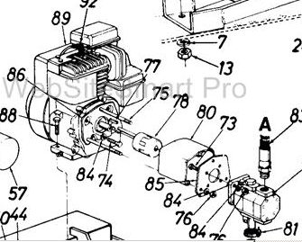

It was just as supplied new. A three piece mount that lookes like this- a plate bolted to the engine, one to the pump, and stiffness provided by a "c"-shaped thin aluminum casting that doubles as a guard.

As I am looking at the parts breakdown, You said the set screw was backed out on one part. I am thinking one half of the metal coupler vibrated back to the engine, and after to much slack evolved, it just quit/jammed. Did you salvage any of the parts? JMHO.
Use locktite on the set screws, might help.
   / Interesting Two-stage log splitter pump failure
The set scews were both tight. But the key on the pump shaft had rotated out of the keyway, with rust indicating it had been that way for a long time.
Upon inspection of the engine side, the coupling was positioned with only a small portion of the shaft in the bore, but it is not loose. Looks clearly like a case of sloppy assembly.
I picked up two new coupling halves yesterday and will reassemble the new pump using a new coupling.
