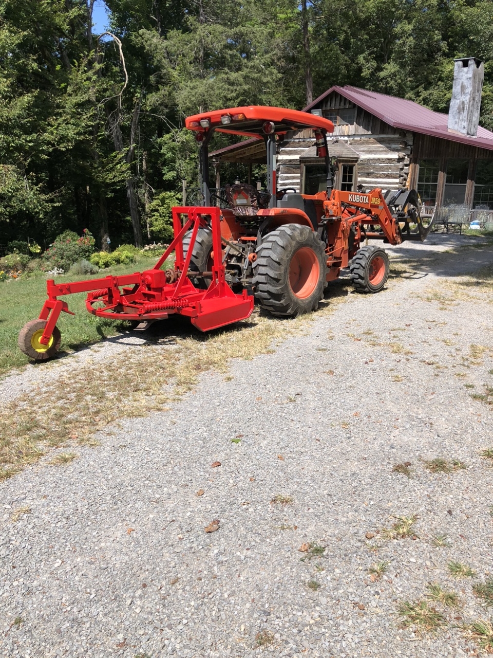

3 years without mowing will have 3-4” trees. That’s rough on any cutter. Some like walnut and hickory are partially tough. Been reclaiming wooded edges and trails with a brown tree cutter. New to me, the 25 year cutter has been a surprise to me how well it handles the woody stuff. Did the yearly mow off of the now fallow pastures did okay. Not the width of a rotary cutter.
Deer and turkeys love it.
