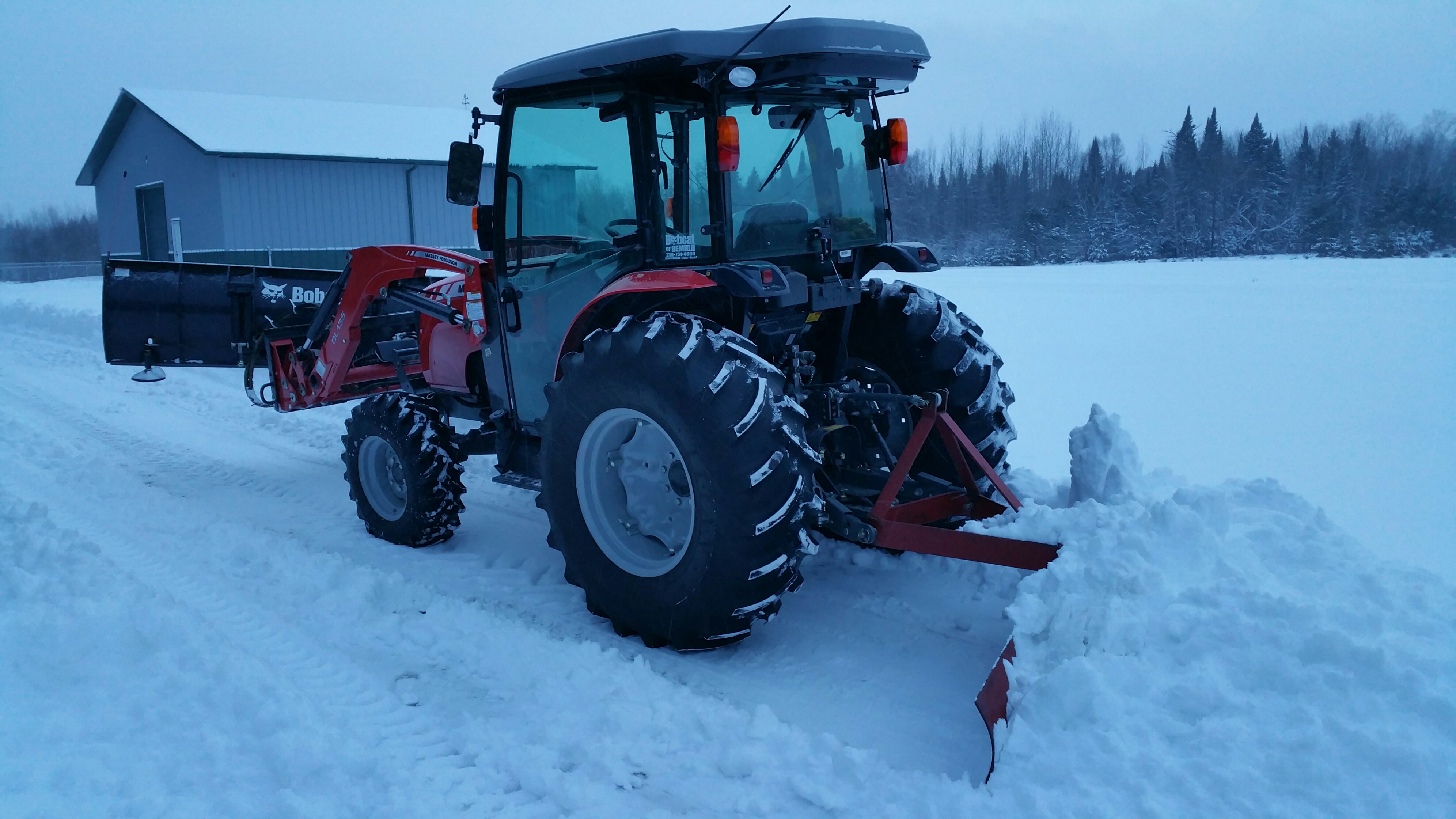

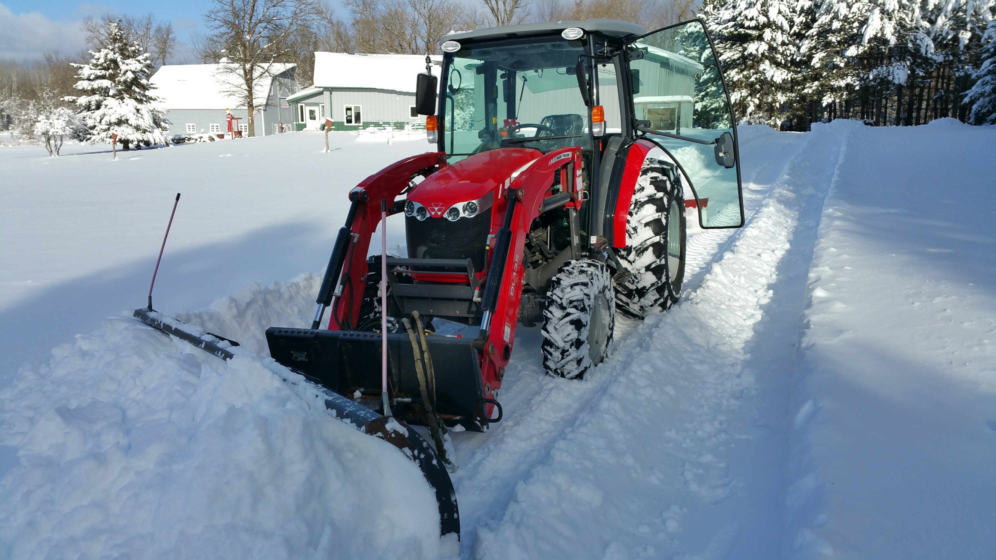

I use my 1758 almost daily. As with much of my equipment whether it's a handgun, chainsaw, or tractor; it needs to go bang every time I use it. Anything can break, but where I live being REMOTE, it's crucial things are reliable. I checked tractor house and looked at some of the pricing on the 6060. They appear to be competitively priced. My Kubota dealer here is pathetic and they seem to focus on Dewalt instead of machinery. They are so bad that I drove 450 miles to Mcfarlanes in WI for a Kubota RTV instead of driving 50. I went with the dealership I could trust and count on so picked my color of tractor based on that relationship first. I have owned many tractors, 4 of those being purchased new. All between 45-60 horse. I saved about $5500 going with the Massey instead of going with a similar orange or green model with HST, premium features, and third function on loader for snow blade. The 1758 has been a dream tractor up to this point and I am not sure I could even make a list to improve upon it. The fit for me is what I was hoping for on 240 acres. Good luck shopping
