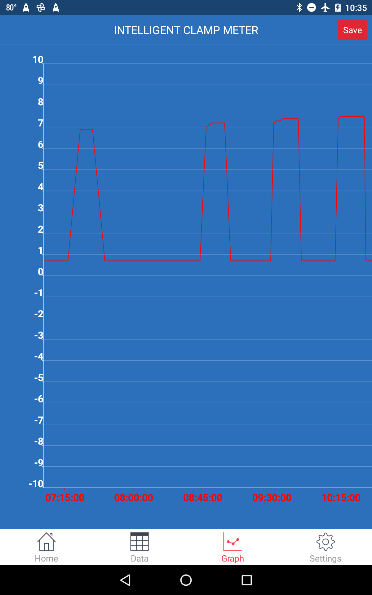

Wondering if my house AC is cycling too often? (short cycling) The attached photo is a screenshot off my tablet which is running an app called "Intelligent Clamp Meter". The app connects via bluetooth with an amp probe attached at the house breaker panel.
The left column is amps and the timeline across the bottom showing a start of about 7:15 AM. The AC is a Lennox two stage which runs about nine or ten amps on Hi cool and about six or seven on Lo cool.
We've been having days in the 90F high temp and the AC doesn't normally get into Hi cool until the afternoon.
The stage one and stage two differential is set to 2.0 degrees but I never see the temp vary more than one degree from the set temp while the compressor is cycling as shown in the pic.
The five year old Lennox unit is a 36,000 BTU with inverter air handling cooling a 1600 square foot ranch style well insulated
Edit: As you can see, the unit cycled on four times between about 7:00AM thru 10:00AM with an outside temp of 75F to 80F. Thermostat is set to 73F.

It looks like it is cycling just right to me with more off time than on time. I like a unit that keeps the temp within 1 degree and runs for a short amount of time instead of a unit that lets it heat up 2 or 3 degrees and then runs for a long time.

Looks fine. The better thermostats have options to cycle on different temperature gains. Keeping the variation low is usually better. It improves comfort by keeping humidity more consistent. The only time you will get into a short cycle problem is if you have an air supply blowing directly on your thermostat. I would guess yours is properly located.

My concern was that it was wasting energy by having to restart the compressor so often. It is a 16 seer unit so maybe that is not the case. I do appreciate the knowledgeable feedback.

Short cycling is pretty obvious if your outside next to the unit. Inside it will seem like everything is normal with the air handler running.
Outside the unit will start up, run for 30 seconds to a minute, shut down, then immediately start back up.

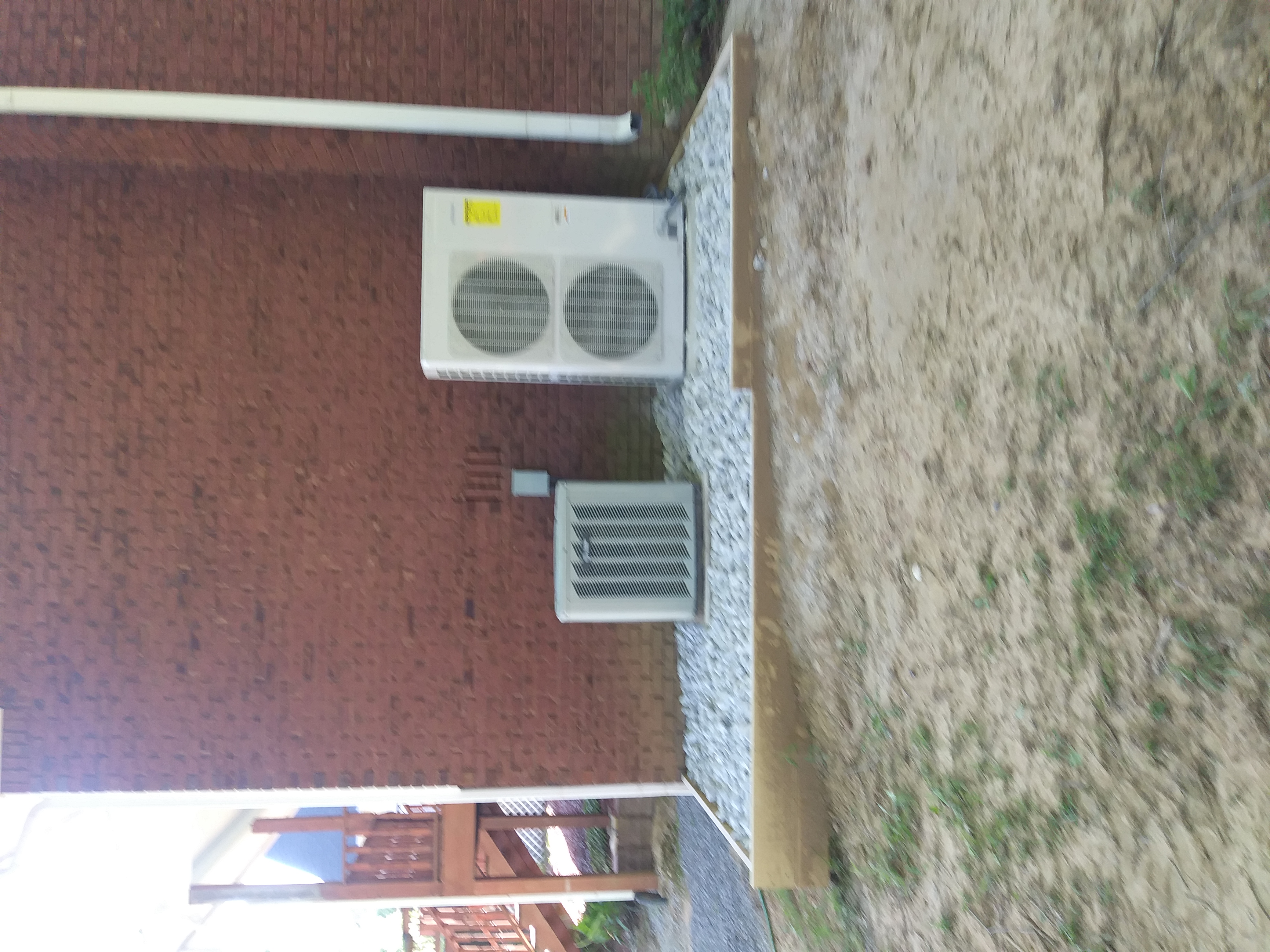

Mine is connected to duct just like a conventional system (one to one)
The smaller unit is for upstairs which we never use the up stairs So, I decided to just keep the Trane until it quits

Get an app that Lennox uses to monitor their equipment. A two stage compressor in the summer, as I read the graph, should not be coming on and turning off within the hour.
That said, I'm an idiot so I may be reading the graph you posted incorrectly. If the app is stating the drop between stages, you would seem fine IMO.
Long story short, if you had the unit for 5 years, go to your electric bill and see how it varies. Could be some other variables at play, but that's where I would start. If it's outrageously high next bill, you have an issue somewhere. If it's the same, the app is haywire.
