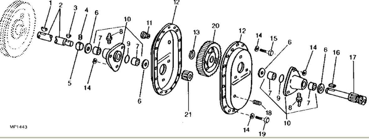

I found a 420 lawn&garden Deere with two drive belts for the PTO, that run off a PTO gearcase (shown here). If so, possibly the gears in the gearcase (hope not) where you should look.
Remove the deck as ICU said, and try to engage the PTO to see if the noise is in that gearcase (if that is what you have).

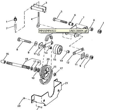

So Miles, you don't think you have that gearcase behind the double belts driving the PTO shaft?
From the parts manual, it is hard to decipher what is on the engine side of these double belts (shown here)
Maybe that gearbox previously shown is just for 540 RPM shaft on the front of the 420 tractor. And this pic of the double belts is a pulley direct off the engine.
With the deck off, what does engaging the PTO sound like? Normal?
Thats the diagram for the idler and PTO. I think I need a breakaway for the pulley on the engine itself.
