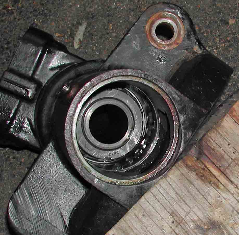

My buddy got a good deal on a 2000ish 4wd 4300 but both front axle seals are leaking. Once the bevel gears are removed, there is a large hole under the end of the axle. inside this access hole is a spanner type nut. This nut has to come out to replace the upper seal, but we cannot find a spanner wrench that fits(have tried about 20 different sizes). There is no way to measure the nut that is up inside the recess. So far, the JD dealerships have not been much help in locating a spanner wrench, or providing the correct size. Does any one here know what size the wrench needs to be?
Our next option is to order a new nut, then build or find a spanner wrench to fit it..............any other suggestions?

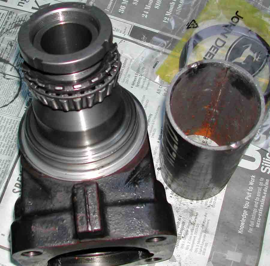

....There is no way to measure the nut that is up inside the recess.
other suggestions?
You may have the axle version I did, Rick. I used a pipe and welded 2 teeth on it to make
the special tool I needed. Once I had that, it went smoothly. These pix are part of a thread
I did a few years ago, but it may be buried in one of the two 4300 rebuild threads.

DF, yep, that's it.......do you happen to know the diameter pipe you used? I can weld up one pretty easy, but getting a measurement inside that hole is almost impossible.
I read your thread, and schedule 40 pipe is mentioned, but not the diameter. We will start hunting pipe and see if we can find one that will work...thanks!
   / JD 4300 4wd front axle seal leak...need spanner wrench size
We found a tool at a dealership in Harlan KY....1.2 hrs away, so we will run up there and get it asap.
