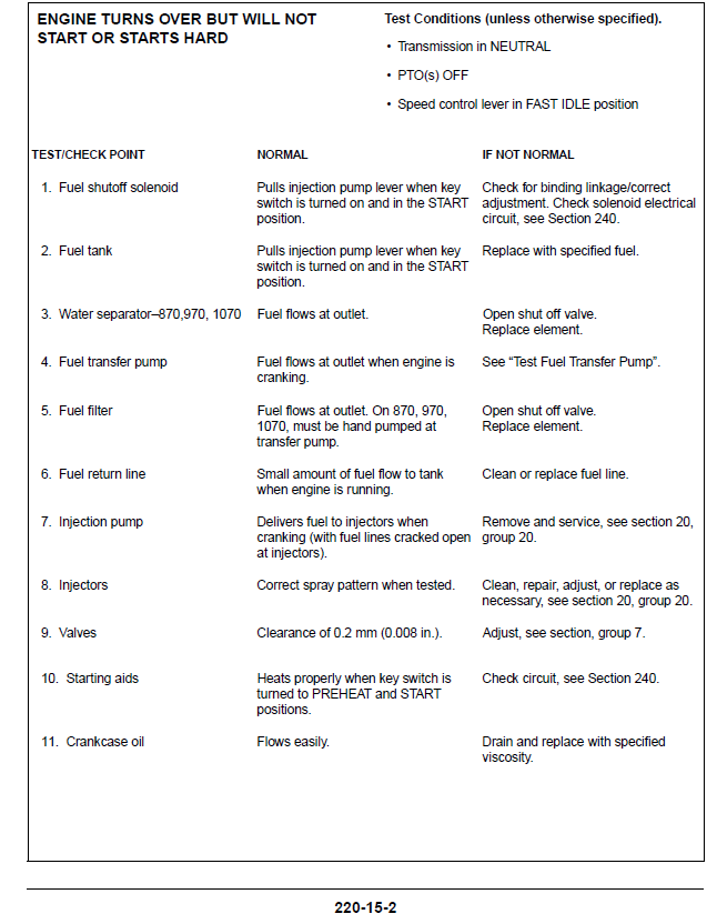

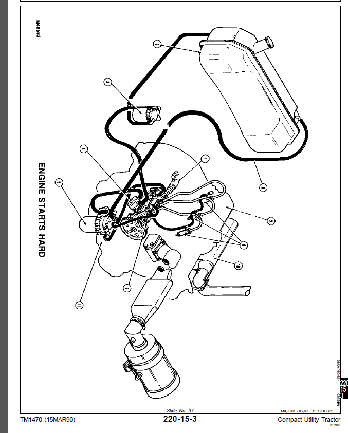

There may be a clutch safety switch as well, Kubota uses one. Disconnect your fuel line as close to the tank as you can. See if you get a steady flow out of the tank. Do you have good flow into the fuel filter? Have you bled the air out of your fuel lines? How's the air cleaner and air path to the intake manifold?
   / John Deere 1070 no crank and suspected fuel supply problem #3

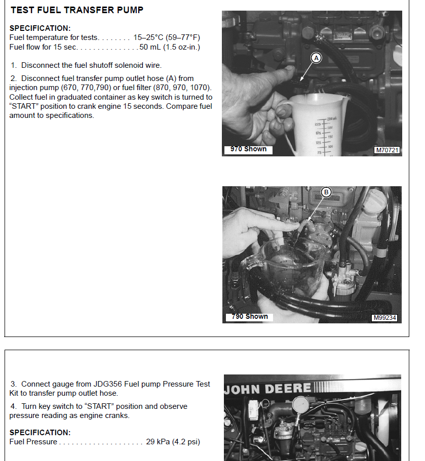

The water and big crud separator at the tank was replaced and the fuel filter by the injection pump? You then used the hand pump on injection pump? I could swear my 870 has a little pump. If everything in working it is supposed to be self purging. I think the repair manual has you crank the engine for 15 seconds to see if the low pressure pump is working.
Have you cracked the injector nozzles to see if anything is dribble/squirting from the output of the injection pump?
