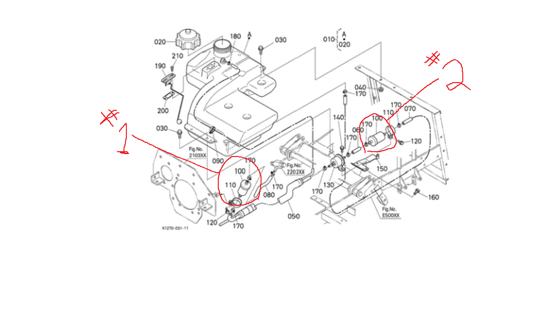

Hi there,
Looking for some ideas really as I'm scratching my head a bit with this problem. The back story is the GR has been fine for since I bought it in 2019, but has developed a problem in the last few months. When mowing our garden (about 1 acre, regular lawn) it's fine for about 20 minutes, but then starts to lose power, so much so that if I keep the mower engaged it will stall. It will restart, and will just about run without the mower engaged, but it runs really rough, misfiring etc. I tend to stop at this point and come back later.
Things I've done to try and resolve:
- Replaced air filter element
- Replaced complete fuel filter (not just the element)
- Checked all fluid levels (coolant/engine oil)
When it's not misbehaving it runs sweet, no smoke other than a little puff on startup, and nothing else to note even when mowing at full power. It's a 2011 model I think but only has approx 380 hours on it.
Any ideas welcomed, I'm quite happy to do work myself but struggling to think where to look next!
Thanks
George

So I had a chance to do some more testing at the weekend. My observations:
- The problem isn't related to overheating - I ran the mower as usual making regular temperature readings at the point where the water pump meets the block, but also on the block itself. Even under load the temp didn't go above 175F
- The mower deck moves freely, I can easily turn the blades by hand. I don't believe the problem is to do with abnormal load from the deck.
- The issue starts the same length of time into work - about 20-30 mins.
- It also doesn't seem to be a tank/vacuum problem - ran the mower with the cap removed and it still did it.
Having said all this, it feels to me very much like fuel starvation - there's no additional smoke, and when it's happening, if I disengage the mower deck, the problem persists for a bit. Since I've changed the fuel filter, and much as I hate to say it, feels like the logical next step is to drain and pull the tank to see if I can get any muck out of there? Maybe blast with an air line?

If I'm looking at the correct Kubota, it looks like your fuel filter is translucent. When this issue occurs are you able to see the fuel level in the filter? If that level is decreasing from when you started it would seem like there is a blockage upstream.
Upon further review it looks like you have 2 fuel filters (item #100), one prior to the pump (#130) and the same one after the pump. Have you replaced both of them?

You could try siphoning some fuel from the bottom of the tank, moving the hose around at the bottom, into a clean container and see what comes out..? I would use a 1/2 inch hose so the opening and flow are great enough to suck out the debris.
