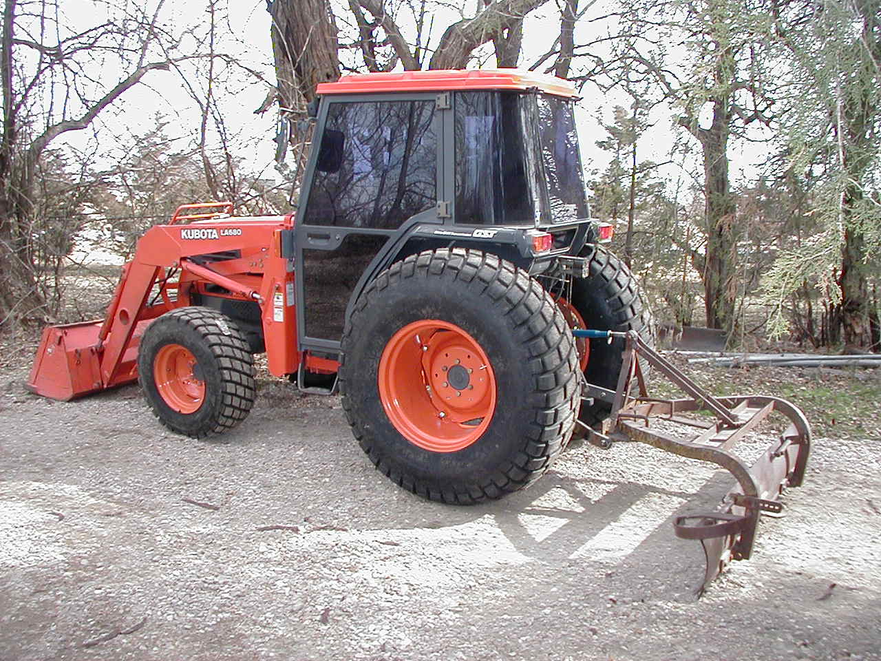

I have an L4200 same AG tires were on it, and I wanted Large turf so I went with: Turf tires (oversized) Titan TORC TRAC (R-3) 16.9x24-6ply & 12x16.5-8ply
Wide Rims to match
Did this in Feb of 2003, These tires are the Best for summer winter everything... I did Not want the small diameter tire & wheel combinations that Kubota had for their turf selection.

Got them all from: Central Ag Wheel & Tire 1721 S. West St. Wichita, Ks 67213 Great folks, they matched everything up...
The Front Rims are, 16.5X9.75 6-6 and the rear are, 15X24 Flat Base Rim, (With this rim I was able to use my existing center disk).
This combination Has a huge footprint and incredible traction, Just bladed all the neighborhood drives today, about 4 inches of snow over ice... These are Great snow tires, and extremely great mower turf tires... KennyV

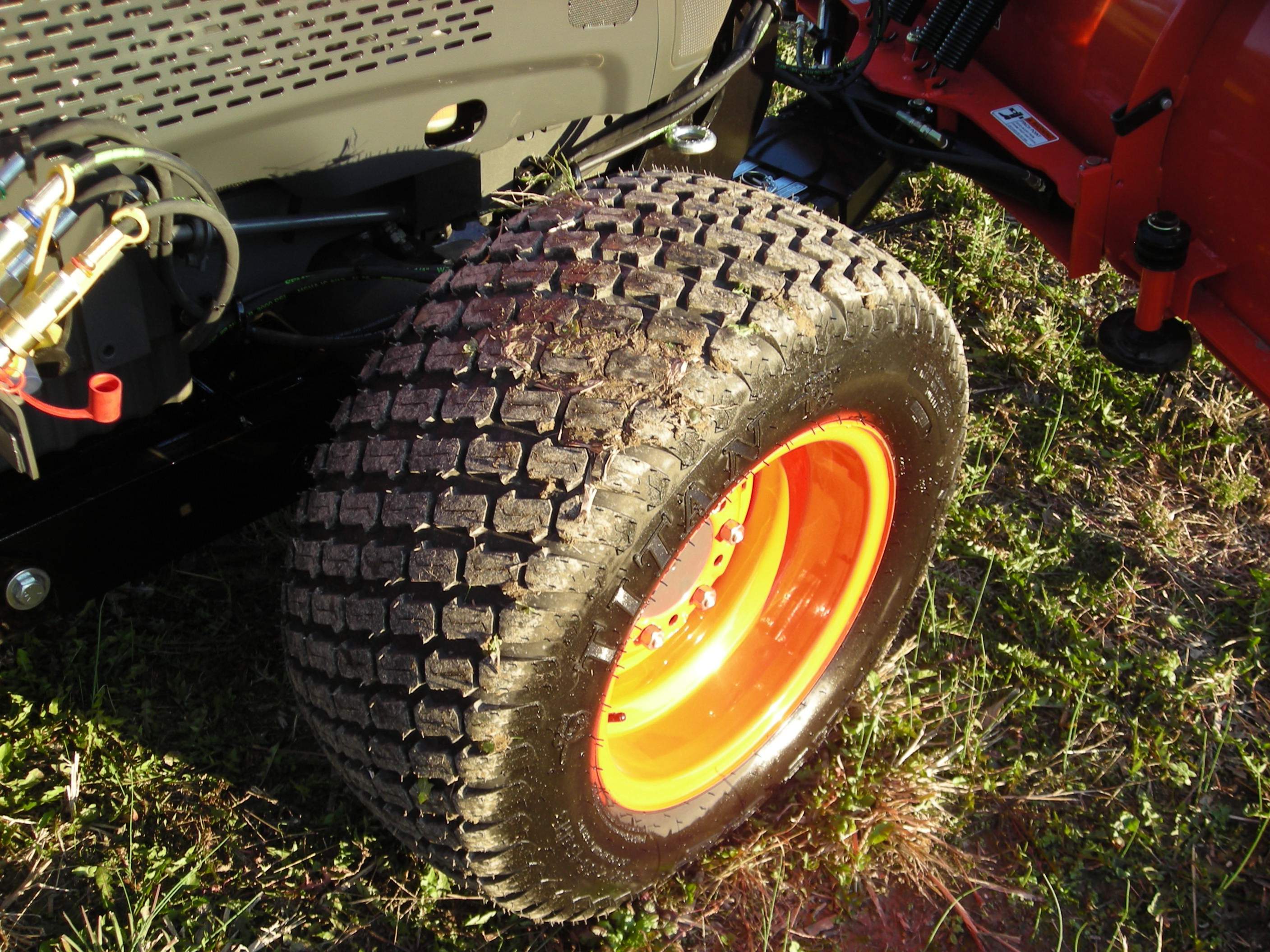

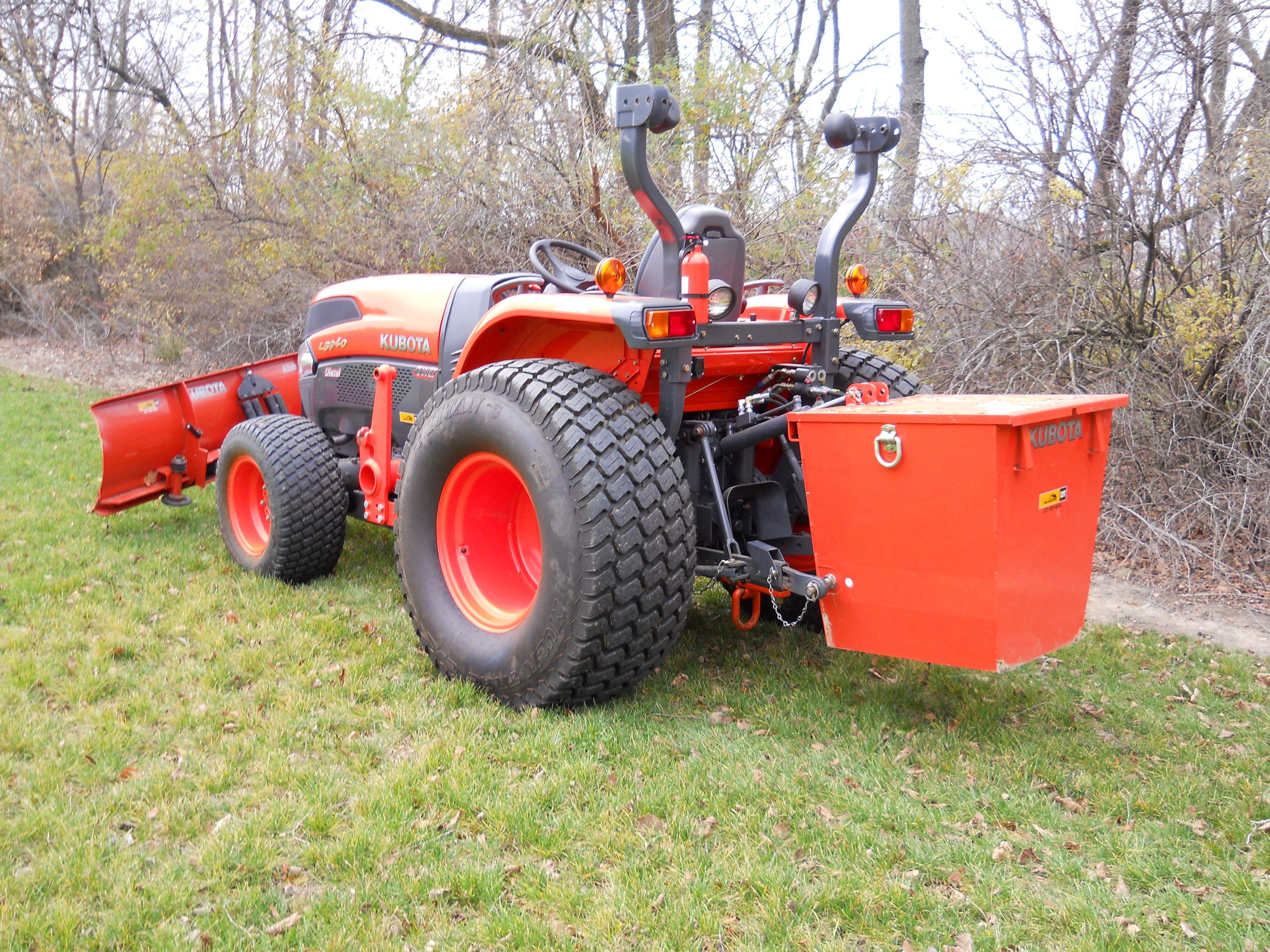

   / Kubota L 4330 Need turf tires #6
Here is the oem set up for a L3940. I can provide more details if this interest you. Great for mowing, in snow, and dirt. Better choices available for mud, but they do work. Philip.
