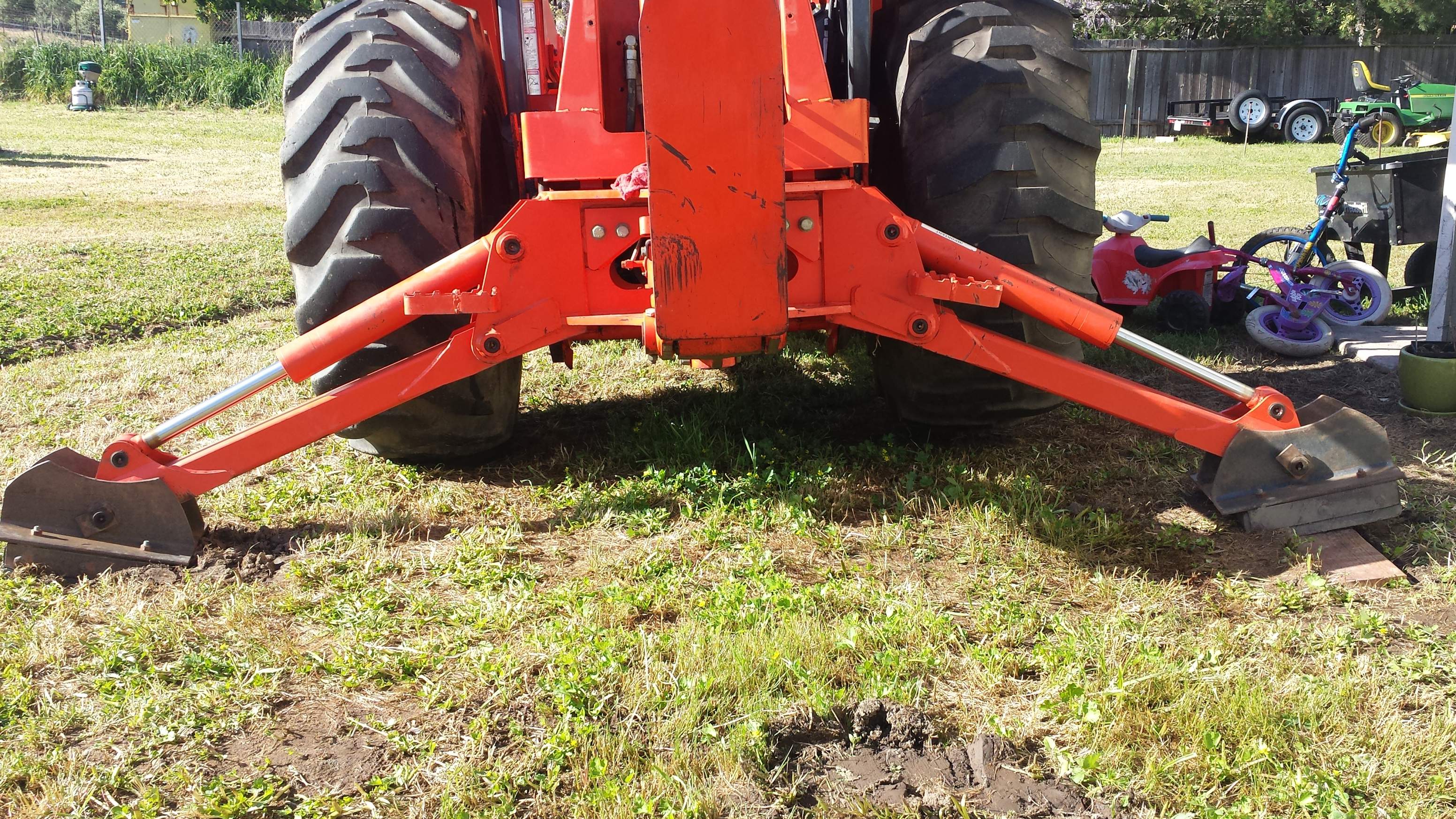

Hello everyone.
I am wondering if anyone has experienced weak stabilizers on their backhoe? I have a L48 with the BT1100 backhoe and the stabilizers seem to pick up the back end of the tractor only a tiny bit. I would say about 4 inches. They do not fully extend as I thought they should when under load. I can pick up the back end completely with the boom and test the travel of the stabilizers, and the do travel the entire amount. They do not leak down when extended and the rest of the backhoe functions work great. System pressure is spot on and engine rpm is about 2000. I will post a video in the next couple of days and test if I am leaking by the piston. I do not suspect this because I am getting about 2750 PSI for the hydraulic lines to the stabilizer cylinder.
Backhoe has about 200 hrs on it.
On a side note, I owned and L39 TLB and the stabilizers were able to pick up the tractor with now issues.
Thanks

Provide the angle of the cyl and the size of the cyl and we can figure the push force.
   / Kubota L48 TLB stabilizers / outriggers help
Cylinder boar is 2.75". What angle are you looking for? I attached a picture of the stabilizers at max lift.
I checked piston leak by, I there was non. The seal on the piston is good. I verified pressure and it was also right where it should be. I will follow up with a youtube link to show everyone how the cyl is acting.
What happens if you raise the machine with the dipper/boom and then lower the outriggers? Will the outriggers then support the machine?
