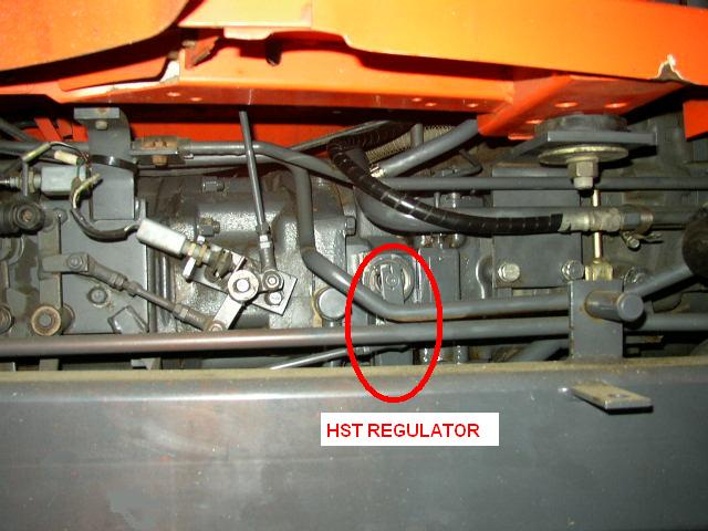

I'm a little late seeing this - yes, that v-notch piece is the "neutral holder". My L48 is the same I think - lots of pieces in that linkage to tangle with brush! - related reading on an old L48 and HST saga here.

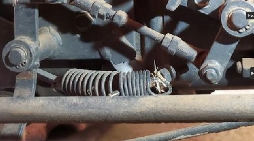

Any chance you have a pic of the mount that holds the front of the return spring?
   / L48 HST issue #9
Your spring looks usable - anchor point doesn't look too fancy - just a fixed tie-off. It's pull strength isn't critical. The hydraulic damper is spring-centered too. The bent attachment tab is soft steel and should survive careful straightening. Dick B.
