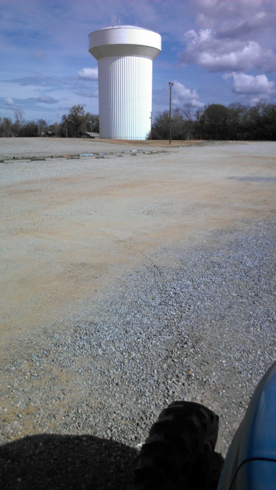

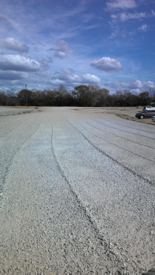

Well here is an attempt to add pix. This worked out very well and the lots looked great when I got through.

Mission accomplished. The lots do look well done.
A before photo might have made it even more remarkable.

The two with the water tower are before. There were lots of ruts that didn't show up well. Lots of bare spots, too. The two middle ones are afterwards....same area, just a different angle. The angle on the after shots was really to show the difference in the bare spots and actually was taken further up the hill, right down the middle of those bare spots. It took me a little while to get the hang of what to do at the end of the rows, but with a little patience, I felt like a "pro" by the end of the day. To start with, I was leaving a mound of gravel at the end that I was going over to smooth out. But with a little practice on feathering and making the sharp turn as described above, I got the hang of it. We haven't had any rain in a while and the dust on me and the tractor was about an inch thick, but this was a fun and productive day.
