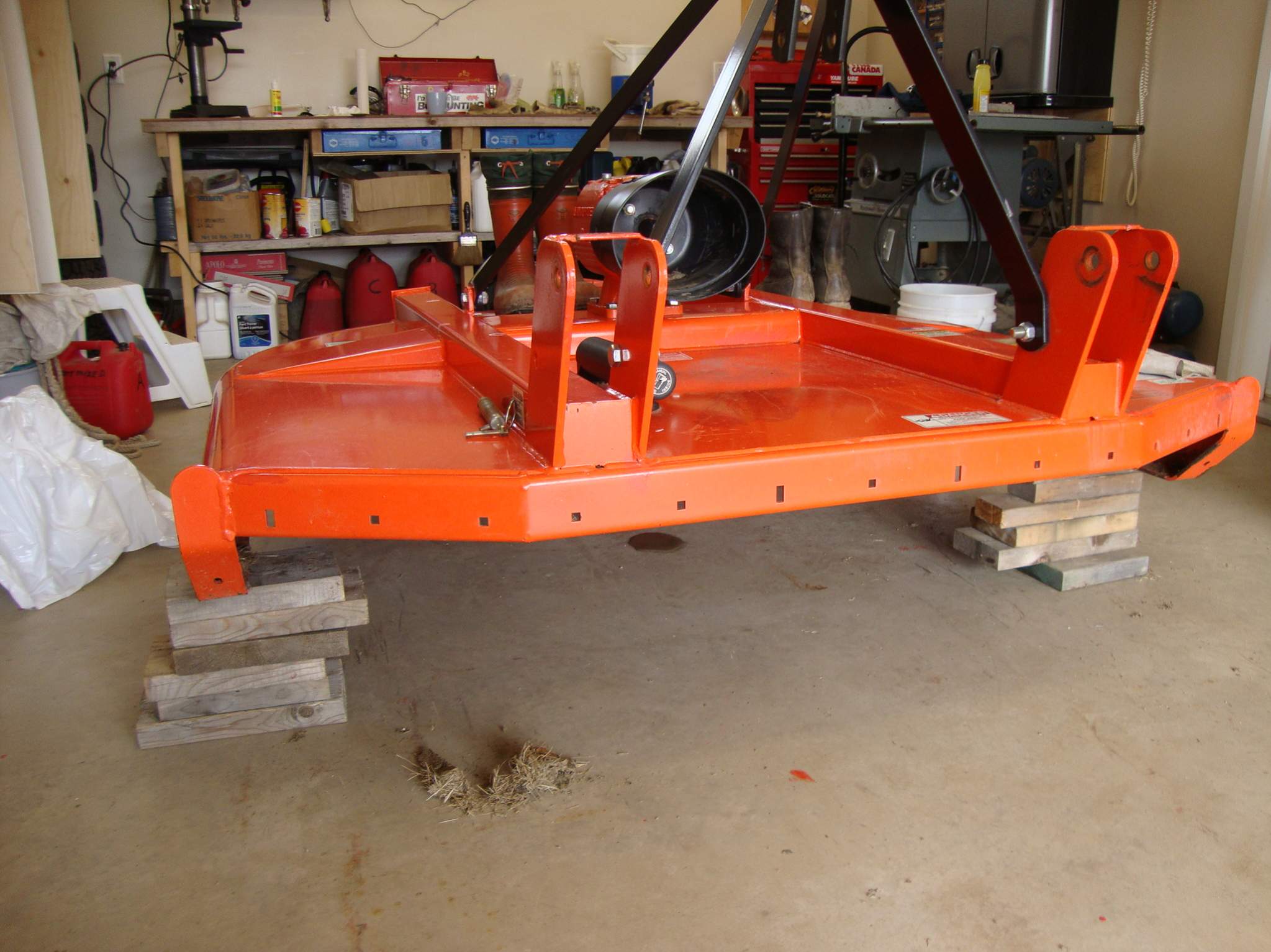

Do any of you have Land Pride RC's with the dangling chain shields in the front?
My 1860 came with the steel shield in the back, but nothing mounted on the front side.
From what I can see in the parts manual, they're simply short lengths of chain mounted with a piece of slotted flat bar and a keeper bar on the back side.
I'm thinking of building a set for mine, if it's like anything else Land Pride sells the factory kit would be pricey.

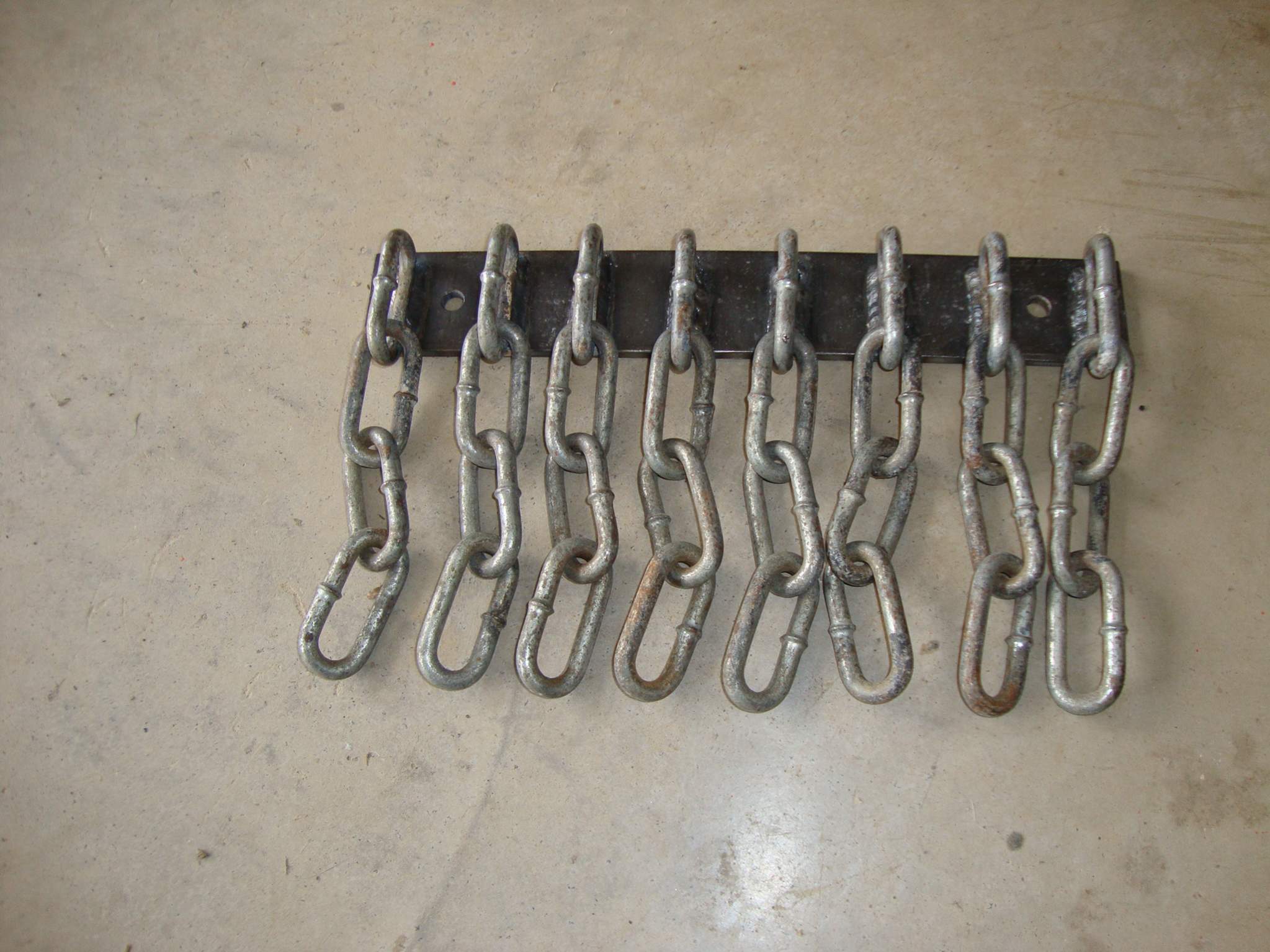

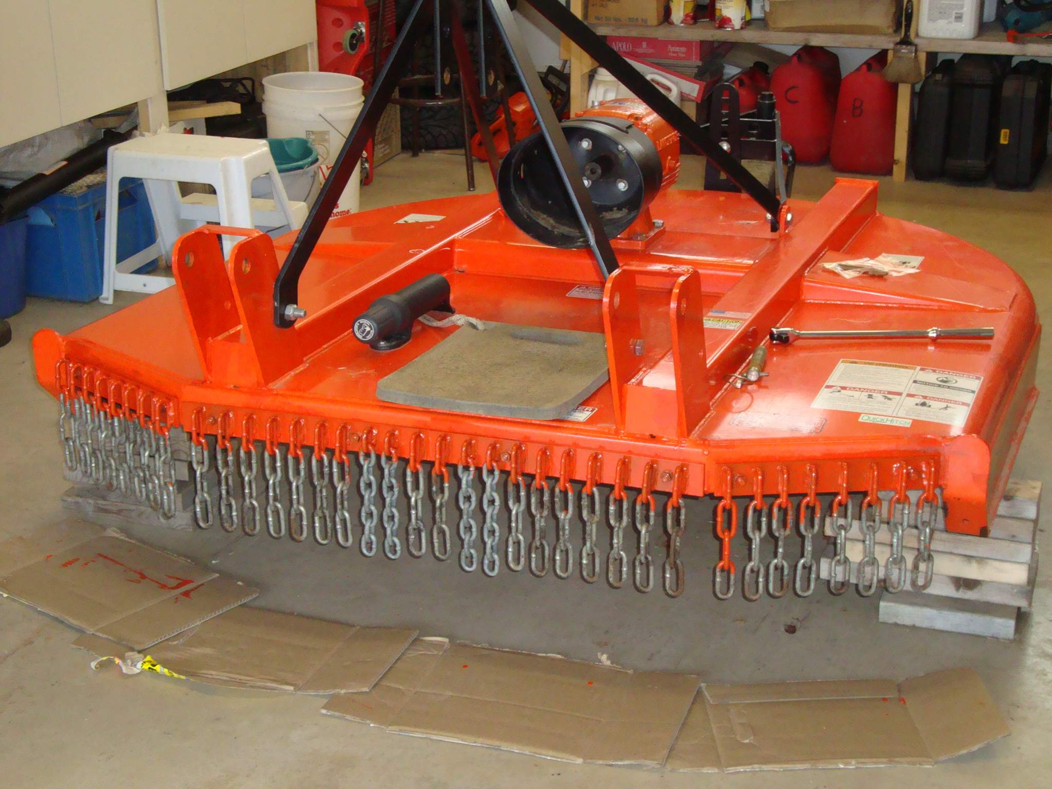

It looks like I'm building mine. I got the steel flat bar for $10 and the chain was already in hand, so my costs are minimal.
I welded the end link of each length of chain to the flat bar, then bolted each section of flat bar to the front of the cutter. I know there's lots of clearance at the corners, I'll check the center again.
I'm surprised mine came without any sort of guard at the front, the dealer didn't mention it when I was buying. I'd sooner have it open at the back actually, if I had to choose one or the other.
If the chain works out well, I may bend up a piece of steel and make some more for the back to replace the steel guard that's there now. It's not so good when you want to back over something instead of driving ahead.

I've got them built and installed, now to wait for enough grass to grow to try it out.

Looks like that will work fine.
It has already been mentioned, but make sure those front center chains will miss the blade when extended back. (You likely checked while building them.)
