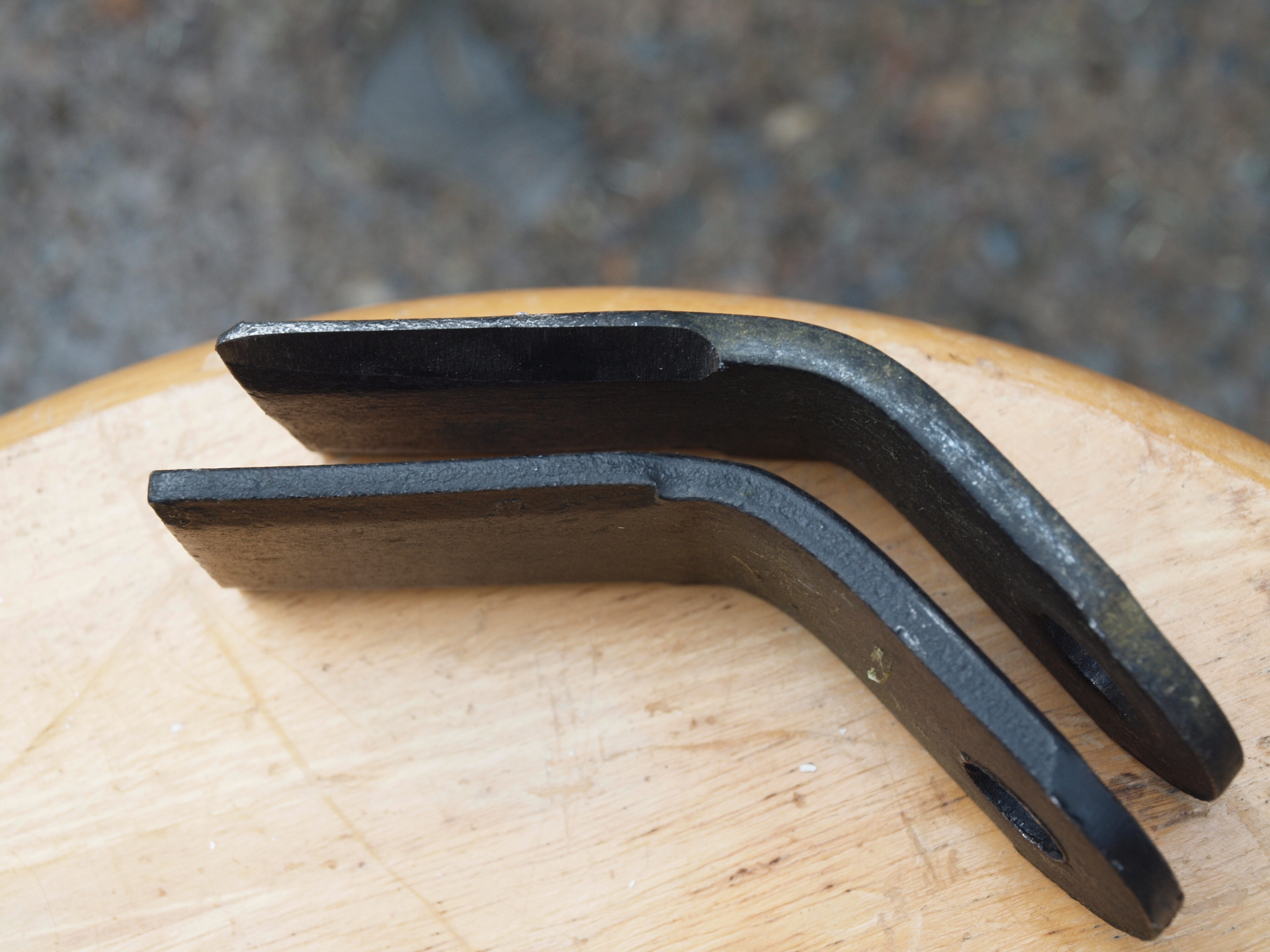

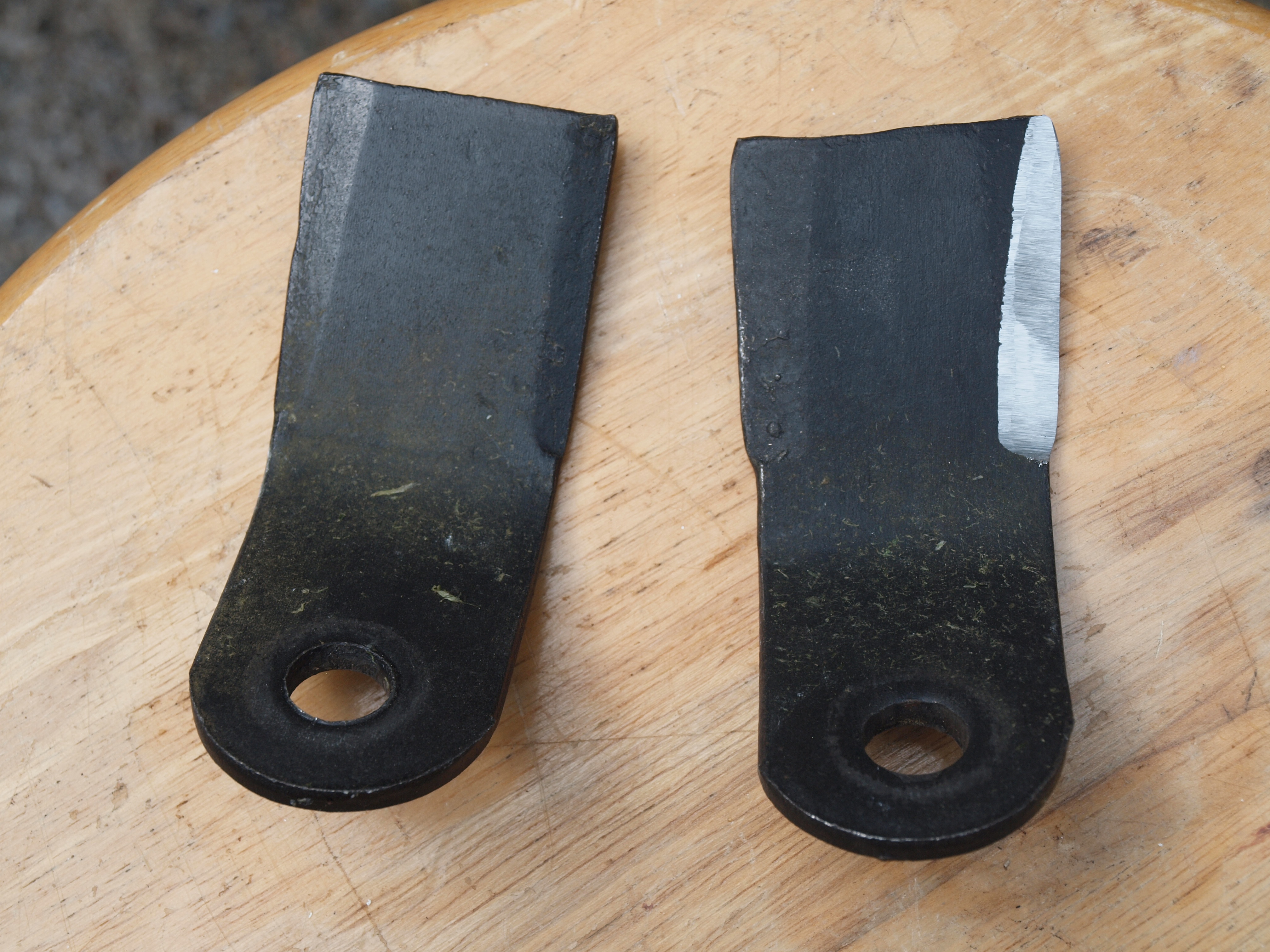

Long time reader, first time poster. Scored a BUSH HOG FL-50 from a used tractor and implement seller who has become a friend, for 200$. it was in horrible shape- the guy has probably 50 brand new box blades, 25 brand new brush hogs, and dozens of used implements from tillers, front end loaders, bat wings, tractors, even mini excavators at his home in Hardin, TX. Gets large lots from closing dealerships and at auctions- he had forgotten he had it (found it when taking picture of a big older JD disc and an antique tractor i was interested in). The bearings on the roller and drum were shot, to the point they had worn the center out of the shafts - I have them disassembled with plans to purchase new generic flange bearings and pop new centers, reweld and remachine them in my uncles shop- all the knives need to be replaced, but for now i will sharpen them (none are broken but all rusted badly)- I got all new bolts and locknuts for them (grade 8), because to get most of them off i will probably spin the bolt heads off or have to grind or torch them off. It has no belt cover. He threw in an almost new eurocardan driveshaft with slip clutch. So far i have completely disassembled the entire setup. The gearbox looked fantastic. I have found some basic diagrams/prints without dimensions on various part sites. I'm past attempting to find the correct dimensions and bearings- when i machine them i will just find the best value and most common close size bearings and go from there. we will check everything for balance while on the lathe- it's probably pretty close, as the rotor still has original paint, only the knives look bad. I tried it out as soon as i got it, and it was set entirely too low- i slapped it on my 1023e and run through a recently low mowed back pasture and it was scalping the ground. When I reassemble it i will ensure it to be set higher. If it cuts as well as i think it will (4 rows of 10 pairs of knives on the drum - 80 total blades @ only a 50" cut) it will be replacing my frontier 60" finisher for mowing around my grandmothers (approx 2 acres of yard), as well as my half acre yard.
