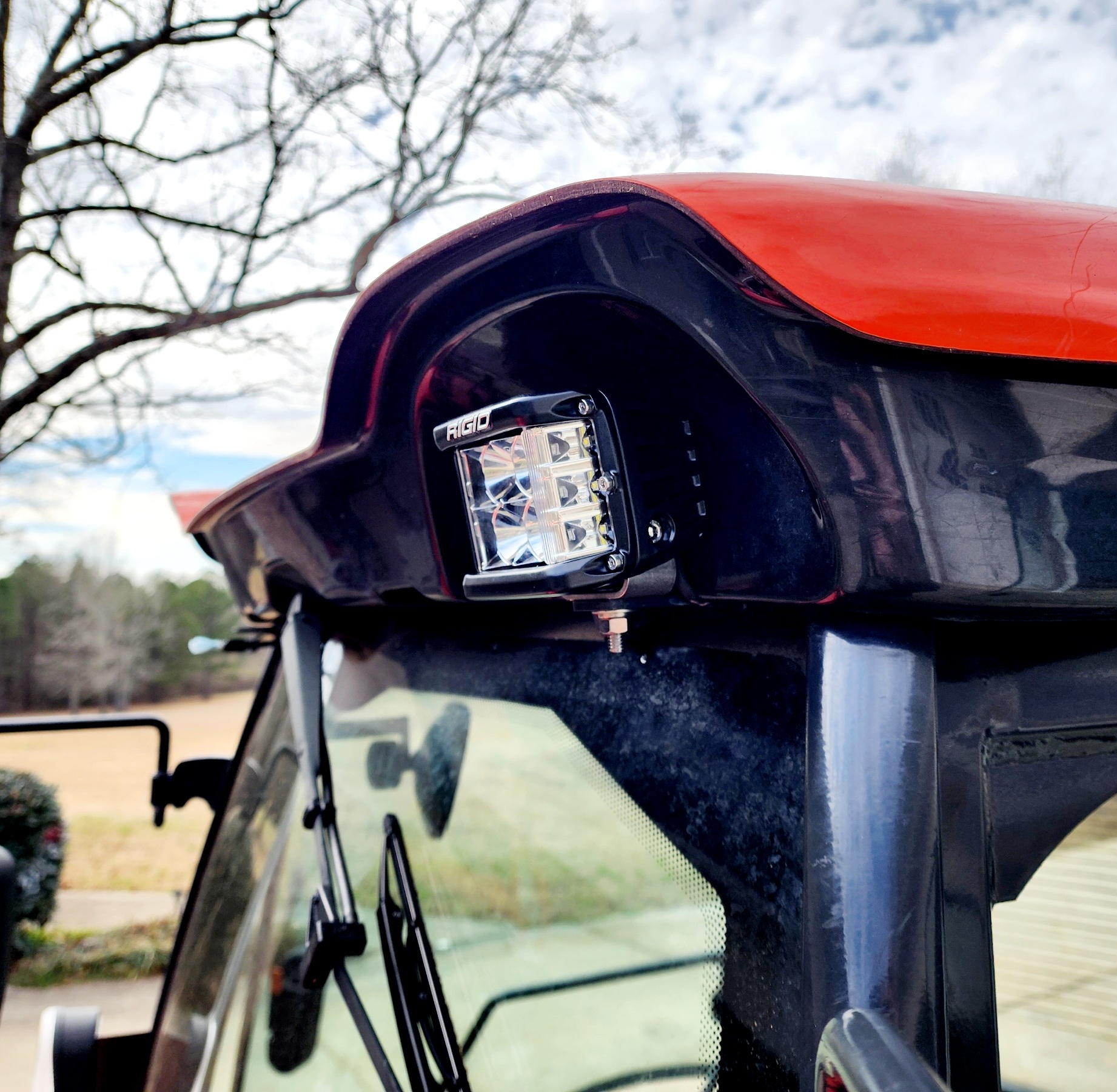

I've had good luck with Rigid pods and bars so far, one set a few years old and hit with pressure washers many times with no issues, but they're not cheap. IP68, pressure equalization vents, powder coated instead of painted, etc, so you pay for the higher quality.

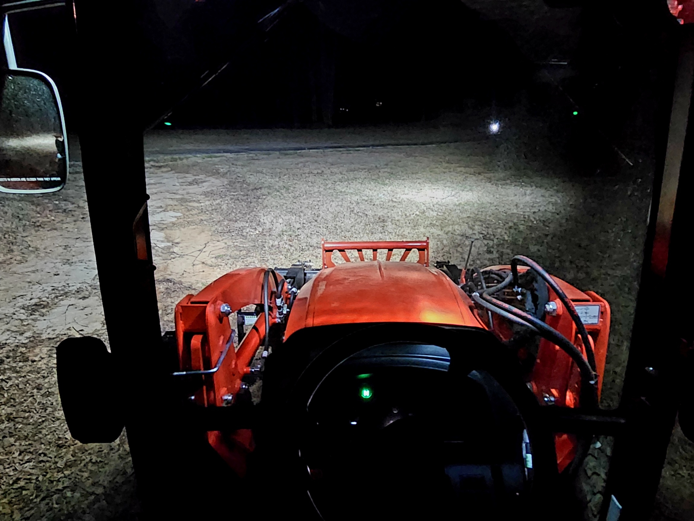

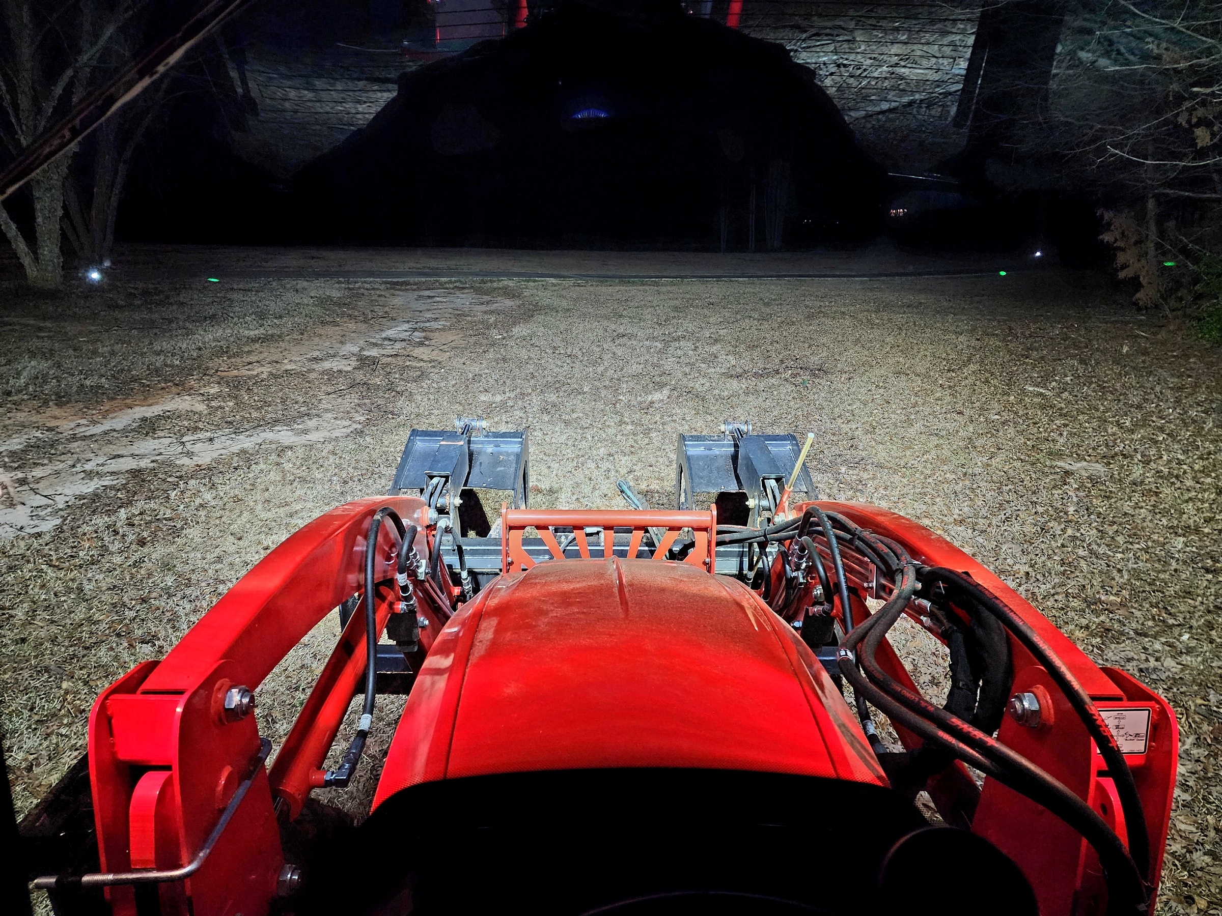

Just added Rigid flood pods to my tractor and they blow away the factory work lights by a long shot.
