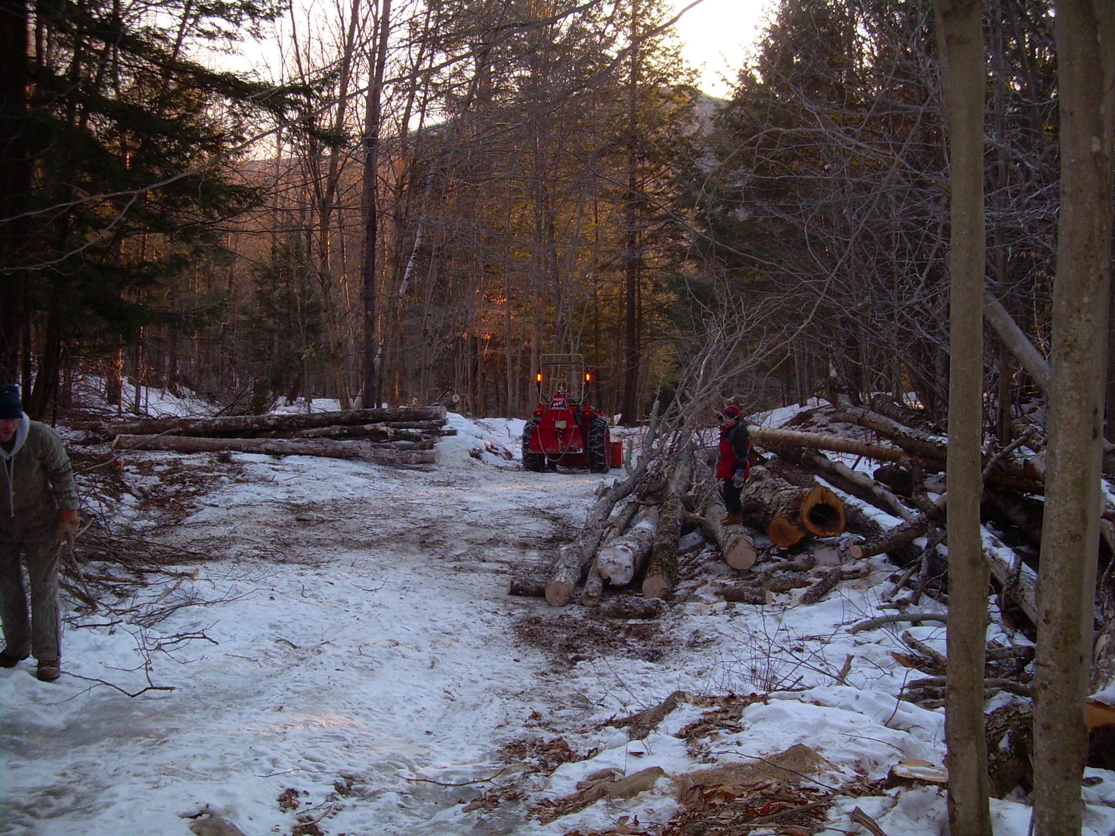

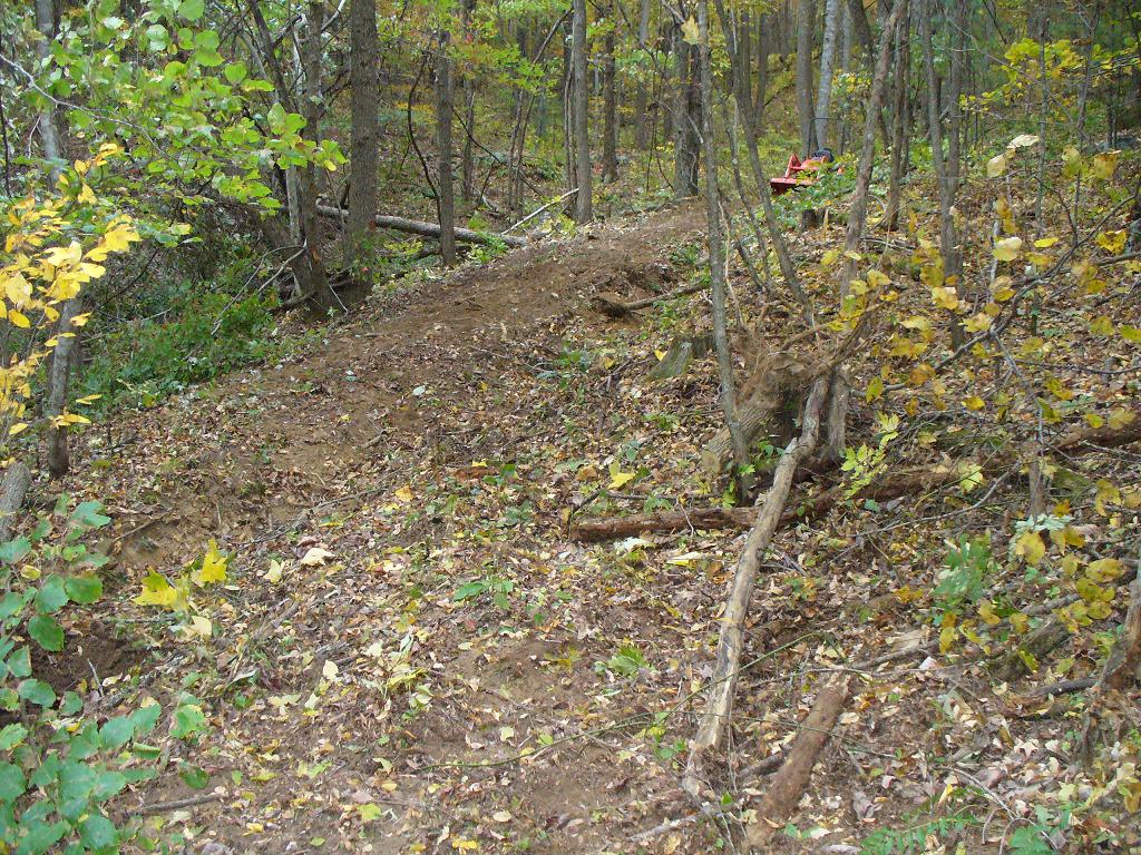

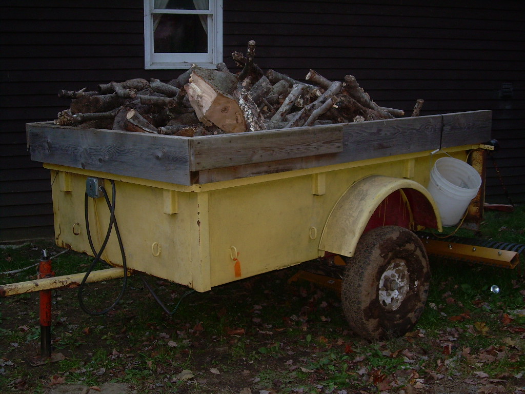

I cut wood on my property anywhere from 1000' to 3/4 of a mile from the house. I use a 4x8 trailer. When piled, I can get about 1/2 full cord on it. I do have the advantage of not having to climb up any hills on the way back to the house. The disadvantage is that I have to come down some really steep, rutted out trails with a trailer that weighs almost as much as the tractor.
I have electric brakes on the trailer and a controller on the tractor (a couple of close calls before I put them on). I can now stop the tractor & loaded trailer anytime I want.
We tow the splitter with an ATV. During wood cutting season, it stays in the woods covered up with a camo tarp. We only move it when we go to a different landing, until we're done, then it gets put away for the winter.
This is my first year with a skidding winch. We worked 3 saturdays in February and winched all of the logs to a three landings. All of the limbs got left where the trees fell, so the area where we piled the logs stayed pretty clean. It has been great. Now we can spend an entire day in one location just cutting, splitting & loading the trailer. We cut 4 loads last weekend, 2 this weekend. I can't remember an easier wood cutting season.
Obviously, if my woodlot wasn't behind my house, all of this would be more difficult. I have pressure treated wood "slots" on my trailer on both sides to hold multiple chainsaws, and the buckets hold the gas & oil cans. All of this stuff used to ride on the trailer, on top of a full load, but losing the cas cans & a chainsaw on the way down the mountain wasn't fun.

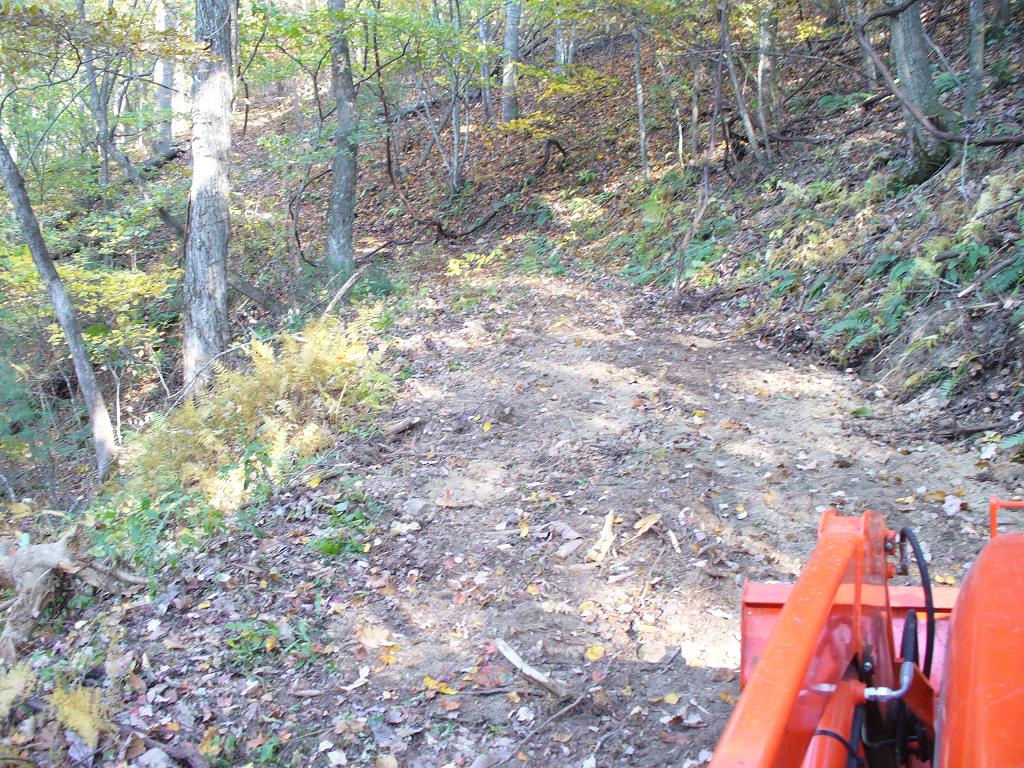

Thanks for the pics and replies.
I guess a lot of how it's done depends on the specific terrain of the area and the distance of the haul. Once I get my new 5x10 trailer built I will be able to haul a lot more per load (3500lbs vs 2000lbs) so that will also help. Got me thinking about putting a detachable hydraulic splitter on the front of the trailer run off the tractor hydraulics.
Here's some pics of the kind of terrain I'm dealing with:
(I guess in this type of terrain a 3pt logging winch would be real handy :D)
