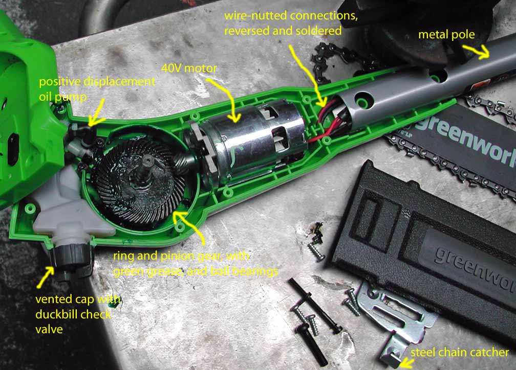

That looks pretty decent. How is that one priced compared to the $129 (on sale) Lynxx?Here is what the Greenworks 40V polesaw looks like inside. Overall, it seems well-made.
I like the use of ball bearings on both ends of the ring gear shaft, and a decent amount of
green-colored grease. The pole is metal, as is the chain-catcher. The only nit I see is
that the power wires are twisted together with wire nuts. I reversed and soldered them
before replacing the wire nuts.
So far, so good. I hope the ring and pinion gears hold up. They look OK and mesh well,
but I do not know the quality of steel used.
