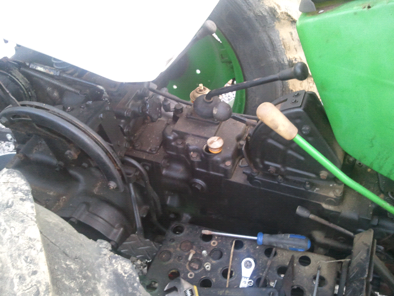

You'll like the OEM service manual. If it is like mine it will have green colored slick covers and be printed on semi slick paper. It is specific to that tractor and the section on the powershift is fascinating.

What levers do you need to know about?

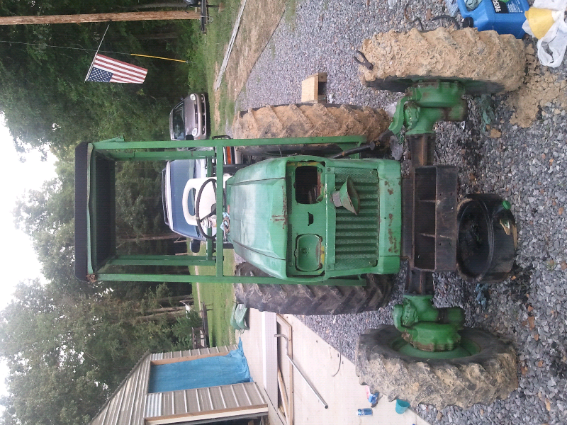

If you don't mind, I'll comment on some of the things you've gotten done. A few of those projects are places I've been as well. Some of it is general info. That's an impressive list of projects you have underway. Getting to it:

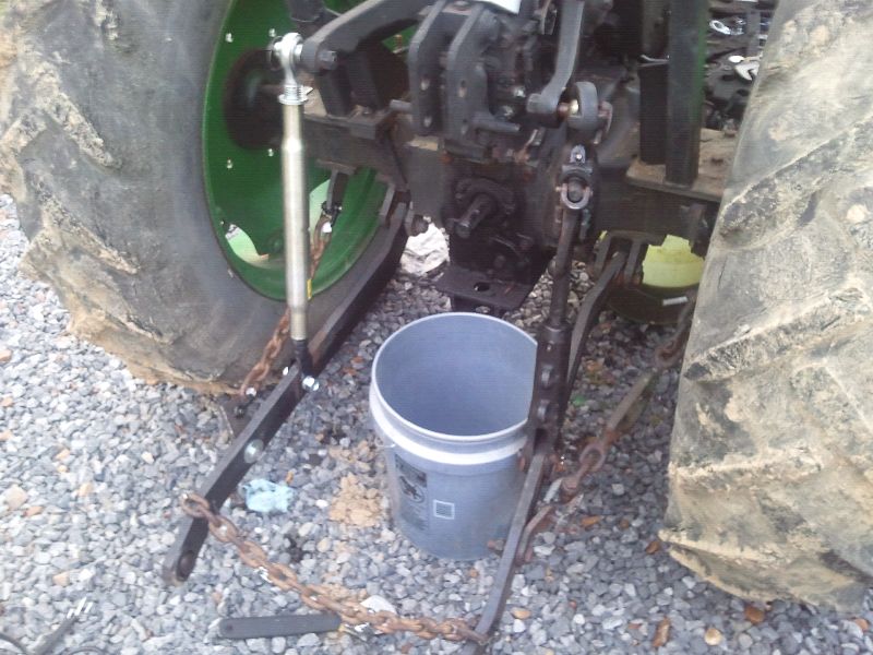

(- installed new 3pt linkages.......)
Were you able to make one of the 3pt links adjustable? The OEM one had a nice hand crank adjustment on one side only. This can be fabricated An inexpensive source of parts is to use the lead screw and pinion gear from an adjustable caster wheel such as is sold for leveling the front of towed trailers.

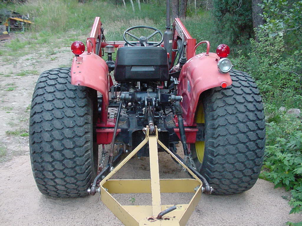

(- reversed front tires) but being my first tractor, I want to err on the side of caution until I get used to how tractors balance on slopes.)
Tractors don't balance on slopes well at all. Especially with the Ag lug tires or the narrow turf tires. You are wise to be cautious. Switching to wide will make it much more stable on slopes. If you do a lot of slope work you will want to eventually put on wide turfs or duallies. The JD1050 wheels will interchange.

(- repaint body (previous owner painted John Deere green, I don't like it.)
It was JD's contract to have Yanmar design and build the JD compact tractor line that ended the import of the YM336D to the US. Yanmar was allowed to dump a large amount of YM227D and YM336D tractors on their US dealers in about 1987 or so for a few months. Most of those ended up on the West coast and many in rental service.Wish I'd had the money to buy a new one in the crate at the time. They were still expensive, though.
On the color....There was a time when JD and Yanmar were tightly connected. For their own compact line, JD elected to have Yanmar tractors "rebadged" as JDs. There was a popular photo at the time showing a Yanmar assembly line splitting with tractors going down one path being painted JD green and the ones going down the other conveyor belt ended up being painted with Yanmar colors. Unfortunately JD elected not to license the powershift option, or the good loader, or the Yanmar powersteering system....so the JD compact tractors from the 650 up to the 950 were never quite as sophisticated. The JD1050 had a Yanmar turbo as did the larger sizes made by Yanmar for Deere. I had always hoped to find one of the rare JD1650s. It was actually a larger Yanmar never imported to the US.

BTW, here's a picture showing wide YM336D turfs. These were optional.
