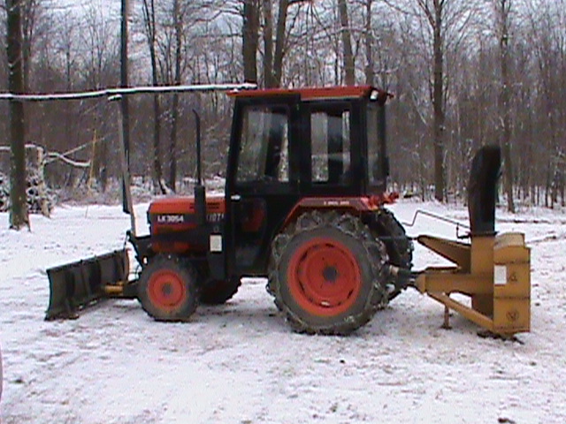

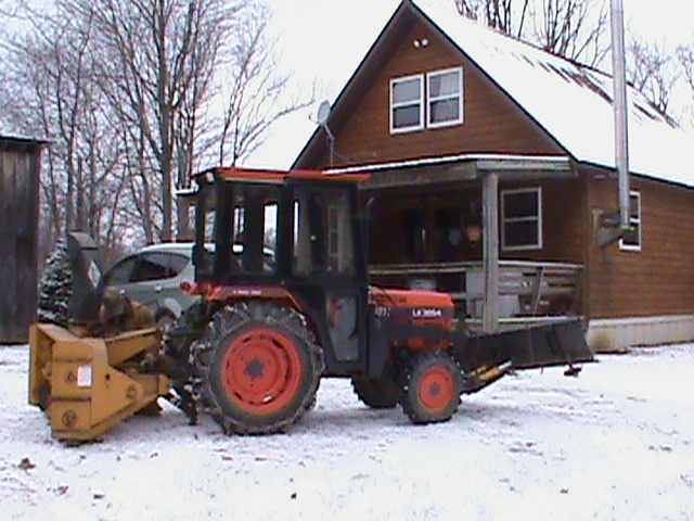

I have a Lorenz model 530 66" i dont know the year, i got it used $600.00.It was like new still had the paint on the fan.I had trouble with shear pins breaking to easily & ended up drilling the hole out & useing bigger bolts now it works fine.I can blow snow out to 30' half that distance with wet snow.It does work well,i have video but cant post it 8mm tape.When i get snow to blow i will take video with my new digital camcorder & see if i can figure out how to post it.
