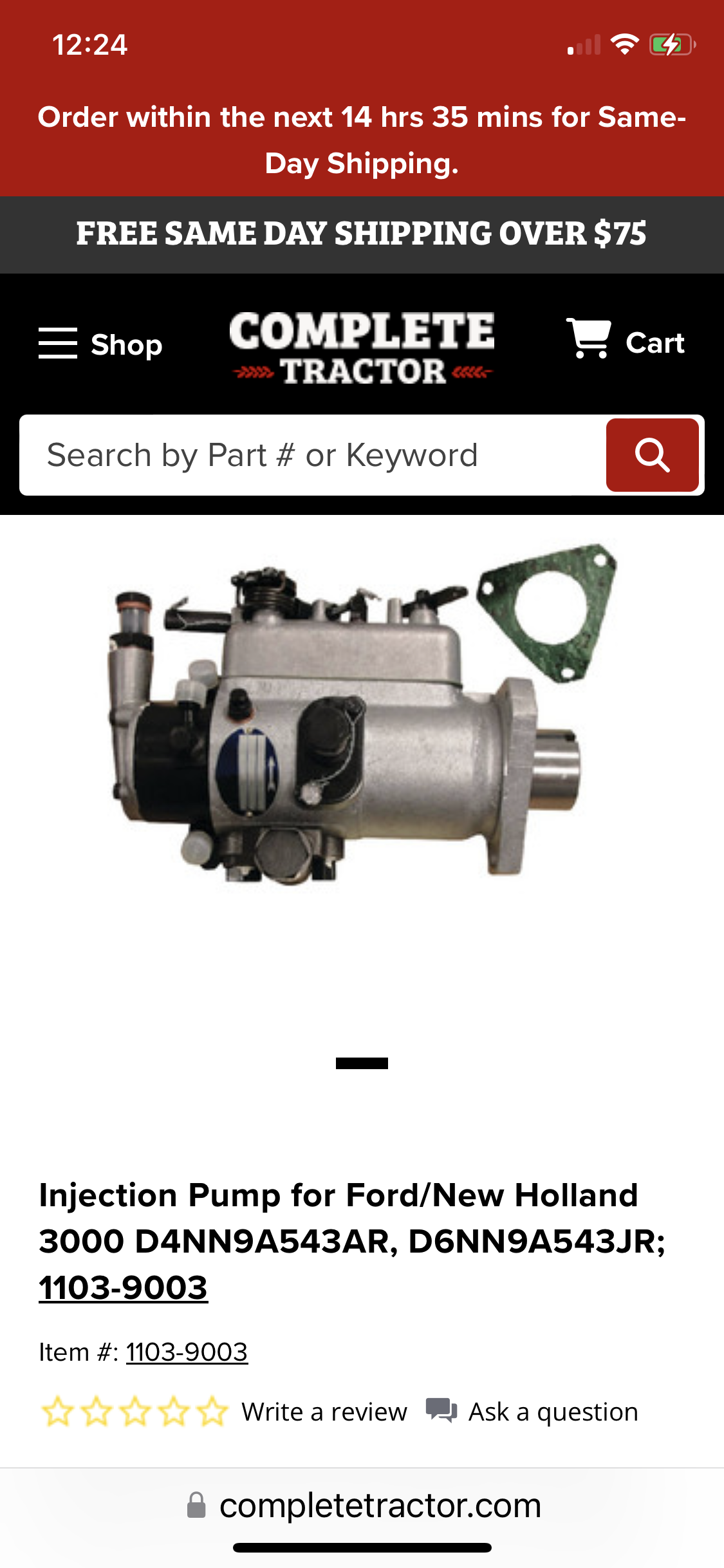

Let’s start with some pictures of the pumps or at least some pump #’s..
I gotta know what I’m working with..
   / Lucas injector pump swapped to Bosch mechanical pump
This is what is originally supposed to be on the ls180 new Holland skid steer.
#9
This is the injector pump I installed that was original to early seventies ford 3000 tractor.
