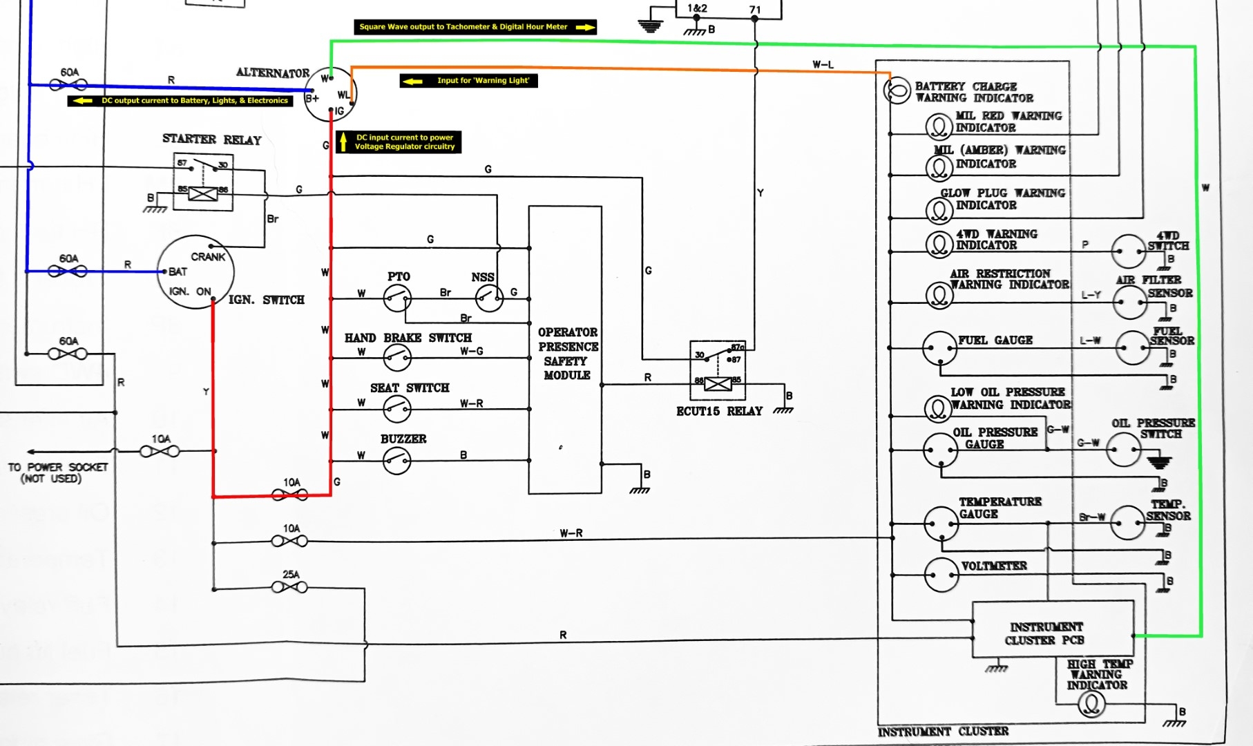

Last spring I purchased a used 2016 Massey Ferguson 2607H with 4 wheel drive and 710 hours on it from a dealership.
The engine dies at random whenever I have the PTO engaged.
Sometimes the engine dies right away when I first engage the PTO and begin to rev it up to the necessary RPM. Other times it would run fine for hours and then all suddenly die. When the engine dies, they are quick kills similar to turning the tractor off with the key.

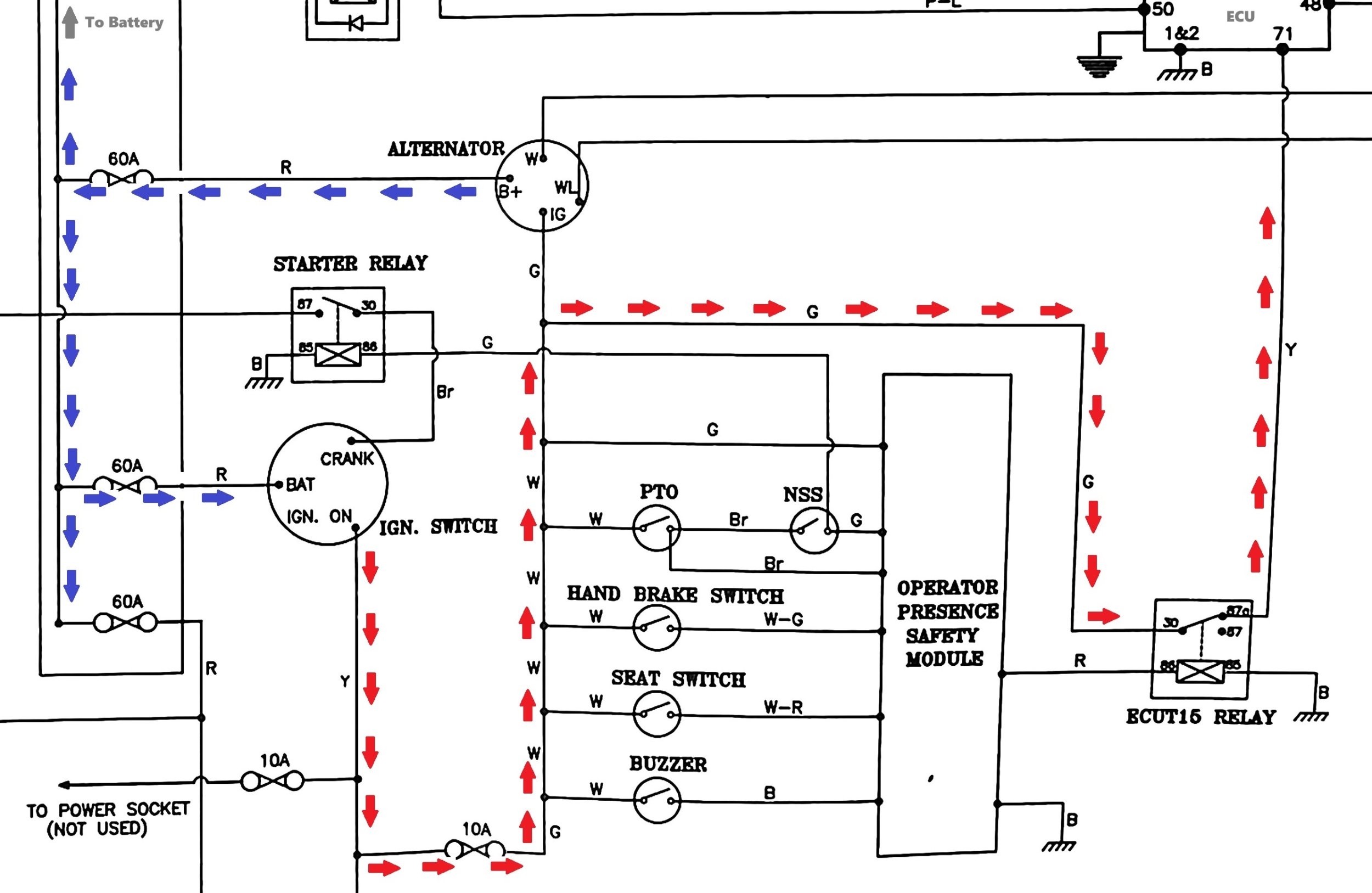

This tractor has a Operator Presence Safety Module and according to the logic table on page 61 in the Operator Manual the Safety Module will automatically shut off the engine by turning off the ECUT15 Relay if these 3 conditions are met at the same time:
However, the previous owner took the seat switch out and hard wired it so it will always read that the operator is always present regardless if there is anyone in the seat or not. I disconnected the hardness to the seat switch and took it to my ohmmeter to see if the hard wired job the previous owner did had any flaws like a loose connection. With the ohmmeter connected, I moved the wiring around and pulled on it. But the connection is pretty solid, therefore I’m at a loss here.
My next step is to disconnect the PTO safety switch so it always reads the PTO is disengaged and see if this does anything. If not, I'll check the ECUT15 Relay to see if it is starting to go bad.
However, none of this explains why the tachometer wasn't working properly (only while the PTO was on) the last time I used the tractor this winter. On this tractor the speed sensor is electrical and the sensor reads the speed off the flywheel. It’s not a mechanic cable like on the older tractors such as my 30 year old Ford 4630.
- The seat switch senses the operator not present in the seat
- The PTO is engaged
- The hand parking brake is NOT engaged
