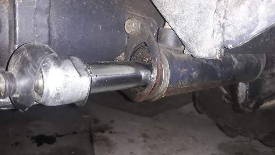

We have a GC2300 at our little pony club that has bent the steering box bent brackets that hold the hydraulic unit.
I removed them, flattened them and reinstalled but it has done it again after a few hours use and actually seems worse.
Can anyone explain why it might do this ? I thought if it's turned to full lock it might push on the bracket but an unsure and cant figure out why it has happened....

Have heard of those loosening up, but not sure what could cause them to get bent. Got any pics? On level ground, does the tractor track straight with hands off the steering wheel?
   / Massey Ferguson GC 2300 bent steering box brackets :(
Thanks for posting Irvingj i have been reading your posts :)
it looks a bit like its loose but it was bent both sides out about 10mm away from square.
it tracks or (or did) but the slop made me notice the issue in the steering its a shared tractor so not just one driver..... but i am now sort of in charge of looking after stuff

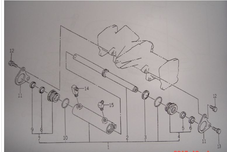

Here is a parts diagram, i also would have thought the tie rod end links would bend 1st if they had to if the ram just kept pushing. I will flatten again tomorrow but am trying to make sense of it 1st.

Looks like the only thing that holds that cylinder left-right is those two identical brackets. Have you seen the other one bent at all?
It looks like from the diagram that the only way this can happen is "too much steering force." I do not think the cylinder itself has the oomph to bend those brackets. Pretty well has to be excessive lateral force on the outer edge of the front wheels up at the level of the center of the hubs. How that happens = ?? One of you two operators is hitting something or moving with a lot of force against one or both front tires.
Any signs of impact or marks giving clues on the tires ? Rims ?
By the way, unless Massey redesigned the hardware showing in the post #5 diagram since the early GC's I don't see how it could have been an issue then and not now.

I just looked at mine and I would also hazard a guess that front wheel alignment could play a part if it caused one wheel or both to put excessive inward pressure on the steering ram.
The back side of that bracket should be recessed so the that cylinder fits in and is held centered. If the cylinder came out of that recess it wouldn't take much jarring to bend the bracket. A slight bend is all it would take because the cylinder would not fit between the brackets if not seated in the recesses.

Just to clarify, both sides are bent "out" and yes i have seen the issue on another thread but not the solution or cause.
JWR - to much steering force may be it, say on near full lock and then wheels "pulling" or early lock is causing ''pushing" opposite on the ram bending the bracket.
