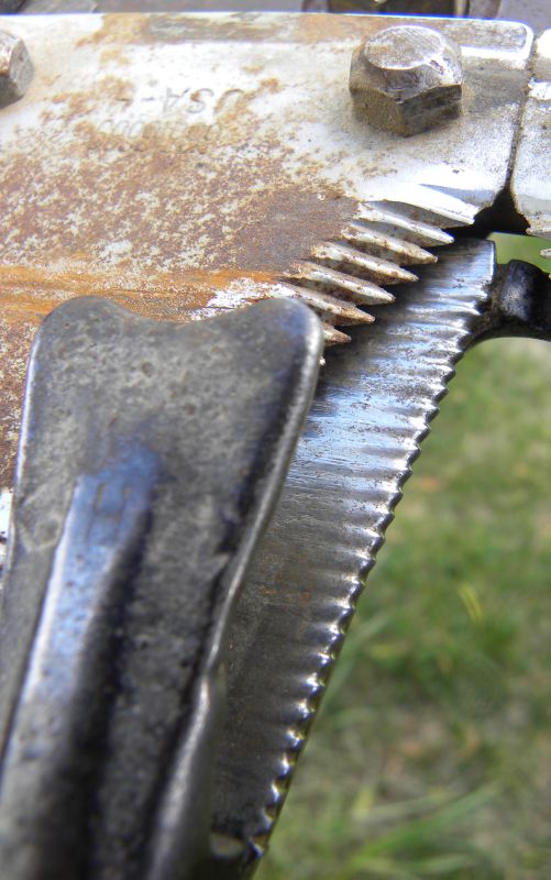

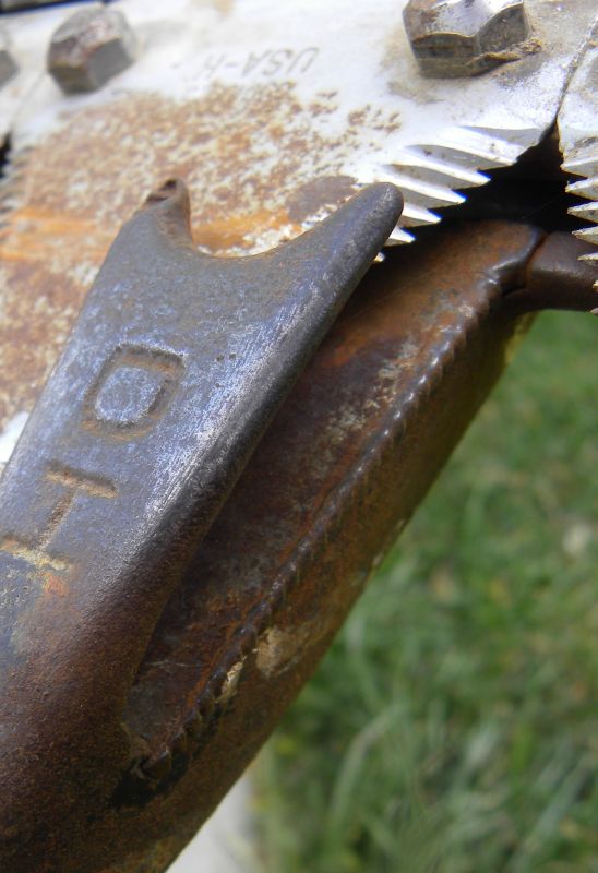

Personally I have never seen ledger plates wear out.
See the pictures. :) These are both currently reinstalled on the mower. The shiny one isn't rusted because I took it off when the mower broke last time a few years ago and had it in the barn. The rusted one stayed on the mower, outside, but under a shed roof. You can see on the shiny one the worn groves trailing away from the notches in the serrated edge. The other one is just so badly worn that there is no longer serrations in the middle of the cutting edge.
Incidentally, notice the gap between the ledger plates and the sections. That's probably the worst, while with some guards, the section is actually contacting the ledger plate. I'm about to go out and try to align everything! :confused:

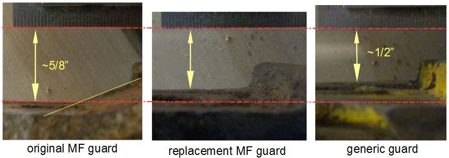

I thought I'd send along a picture showing the variation in the various guards, including one which I am guessing is an original, since it's the only one with a bevel to match the underside leading edge of the bar, one stamped MF, which I assume was installed later, but has no bevel, and one that is a generic that I took off my NI30, hoping it would fit. The thing to notice is that the measurement between the flat that contacts the underside of the bar when the guard is installed and the top surface of the ledger plate is different for each of the three. For the two that aren't the original, the smaller measurement means that the ledger plate surface is well below the bottom surface of the sections - probably too much to adjust.
Also notice that only the original one has the bevel. The middle one - the one stamped MF that has no bevel - was on the mower when I got it, and I used it that way until the mower finally broke. I suspect that too-big gap was a part of the jamming problem.

Having nice sharp edges would be nice but the real issue with ledger plates is the crown, i.e. higher in the middle than on the edges which creates a gap between the sickle section and the plate. Gap is what typically causes the crown as the grass drags across the edge wearing it down. The vertical gap between the section and plate is a big issue.
BTW - you can take a grinder and grind the edge of the ledger plate vertically to remove the serrations but put a sharp edge for better cutting on it. The haybine style guards have no ledger plates or serrations and cut just fine. I grew up cutting a lot of tough native "prairie" hay with them in the Dakotas. The serrations are not necessary. Today's tame hays are much easier to cut.

I am missing what you are trying to show me in these photos.
The distance from the actual bar to the back of the guard is not an issue as long as the sickle has a straight path to run in. If the sickle has a straight path and it is properly constrained the rest should not matter.
One thing I did forget to mention in my list is to check the lead. The outside end of the sickle bar should be about 3" ahead of the head end when everything is setting on mice level ground (assuming you have a 7-9' sickle bar). This is because the whole mower twists slightly as drags on the ground in the dynamic world of mowing and so the lead is just compensation for the drag.

Hadn't thought of grinding off the serrations. That might be a good alternative to new ledger plates. I found a source of them in small quantities at only @$1.25, so cost isn't an issue, but time to do it is, and I haven't found rivets yet. I can order those by the pound, even though I just need a few. I've also been told numerous times that smooth sections rather than serrated are recommended for grass. My intuition is contrary to that, but so be it. Nevertheless, all of my sections are serrated.
The gap is definitely an issue. I'll work at that today.
The issue here is the vertical distance, when the guard is installed, between the plane of the top of the ledger plate and the bottom of the bar - the bottom of the bar being the surface of the guard (shown in the pictures) that is in contact with the bar when it is installed. Imagine taking a guard that is properly installed and shimmed so that the gap between the ledger plate and the bottom of the section is as it should be. Now, imagine putting an 1/8" shim between the guard and the bottom of the bar and tightening it down. That would result in an 1/8" gap between the bottom of the section and the ledger plate. That's effectively what happens when I install the "generic" guard since that measurement is only about 1/2" compared to the "original" guard at 5/8". It has nothing to do with the distance from the back of the bar to the back of the guard.
Agreed
373883d1399323941-mf-31-sickle-mower-refurbish-wornledger-plate-2-jpg
Is this pic "in use"? Or is it partially disassembled?
I can't imagine how that could do ANYTHING but fold the weeds in half and jam them into the guard. The shearing edge of the section needs to slide directly on the guard below, to create the shearing action.
What is causing the section to rise so far above the guard? Is the sickle 'track' full of weeds, lifting it up? Is the bar bent? Is there a block that rides ontop of the sicklebar keeping each cutter section down low against the shearing edge (that you may grind sharp) of the guard?
