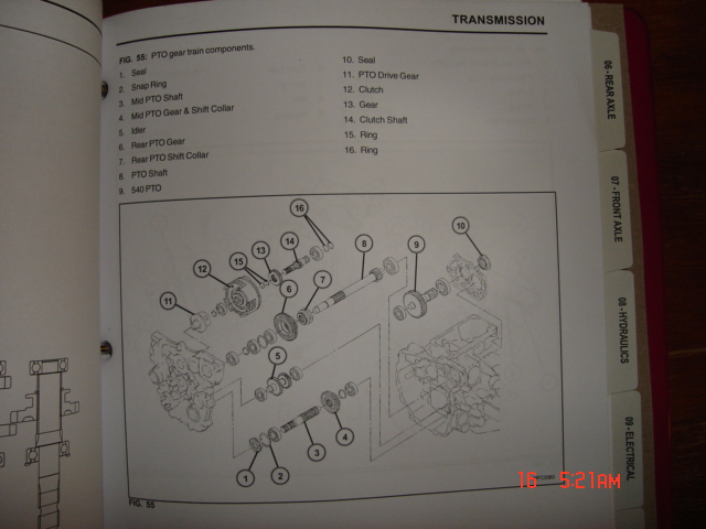

I have a "new" 2310 (only 96 hrs) so I haven't had any problems yet, but I see where the PTO drive does in fact have a wet-disc clutch inside....(sure doesn't act like it does!)
Unless your operation linkages have a lot of wear/slop in them, it sounds like it may be the clutch, which looks a lot like a motorcycle clutch- friction discs and separator plates, with a spring holding the assembly together. There's also a PTO drive gear, essentially a short splined shaft, that could be worn or chipped.
With that many hours on the tractor, I'd bet you've got some pretty good wear in there somewhere. The manual says, unfortunately, that you have to separate the transmission from the tractor to get at this stuff. This section is called the "PTO Clutch Pack."
