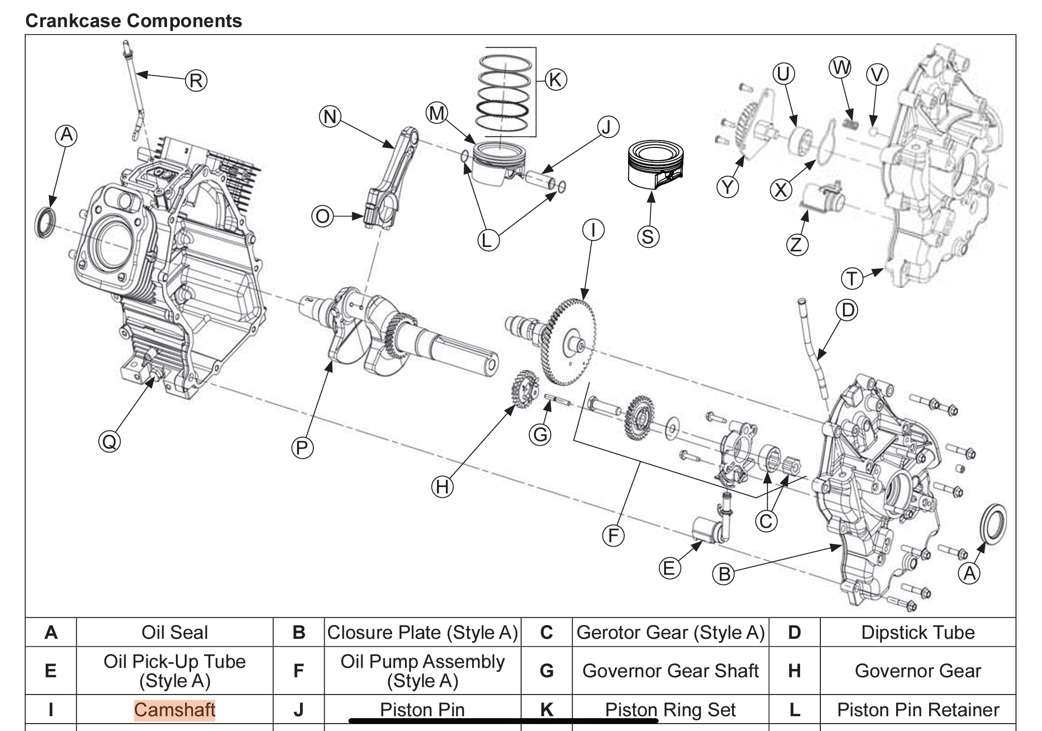

Took the lifter out and bled it (it was solid as a rock) and installed the new rod. I went ahead and pulled the intake side Lifter and same thing. Put it back together last night and no start. It backfired once with a little starter fluid and choke, but never tried to start. I pulled the cover back off and all looked fine. Decided to take some compression measurements and found ZERO movement on either cylinder. Placing a finger at the plug hole no pressure coming out but could feel some suction. Took cover off other side and all look fine—all four rockers are moving when cranking…I’m lost again…🥴

Let’s see: All four push rods look fine and are working. Looking into the cylinder I can see the piston moving when starter is bumped…

This afternoon though, I am concerned about the right side bank (looking from rear of the tractor)…the springs look to be a little less space between them compared to the other side. Last night I just bled off the lifters, put in the new rod, and ensured there was movement in the springs and valve stem when I pushed down on the rocker with my thumbs. Earlier I was reading many articles about TDC, so maybe that’s a factor?
   / More problems on the 425 Kohler CH25 #10
I would look for a timing issue. Make sure as the piston come up with the valves closed you get a spark at the top of the stroke, then watch what the valves are doing in relation to the piston position (the 4 strokes). Easy to do and no cost. Then go from there.
