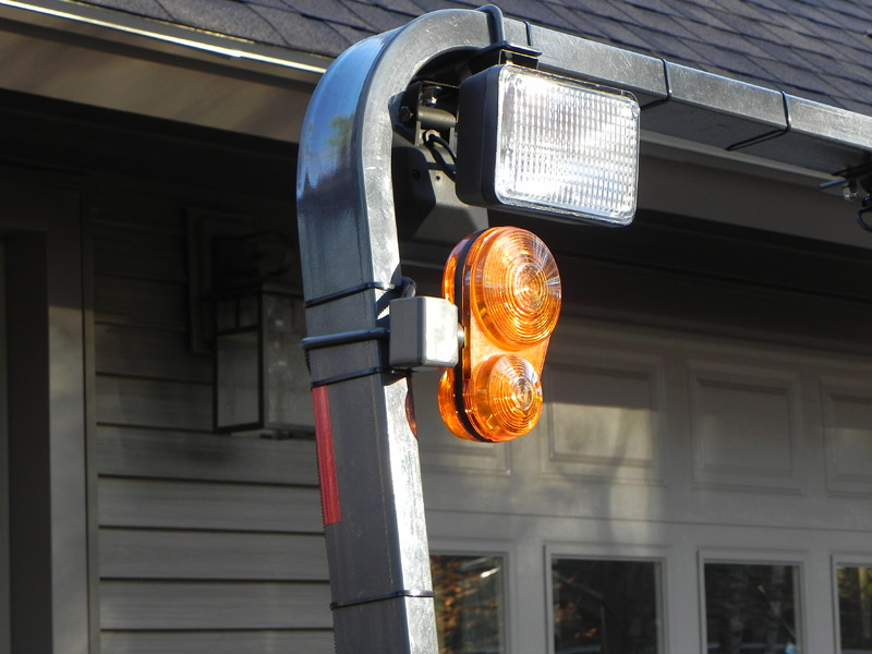

I know I've seen a thread on this also, but haven't found it yet. The thing I remember sticking out to me was to ensure (when adding wire to reach up to where you want them) that you leave slack enough to allow for the ROPS to fold.
Yup, when I added my Peterson floods I ran the loom down the back of the ROPS for that reason even though I never fold it down now. True story - before I built my garage with 8-foot tall doors I use to store the BX in a Shelter Logic shelter so I ran all the time with the ROPS folded to clear the door. The garage goes up, I put the ROPS up for good, I sell the shelter and the next day I drive the BX into the shelter to help in dismantling it. Oops! You idiot! One small ripped seam but the purchaser didn't care. Phew.

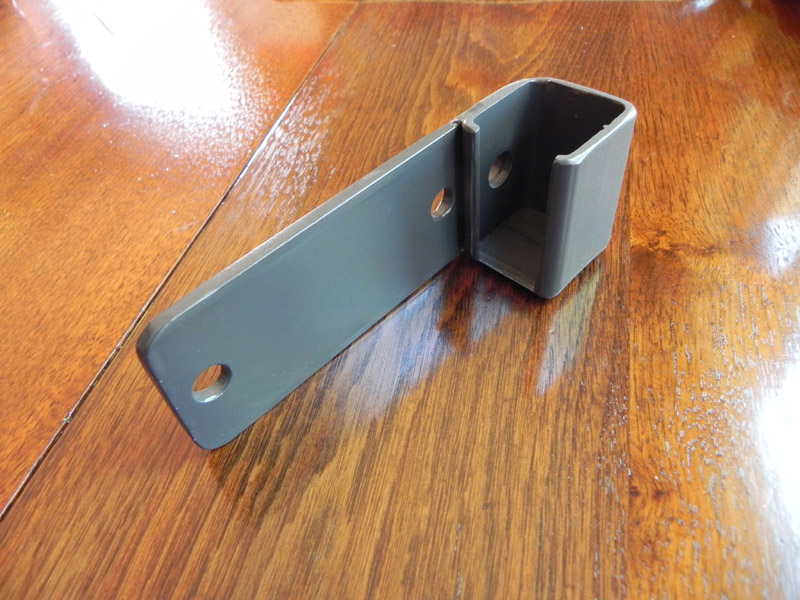

When I bought Kubota rear bagger, came with brackets to relocate flashers...bagger lid blocks view. Pretty simple..."square" u-bolts to fit ROPS and 2 pieces flat bar stock with 3 holes...2 for u-bolt and 1 for flasher stalk. Also came with wiring harness extensions. Should be able to reproduce this setup fairly easily...
really cool that the they think of this, and supply a solution. though, for the price of those baggers, they had better do so!

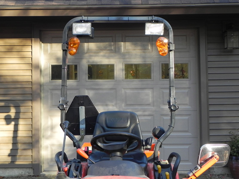

You can move the flashers quite simply by making brackets like I did to mount aux lights.
You could also just weld new tabs onto the ROPS, but that is a whole other can of worms.
Personally, If I had my tractor on a public road for any amount of time, Id install a strobe to the top of the ROPS... people are idiots.

Well, I can't wait for 4shorts to do his with some elegant solution so I guess I'll just cobble something together and move ahead. Everyone likes form with function but given the choice of the two, I'll pick function every time. Thanks for the responses, guys.
