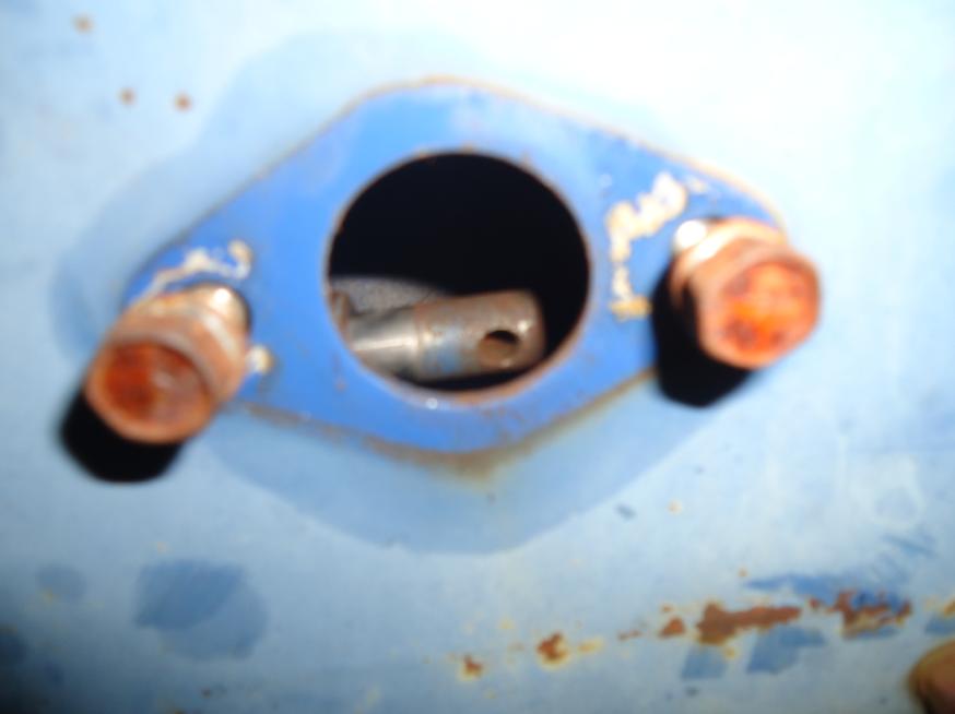

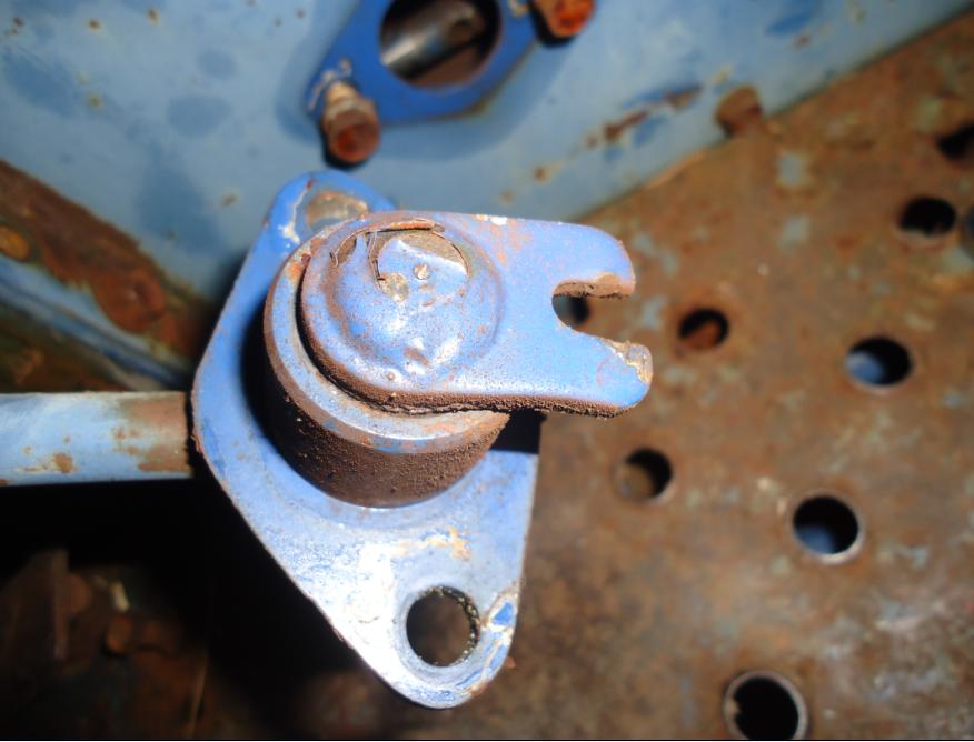

The lever on my S373D does not seem to disengage the front end.
I jacked it up and moved the lever around but the front wheels were still always engaged with the rear transission and will not turn on their own.
   / MT372D - Full Time 4WD? #10
duwem,
It's been a while since I looked at the 4X4 lever on mine but if I remember correctly, there is a small roll-pin that connects the handle to the shaft. Take a look and make sure it hasn't sheared off.
