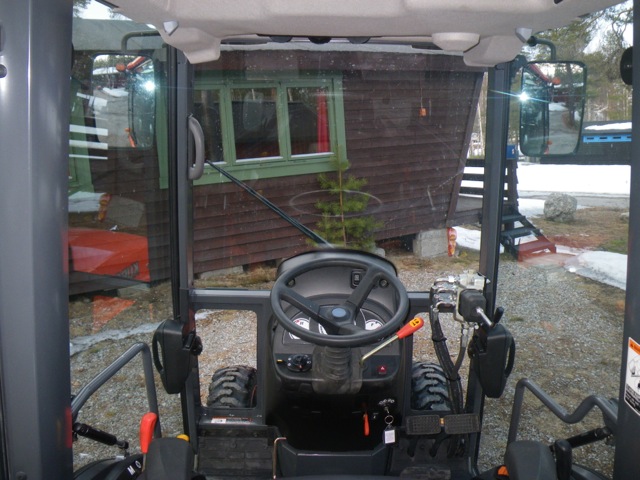

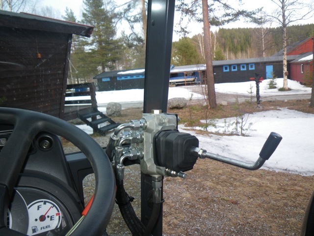

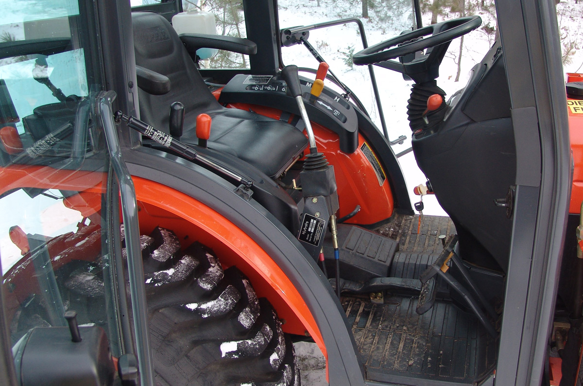

Edward could you post a picture which shows your hydraulic controller in the cab. It looks a bit different than mine pictured here:

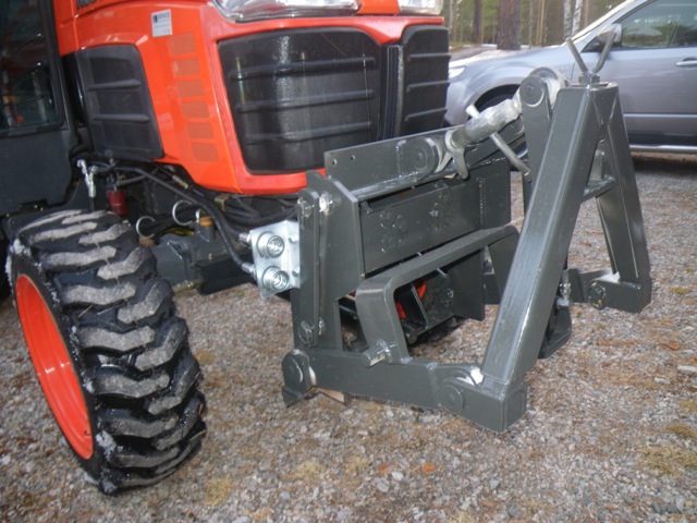

Your blower should be a little wider than the outside of your tire track. I don't think 150 CM is wide enough but you should check. I am sure that the hydraulic rig you have on the front of your tractor and the "unmated" blower will require some fabricating to get it to work.
I assume that you are using the mid PTO on the tractor which has a max speed of 2,500 RPM - the blower you are considering has a max speed rating of 2,000. I sometimes need the max speed. My blower utilizes the 4 positions on the Kubota hydraulic control lever - forward and backwards to lift and lower the blower and left and right to rotate the chute. I also added an electric chute activator to change the angle of the snow discharge which isn't in the picture below. Given you have a heated cab, you don't want to have to get out to manipulate things. I love using this tractor for snow removal. We get 5 to 10 meters of snow here and I probably have snow 20 to 30 times a year. Tonight we had about 25 CM of wet heavy snow, so far, so I will be out at it again tomorrow. Normally our snow is not wet and heavy here, but our snow depth has probably reached it peak today. I also include a picture I took just a while ago of the land behind my house. The picture includes the building where I store my tractor.

I will post a closer picture of the hydraulic control lever and post it here. I have to check which functions.
