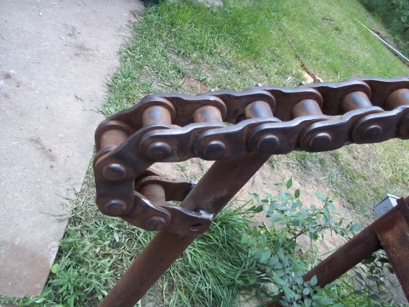

Nice work.
I'm a carpenter but would not own a wood deck because of the required maintenance.
So I took a different approach.
The handrail is made from the final drive chain from an old dragline.
Does not need spindles because it's less than 30" off the ground.
No, I wont paint it. Ever.

Great to see creative work! Rot is a major problem here in our climate. I used pressure treated wood for all the critical areas and of course the plastic deck should last longer than me :)
