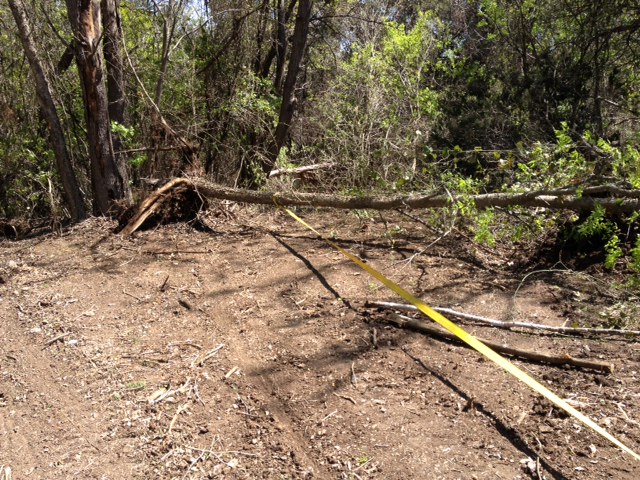

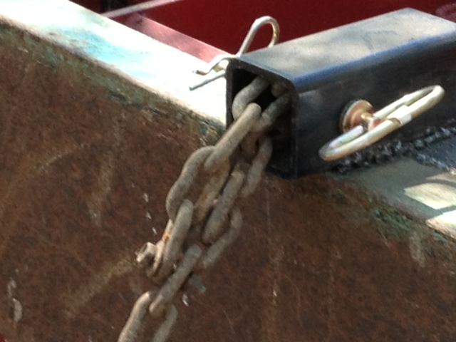

Well I took every ones advice, and am gonna start over on my welds. But first wanted to test the welds for my self. So I hooked a chain on a tree I needed down, and pulled. The weld held!! (the first time) The second tree was a little larger. However it did save me the hassle of having to cut it all apart again. No humans, animals or aliens were harmed in my experiment. I'll send pics of the new welds as I go.

Awesome. At least you know your on the right path. Like I said, put that machine on 7 setting on high. Clean the contact points on the metal. Using a slow sweeping motion with your wire, build up a small puddle and keep it going. With that welder you have, I would not leave any gaps in the weld.
