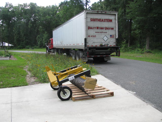

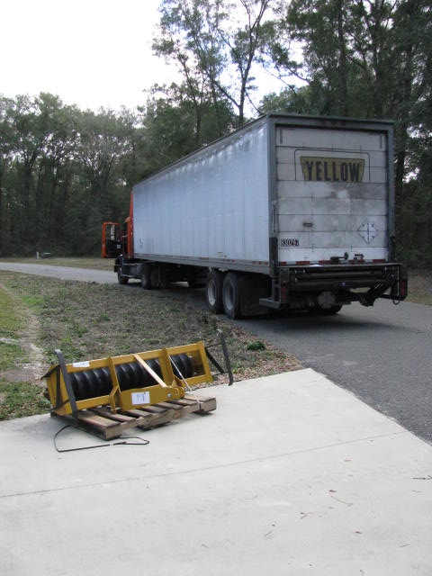

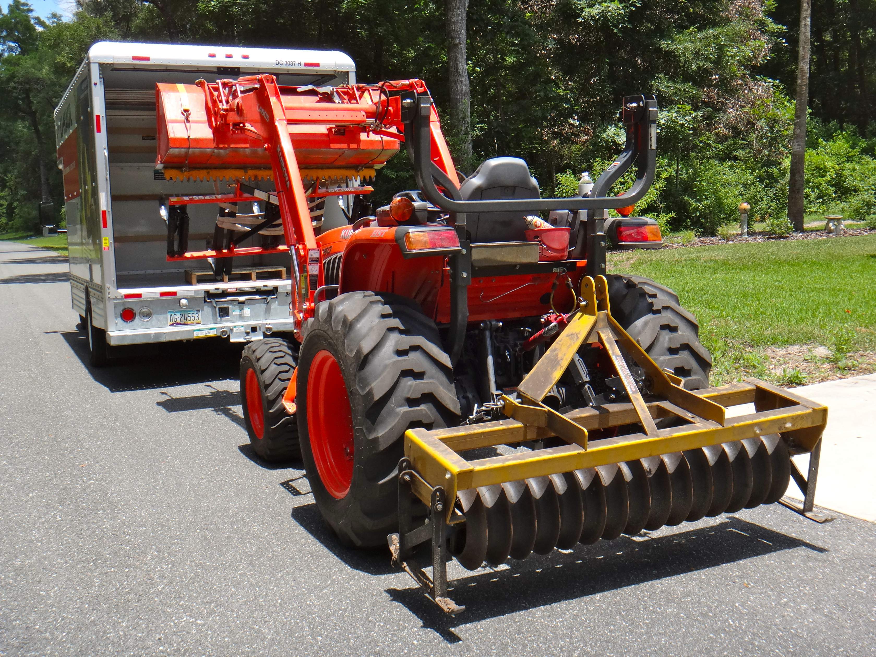

The difficulty for a tractor newbie is evaluating implements on an apples to apples basis. "Looks" may deceive.
You should evaluate implements by weight first, then secondary attributes, price third. Examples of secondary attributes: width, ease of adjustment and range of adjustment.
Most of Deere's 'Frontier' implements are made by other manufactures, painted Deere green. Deere selects high quality suppliers that have been in business a long time. Only Deere knows how much Deere takes as a premium.
See what implements are interesting at Deere, then solicit alternatives here, supplying precise Deere model numbers. Good advice from a dealer can be worth a lot.
Many on T-B-N, including me, feel everytfhingattachments.com is the leader in direct sales: Tractor Attachments And Skid Steer Attachments For Any Tractor Or Skid Steer Rick and Travis have provided valuable input to me.
For branded implements I have patronized Iowa Farm Equipment several times: Iowa Farm Equipment
I remain amazed that I can unload almost any tractor implement three days after I order, in rural Florida.
