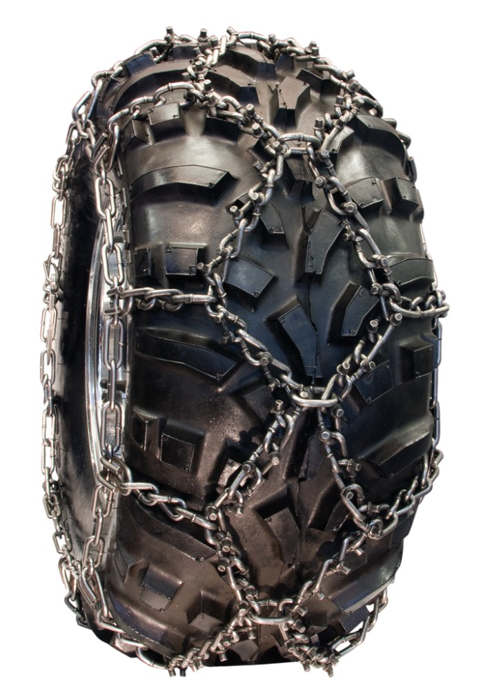

   / Need Tire Chain Tensioners for Kubota BX2660 #10
Then he needs the ATV style with studs, as long as the side chain come half to 2/3's of the way down the sidewalls if the chains are hooked up for an equal length on both the inside and outside they will not walk off. Chains that are too narrow and do not come down the sidewalls enough can and if connected unequally will walk off..
This would be a good style chain but they are too narrow and do not go down far enough on the sidewalls in this picture.
