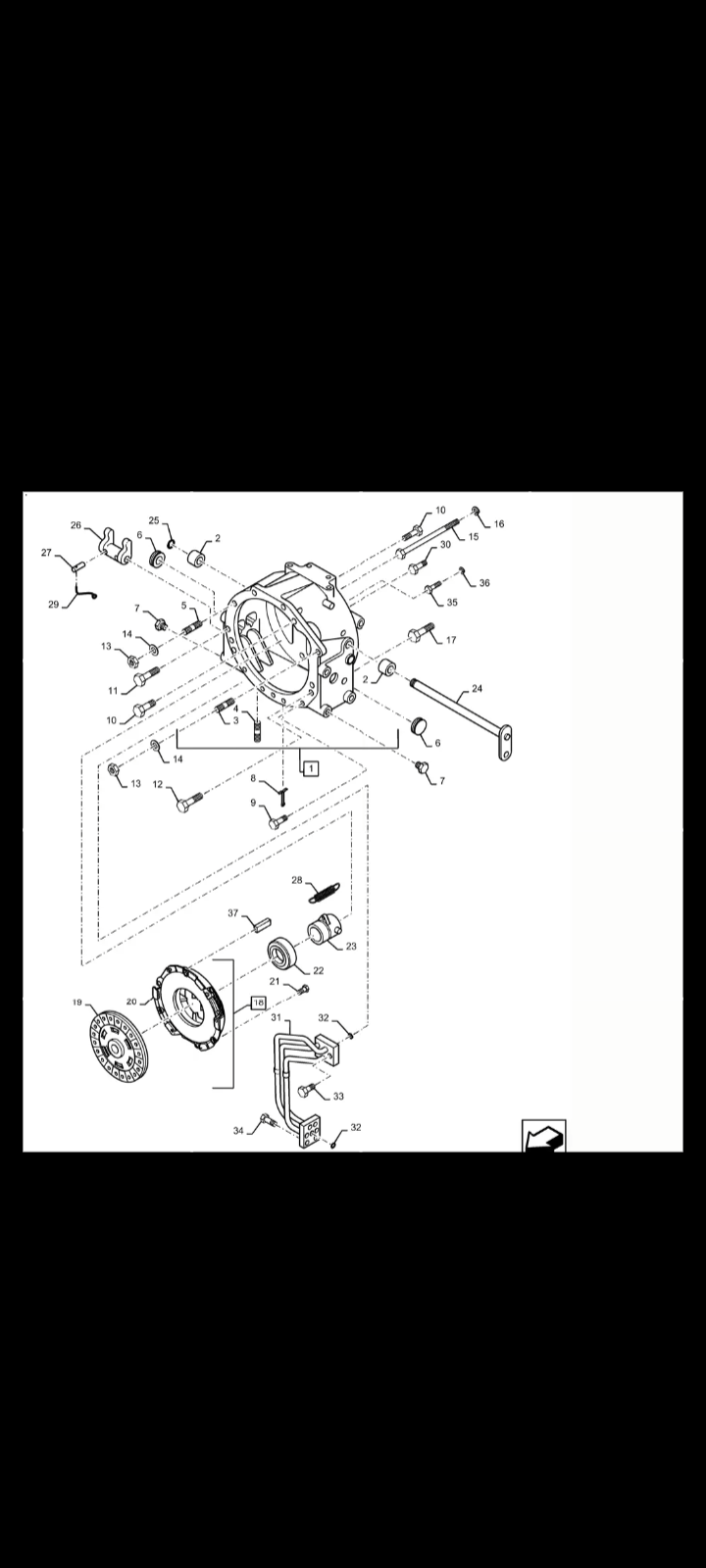

Hey y'all - New member here. I just picked up a 1991 Ford 2120 HSS 4x4 loader backhoe at a very good price knowing it needed some work.
One of the issues I'm figuring out is that the clutch pedal is "non-operational". The tractor moves forward and backwards with the shuttle, and I can move through 1-4 gears on the right side of the steering wheel.
The clutch pedal itself HAD excessive play, and I've since adjusted that to around 1" of freeplay. Once the pedal gets to that point, it is rock solid. No movement downward at all aside from what I expect is slight flexing of the pedal shaft and linkage.
I've glanced inside the inspection port and dont see anything moving.
Does this sound like a throwout bearing that's stuck on the input shaft...clutch disc that siezed to the flywheel...or something else?
I've done a bit of searching and haven't found a thread discussing a similar issue.
Thanks for any guidance.
