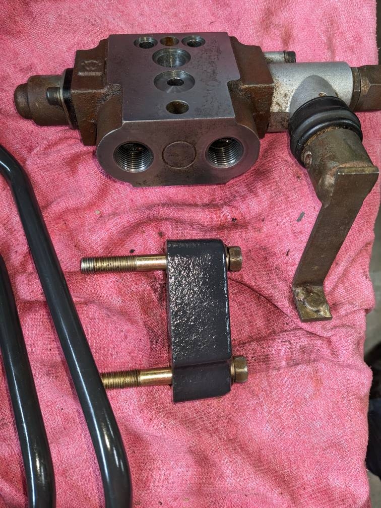

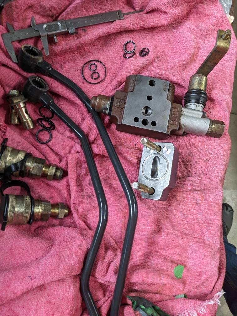

I am slow to reply.., adding a rear remote or two is very straight forward for an avid DIYer. I just replaced a leaking O-Ring in mine - first time working with hydraulics! I blame the dealer for selecting the wrong O-ring 7 years ago when it was first installed , so yes, you should be able to do a better job than some dealers. Here are all the parts laid out. Contact me with questions.
   / New DK4720SE add-on's? Are they DIY friendly? #9
How much more difficult would it be (in your opinion) with a cab unit?
Hydraulics are one thing I have never worked on. But of course am willing to learn!!!
Someday, I'd like to get a rear blade with hydraulic options, like rotation, tilt, and offset. So, I would need I guess at least 3 remotes for that function. Are 2nd,3rd, and 4th rear remotes easy to add? I'll have do do some research on how to add rear remotes to a tractor. I just don't understand the mechanics of it yet.
