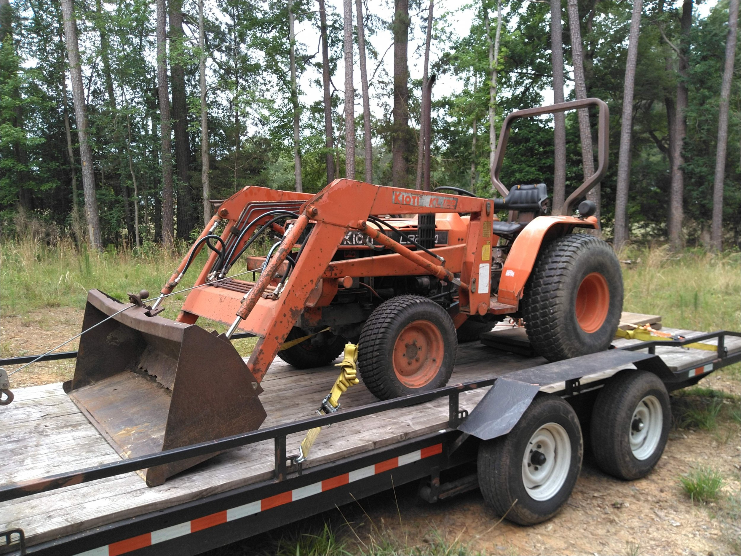

Hey everybody. I just became the proud new owner of an LB2204. Tractor seems to be in overall serviceable condition. It goes through all the gears, hi and lo ranges, 3-point lift works, PTO works at both speeds, and there's a pin missing in the 4wd linkage, but everything looks good there. Hydraulics are a little tired, but for now they'll do what I need. The engine is on its last leg though. Massive blowby with smoke visible out the vent tube and sounds like it may be down a cylinder. I'm fairly new to diesel engines (my first was a 7.3 IDI 2 years ago that I have since sold), so they all sound like they're going to throw a rod to me, but this one seems to have an especially loud clack to it, so I'm a little worried the crank might be toast from a spun rod bearing/knock. Could be top end noise I'm not sure. I found the following thread, but it's been dead so long, wanted to start a new thread about this.

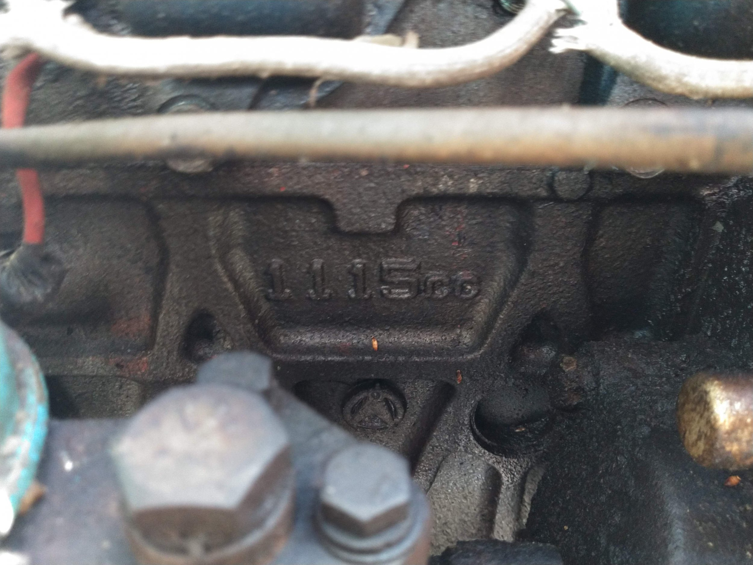

Even more confusing about all of this is that the DH1101-b is the same exact part number as a Kubota engine from the same era. I even found a thread on another forum about a Kubota engine of the same model number that even had the same 1115cc cast into the side like mine (see pic). Was Dae Dong rebadging the Kubota engine or did they just manufacture the same engine in house using the Kubota design? It seems like they're pretty darn close to identical, maybe even the same castings.

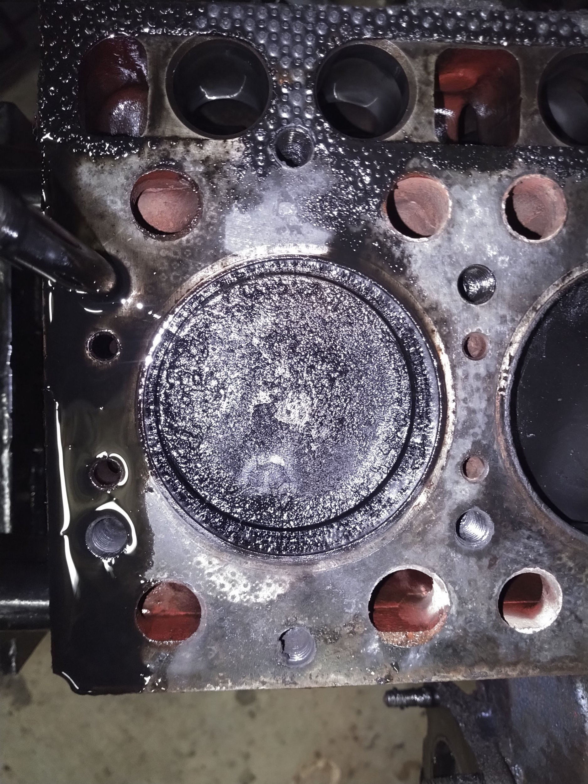

So I got quite a bit further on this over the last few days and other than the fact that I had to do all this work, I'm feeling really good about this engine now. I may even be able to get away with just a cylinder hone and some new rings. Got started tearing the engine down and it's got the head and oil pan off now. I took a look at the condition of the cylinder walls themselves and the connecting rod big ends.
For the cylinder walls, even though the crosshatch is gone on all the cylinders, I can't see any visible vertical scoring. There's a decent ridge at the tops of each cylinder (much of which may be carbon), but they seem like they're in great shape considering all the blow by this engine had. As far as the big end of the rod goes, no signs of heat and no play in the rods on their crank journals.
Also, I mentioned earlier that cylinder #2 was making a wheezing noise as it came up to TDC on the compression stroke. I thought that was either rings or valves. Turns out it was just the injector. Like a lot of stuff on this machine, the injector on that cylinder wasn't tightened down properly and air was actually leaking past. I discovered this when I took the injector lines off. I dribbled some oil in there to check if the looseness was causing the noise, and sure enough, bubbles when I cranked it over.
In keeping with the theme of deferred maintenance, the oil pan is filled with gobs of sludge and the pickup tube screen has some gunk in it. Looks like no one changed the oil for a few hundred hours. I'm not so sure on my air filter assessment from earlier now. That #3 cylinder was so bad that the intake and exhaust ports (especially the exhaust) were caked with carbon build up. That may be the substance I found in the intake tube. The lack of oil changes may be what took out the rings. Who knows, maybe a combination of the two.
Tomorrow I'll be pulling out the rods and checking the cylinders for roundness and taper. I'm also going to inspect the pistons themselves, although I'm thinking they'll look good considering the condition of the cylinder walls.
Last but not least, I've been watching a lot of teardown videos of Kubota engines since there are none of the DaeDong engines. If this isn't in fact built by Kubota, it's a very very close copy. It's the exact same design Kubota uses. It doesn't just look the same outside. The internals look the same as well. As soon as I get done with my inspection and figure out what I need to buy, I'm going to source parts for the Kubota DH1101.
I'll attach a few pictures for your viewing pleasure.

   / New Owner of a Kioti LB2204
Well I guess this settles the debate on whether I'll need new pistons. I'm absolutely blown away by how little damage there is to that cylinder wall considering the condition of this piston. The piston itself has a big chunk out of it, both compression rings were in pieces and that big chunk of aluminum was nowhere to be found, so it must have just been ground to pieces by the tumbling chunks of ring. Some of the little tiny pieces of piston ring were embedded in what's left of the ring lands. I don't know what collapsed these ring lands but my favorite theory is that someone overdid it with ether and hydrolocked it. The pistons come up so high on these engines that if the gasket wasn't in there it would hit the head. I got a better look at the cylinder walls and they all have very light scoring on them, but nothing crazy. They're also just out of spec at the top end of the cylinder and they are slightly oval shaped. The stock sized piston spec is 1.9921" and the measurements were anywhere from 1.9927" all the way up to 1.9973" (measured with a Mitutoyo micrometer and a Lufkin snap gauge). The spec on an oversize piston for this is 0.5 mm which works out to 3.0118" so the machine shop can take quite a bit of material out to clean up the existing damage. Hopefully that gives him enough room to clean it up.
The rod journals on the crank look really good and the bearings themselves have the merest whiff of scoring where the oil feed hole is, so I'll likely be able to go with stock size bearings. At this point everything's out of the engine but the crank, which I'll probably do tomorrow. On these you have to take it off the stand because the crank comes out the back of the engine. Overall I'm pretty happy with what I have to work with. Next thing I need to do is find a local machine shop. Anyone know of a good automotive machine shop in the Raleigh area?
