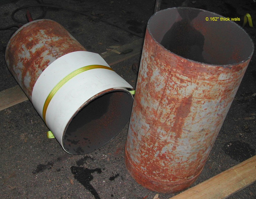

For several reasons I will go with the steel tank.
Original steel tank lasted about 18 years. No problem with rust in water.
Was hoping someone had drilled or cut 1 up. Mainly want to know how thick the metal is.
Thanks to all for your replies.
Jim
   / New PROPANE TANK 4 Water Storage ???? - Welding progect #24
I have cut a few, but nothing that big. The one I converted to diesel storage had 0.162" walls.
Note that propane tanks can be made in DOT or ASME versions, or at least my 125-gal tank
I bought new was (420#). One is thicker than the other.
Thanks for the info & picture. Much appreciated.
Jim
