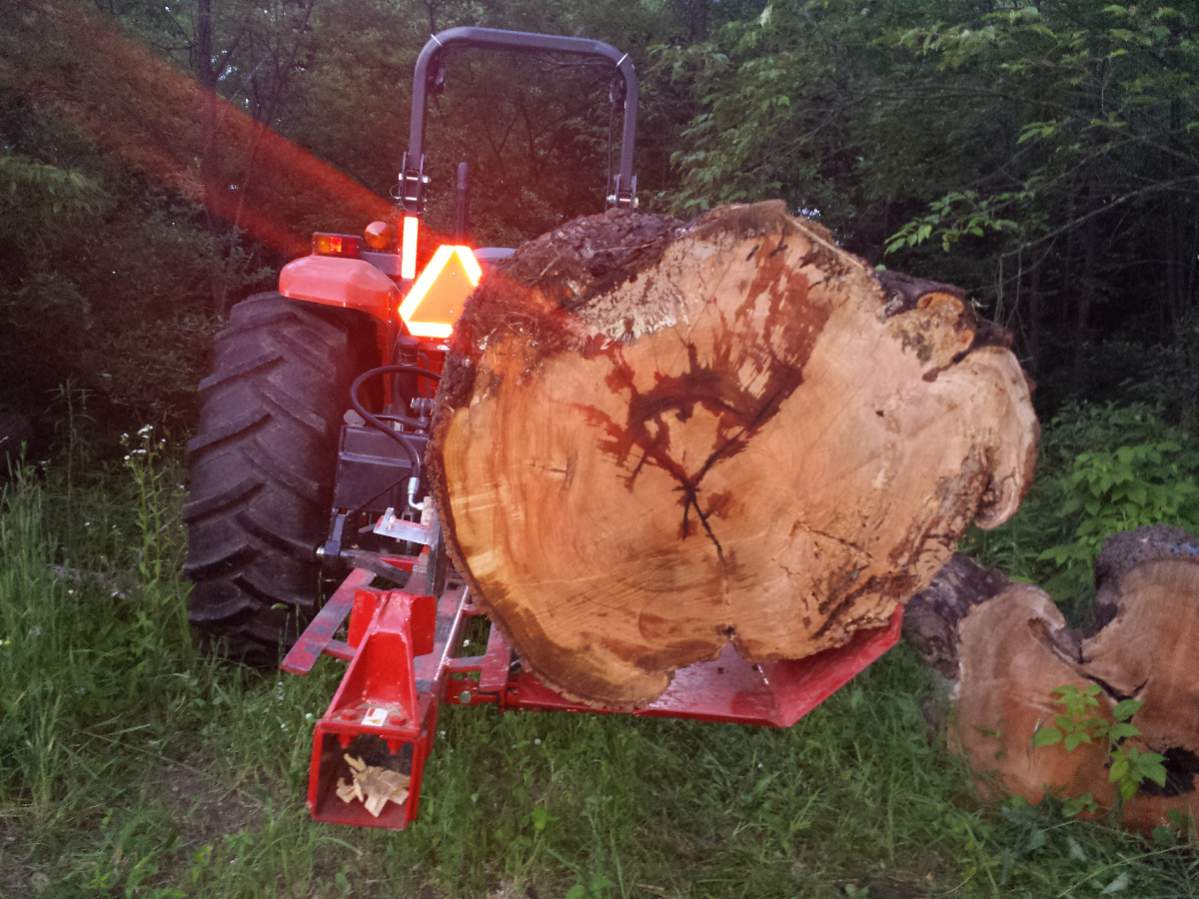

Spent just under 4 hours splitting wood today the pile shown here took 2 hours 10 minutes mostly ash 8 -16" diameter
Then we moved to our next stack of wood
Some descent sized oak that blew over in the spring this is when the fun started.
70 some feet of tree ranging from 32" - 20 diameter. Needless to say the log lift was worth the cost its a great way to lift 200 + lb logs and then you have a table to put the big pieces while you knock them down into manageable sized ones. Having used several spliters where the wedge is fixed i definitely appreciate having the wedge being driven on this big stuff.
For reference the wedge is 9.5" tall.
Not all the pieces split this well some of the oak had really twisted grain with knots and required working from an edge

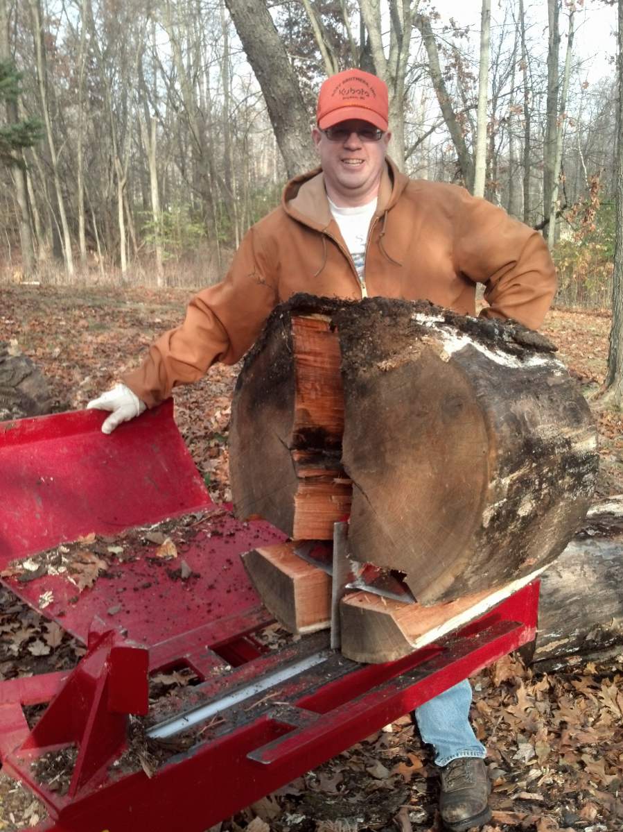

I can usually split anything I through at it thats 22-24 inch diameter or less without any trouble at all. As in split the logs in half. I have never used anything other than the 4 way wedge. Occasionally I have to use the forward stroke if its knotty for the first split in the larger size range mentioned.
I can split really big stuff with realtive ease and a strategy
The stump piece of cherry in this picture was over 36" on the large axis and close to 30" the other. The grain was very twisted due to the fact tree split into 4 shoots. I just worked it from a corner taking big chunks off untill it was all split down Into manageable sizes. I could not split it in half at first. The biggest problem with hunks this size is the fact that the rounds weigh 400 - 500 lbs. The lift has no problem lifting them.
My rear hydraulic outlets relief is set a little over 2900 psi. I have no regrets about the smaller model it will split anything I have and is much faster than the larger cylinder model. I'm only generating 14 tons of force on the push stroke. Which splitfire claims is equivalent to 22 tons on a conventional splitter due to their unique design and reduced friction
The pull stroke has much less force available but will normally split straight grained knot free 20 plus inch without incident
How much hydraulic pressure do you have available or are you going to go gas if you go the gas route special order the 9hp model and high flow hydraulics. You'll end up with a stroke time of between 4-5 seconds each way
Also if you plan on spliting longer than 16" order a longer model. The 24" model is 33" between the wedges meaning I can fit two 16" pieces on the spliter. Usually I never have reverse stroke to clear the split wood
