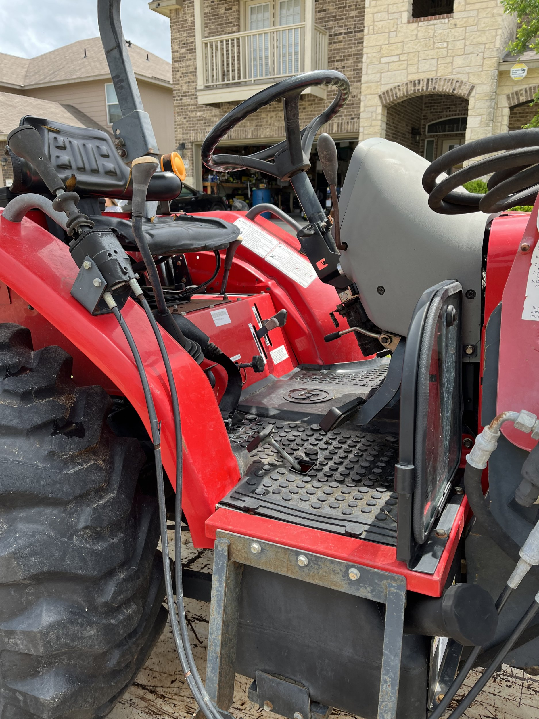

Hello All,
I just picked up this tractor a few weeks ago for $4,000. parked it and have since been going through it. I was shocked to see a century brand hydraulic filter still on it! I have been using this site a lot to help find cross reference filters and fluids, So thanks a lot for that!
Things done so far:

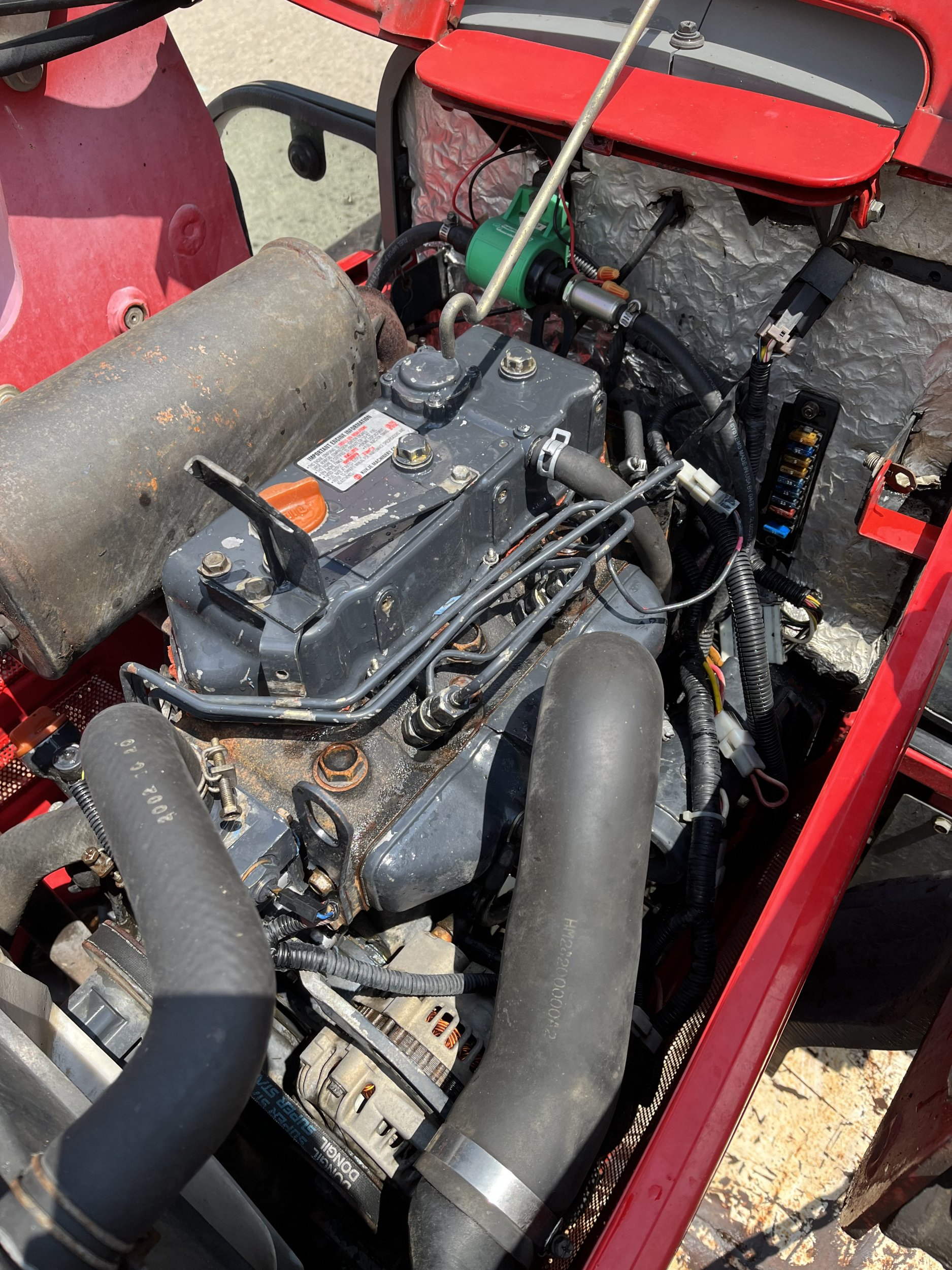

-changed all fluids and filter. (the WIX hydraulic filter 51202 doesn't seem to fit right, leaks a little at the bottom and was hard to seat all the way. I think I am going to have to try a Napa one.)
-changed water pump gasket due to leak.
-new belt
-new coolant because of gasket.
-new glow plugs
-left side loader hydraulic lift cylinder leaking so got it rebuilt.
-new air filter
To Do:
-Left side tank is leaking diesel at seam. previous owner did a patch job but it's failed. have plastic welding kit ready after I run it really low on fuel.
-need to take entire exhaust apart and replace gaskets and retorque.
other than these things, it drives and shifts really smooth. even though it only had about 5 gallons of fluid in the tranny when I drained it. but no whine or weird noises, so that's good.

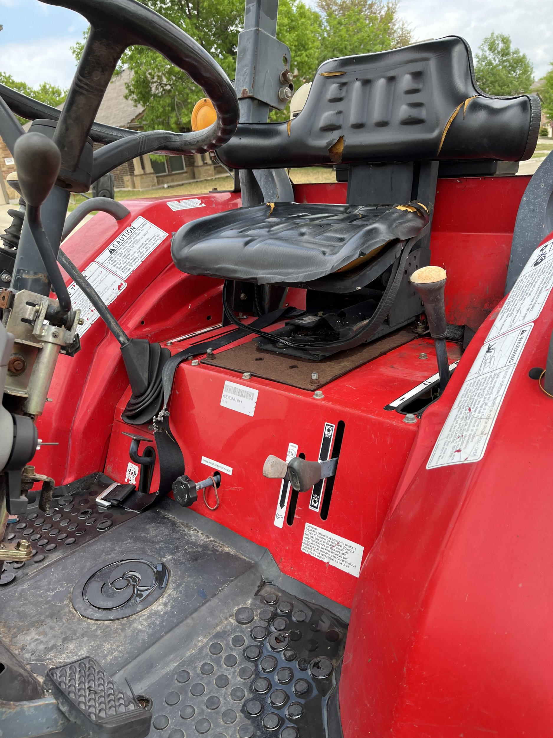

If anyone knows a good/maybe more comfortable seat that would swap right out for the current one do please let me know. one easy to get at tractor supply or the likes. thanks.

Wilkija, I have the 2004 model of the same tractor and loader combo with ag tires. and almost 1700 hours on it. I religiously use the Kukje filters to avoid any issues. Even today the engine uses no oil between changes. Glow plugs, and other misc items do wear out, but it is a tough tractor that has done a lot of work. I do use the 5W-40 T6 Rotella and find the tractor is very smooth running with it, better than the 15w-40. The seat you have is not the original, it looks like a Tractor supply seat. The steel plate is not on the original. The original seat was lousy on mine and the replacement Tractor Supply one is not much better. I think Kukje has installed better seats on the later models. The c-50 loader was made by Humpolec in Chzech republic and is one of the toughest loaders I have ever seen or used. It does have the Euro style quick connect and that is way stronger than a skid steer quick connect. But that limits options for other attachments. At one time adapter plates were made.
At any rate, you have a good solid tractor that should provide years of service. W.Jones

I was surprised to see the loader cylinders use snap rings to hold it all together. New one for me but the seals are seals so easy enough to get sourced and changed. One problem i have is they ran the loader hydraulic supply right behind the exhaust in the little opening at the bottom. It has a small rub/melt spot on the line. Im shocked after almost 20 years it hasn’t burned through. Gonna cut the hole wider and put some heat wrap on that part of exhaust. Is yours routed that way too? Kinda hard to see but the black hose in the circled area photo.

will do! I was hoping to find a spring or strut dampened seat for it but haven’t really looked yet.
