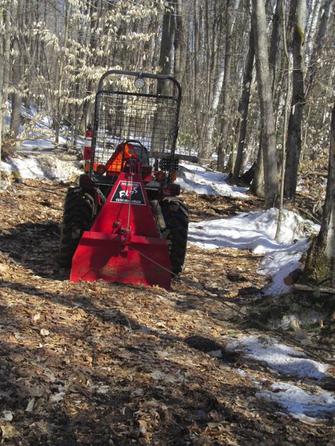

Nice winch". Next toy....er tool you need is a Snatch Block, preferably a self releasing one to make it around stumps or rocks.
I have the Farmi JL290 and can't believe what it will pull. Just be sure to watch the log the whole way in because when things go bad, they happen faster than you think they can.

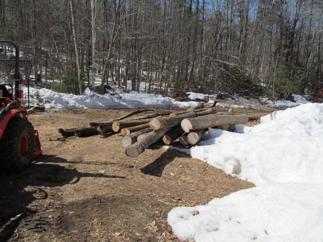

Very nice heavy looking winch. You are right - It is amazing what you can pull. You will like it more and more as time goes by and you have more work time on it. I have had mine for about 11 years now. Your tractor and wnich are about the same size as mine. I started, like you. with just the winch. Then started adding stuff. This is what my set up looks like now. My tractor is 30 hp and weighs about 5000 lbs and the winch pulls 6400 lbs.
Post some working photos when you get a chance. Have fun and work safe.

Nice setup, Craig. You'll find a snatch block really helps, but even so, try to make your pulls as straight off the back as possible. If you're off to a side angle and you get a snag, you can flip the tractor pretty quickly.

You are right. The load of spruce/fir in the picture is going to a saw mill that buys my softwood saw logs. Any hardwood I cut is firewood. Small scale logging is my favorite activity. I try to improve the quality of my woods and help pay the taxes. Those nice logs came from some trees that were to old and had started to stump rot. I have to cut the bottom log until I find good wood. Like this one. I lost about 6 feet off it as you can see.
