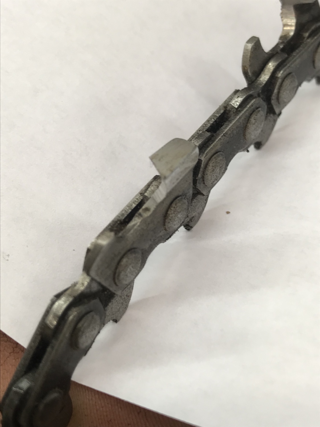

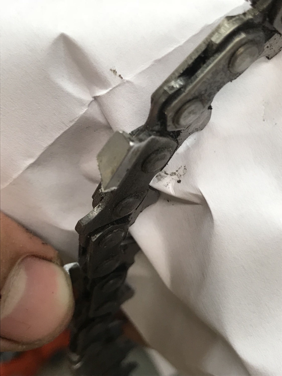

I bought an Oregon chainsaw sharpener and even paid good money for a CBN wheel that’s supposed to eliminate this. Some teeth it does a pretty decent job although not as good as new. On other teeth it leaves a bad burr. I’ve got the head set at 60 degrease and the table angled at 30 degrease. IMG_0435.JPGIMG_0436.JPGIMG_0437.JPGIMG_0438.JPG

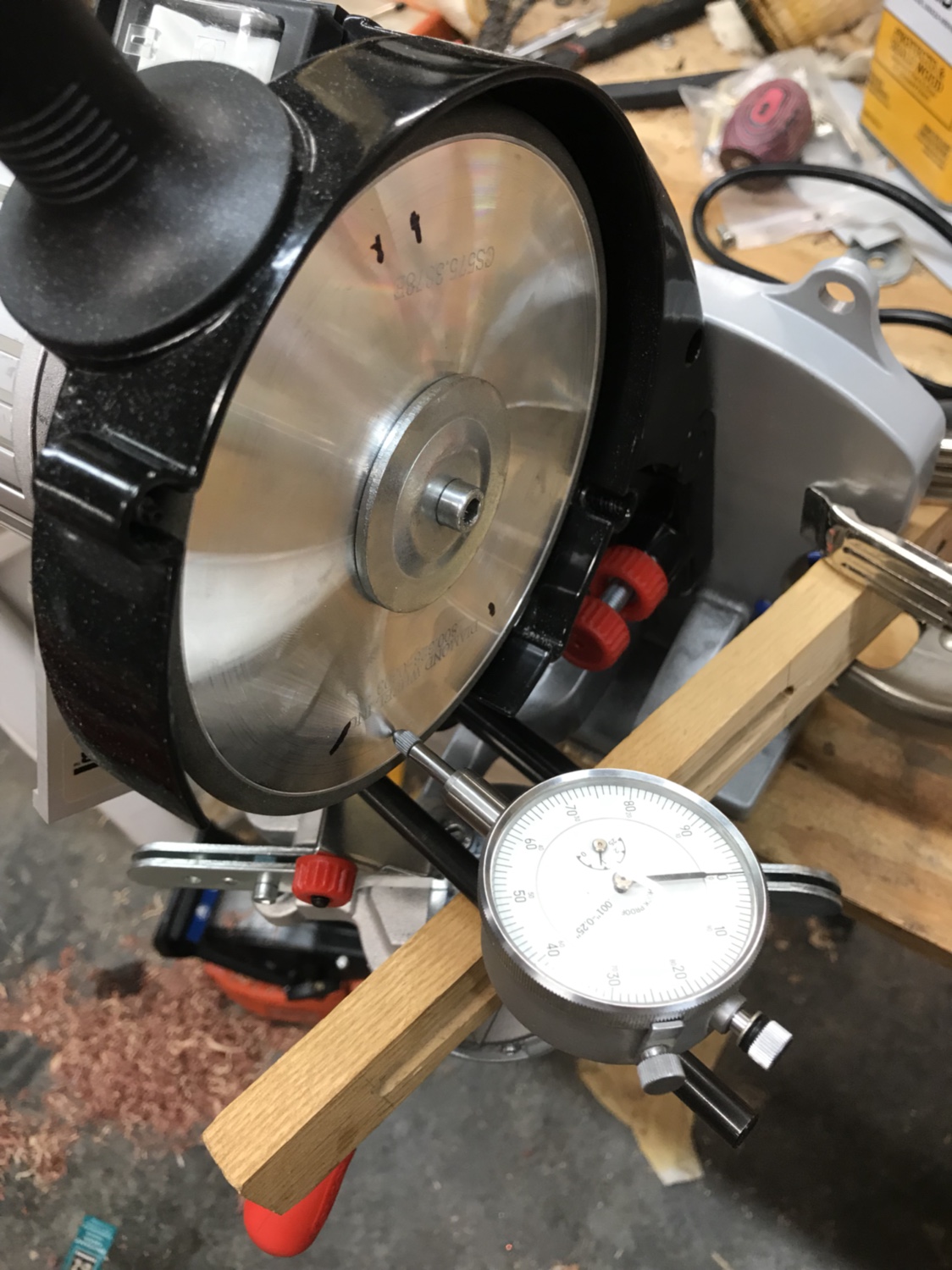

I’ve since tried again with a never sharpened before, but dull chain and had better results although still not as good as I was hoping for. One problem that I’m not real thrilled about is the wheel has some runout. As in enough that when you hold a piece of metal to it lightly it bounces. I haven’t had time to check to see if it’s coming from the motor or the wheel. I checked the motor shaft and it seemed pretty good. I guess I should get my dial indicator out and mark the high spot and rotate the wheel on the shaft and try again.

If I am guessing correctly, both right and left teeth are ground from the same side of the chain??
If so, one tooth will have a "burr", the other will not,, due to grinding into versus away from the tooth,,,
That is just metalworking,,,
My guess is that the burr is meaningless,, try the chain, if it cuts straight,, all is good,,,

I haven’t had a chance to cut with the chain yet. I have determined it’s the arbor causing the runout. I tried filling it with it running but that didn’t make any difference. I’m going to try shimming it. It’s 11 thousandth of runout measured like this.IMG_0452.JPG

I haven’t had a chance to cut with the chain yet. I have determined it’s the arbor causing the runout. I tried filling it with it running but that didn’t make any difference. I’m going to try shimming it. It’s 11 thousandth of runout measured like this.View attachment 577933
Call Oregon if the arbor is bad.
I think bad would be a stretch. It’s within a couple thousands. How much can you expect from a $170 unit? I installed a shim and got it to about 5 thousands run out at the outside of the wheel.
