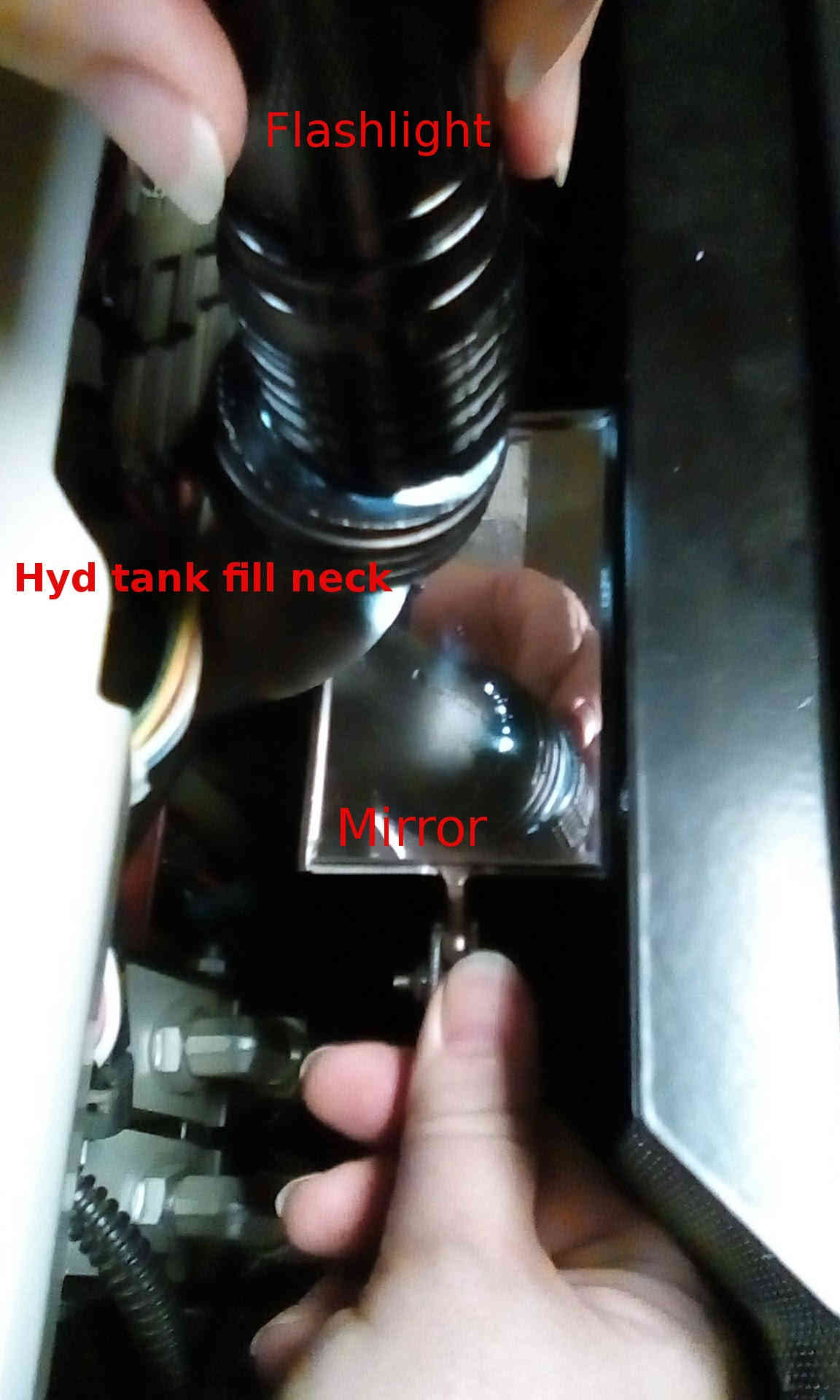

In 2017 I found a problem with my tank as seen in this picture. Its sort of hard to make out but shining a flashlight down the filler neck with a mirror underneath is showing holes in the tank. Ventrac replaced it for me under warranty. It might be worth noting that the tank with the holes in it was made of black plastic and the replacement was a white plastic, so they may have changed plastic types.
To be clear, I'm suggesting that it might be a defective tank.

Thanks MountainBuck for the info and the pic. I'll take a look with a mirror like you suggested. It kinda looks to me like there should be a rubber washer or something between the bottom of the tank and the large nut that holds the fitting to the tank. I don't see a washer and that's where it's leaking but the parts diagram just shows the tank as an assembly so that doesn't clear anything up.
My machine is a little newer and it has the white plastic tank. I just downloaded the latest parts manual it now shows there are two tanks available and one of them is steel. I wonder if this has been a recurring problem with the plastic tanks. Unfortunately it's out of warranty and I'm reluctant to dig into this tangled jumble of stuff to get to the tank myself. If the steel tank fits my machine that's the way I'll go - looks like the labor to get to the tank will be a lot more than the cost of the tank. It will be interesting to see if there are holes in the tank like you experienced or something with the fitting.
